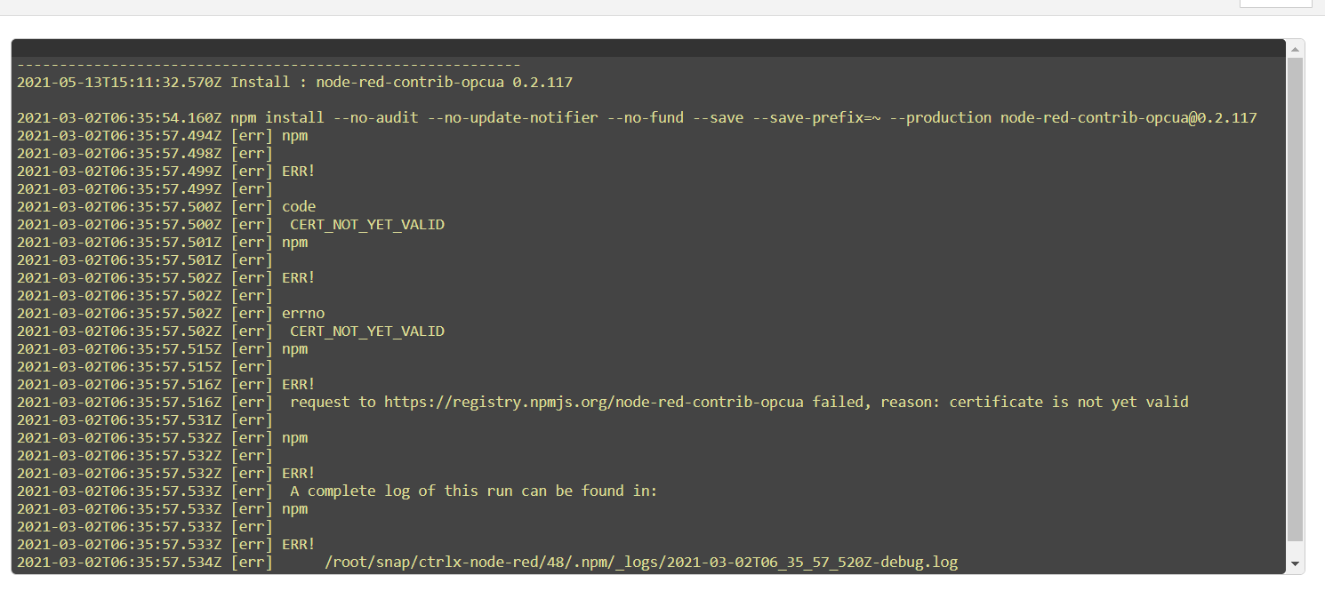

I'm trying to download external nodes in the Node-red wizard (palette), but it pops-up an error and it is not possible to install any palette.
I attached pictures.
Any idea why is this happening?

Hi David,
your log file seems to indicate, that there is a deviation between the server time and the system time set on your device.
Can you please make sure, that the system time of the ctrlX CORE is set correct. You can reach the time settings in the sidebar under "Settings" on the lower left side of the ctrlX landing page.
