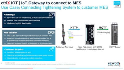

Im testing connection of Nexo to ctrlX core as the concept using http protocol below.

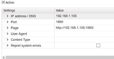

In the Nexo tightening web.
I activated http protocol.
At my PC (installed Node-red for testing only) using http in & http response to get the feedback.
first thing I just create a http server in node-red to listen data package from Nexo. But it didnt work, have you ever tried this connection before and could share it with me?
