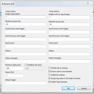

Winstudio settings
Communication - UPCUA - Serverconfiguration - Advanced

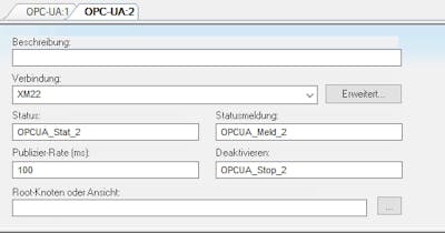

Setting of Driversheets

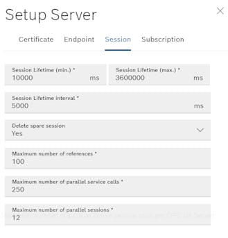

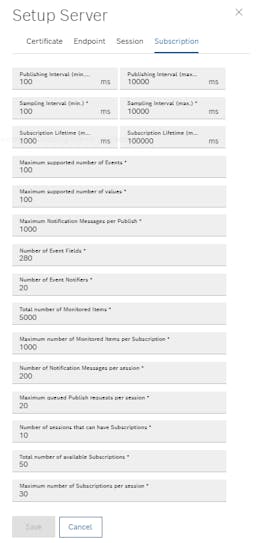

OPC server app 1.20 settings
CPULoad on core2 (Where the server runs) 70-80%.
In lack of knowledge how OPC-UA works i need help with these settings to accoplish a good communication between HMI and PLC. Especially Server settings.
