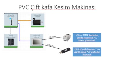

It is necessary to send a command to the printer via PLC and read data from the USB containing the *.csv file.
Is this possible according to the following topology?
So, can we do this using the USB ports on the HMI(WR2110)?
please take a look topology file...

you can write your own application, compile it into an apk file and install it on the webpanels. At this point, the WebPanel works like a tablet/smartphone.
