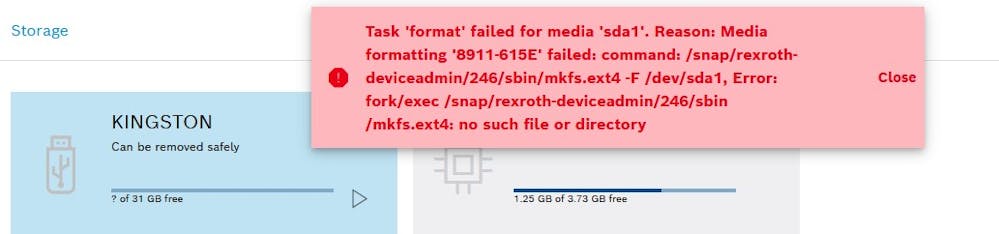

I tried to format a new USB memory, but failed:

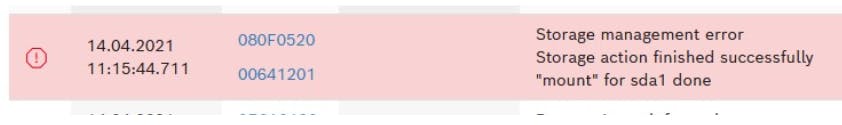

After formating it on an external linux machine and several reboots I got it mounted, but with error:

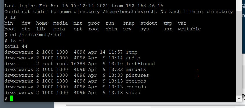

As user admin I have full access on the storage:
But, Node-red has no permissions at all to acces the storage anymore:
"failed to write to file: Error: EACCES: permission denied, open '/media/mnt/sda1/recipes/recipe3.csv'"

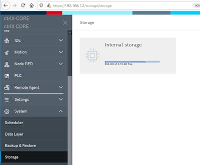

Our internal storage is a 4Gb eMMC chip. At the moment only the size of a snap itself is limited to 250 Mb but not the storage used of it. Please beware of the limited write cycle lifetime of this chip.
You can have a look at the values mentioned by you for CPU and RAM utilisation and also the total storage (https://192.168.1.2/storage/storage). We recommened to keep at least 200Mb of free disc space for normal operation: 
