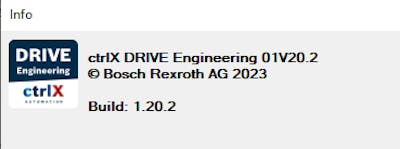

Versions used
  • ctrlX DRIVE Engineering version 01V20.2
  • Runtime / Firmware version of drive AXS-V0308.03
A connection to the ctrlX DRIVE has been successfully established, the device is correctly wired and 24 V are successfully put on. As well the engineering tool ctrlX DRIVE Engineering has been started.

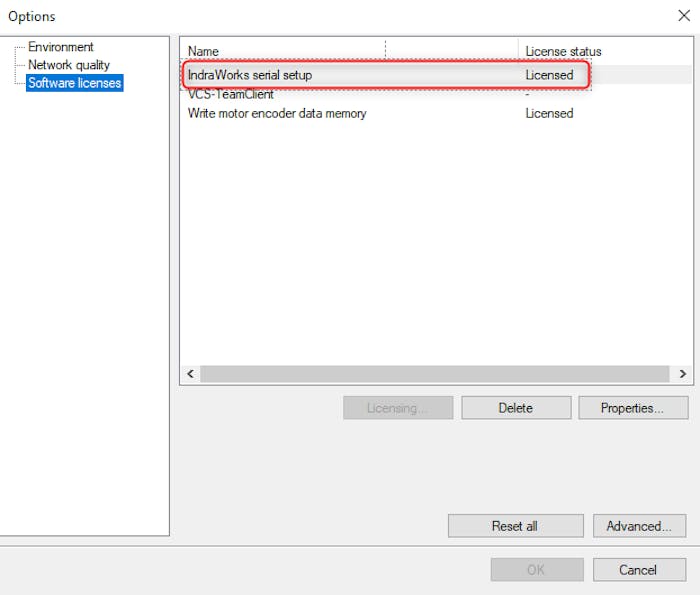

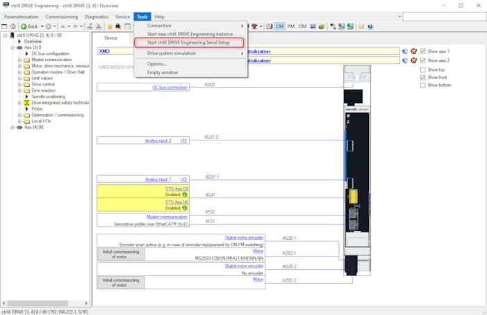

The activation of the software is done by a license key.
Call up in main menu “Tools -> Options”!
Fig. 4.: Call up Tools in Main Menue
Check if the license is activated (if you don’t have a license key please contact your responsible sales contact)!

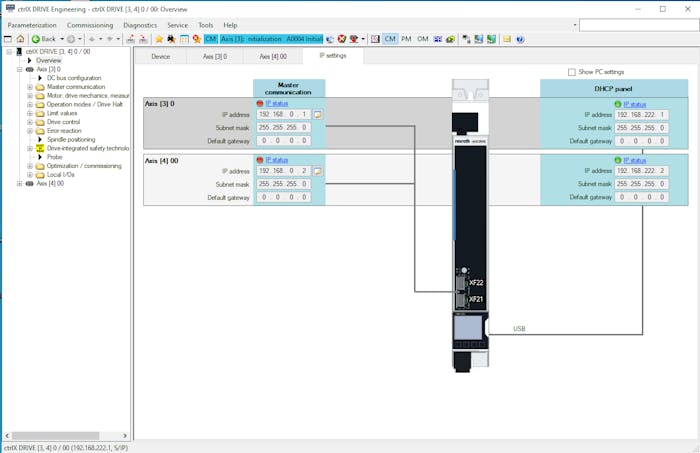

Establish the connection to the drive(s) via:
  • Panel (connection to only one drive possible)
  • EtherNet to more than one drive
Fig. 6.: Setup Connection

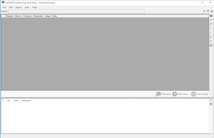

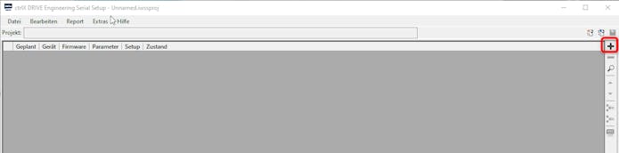

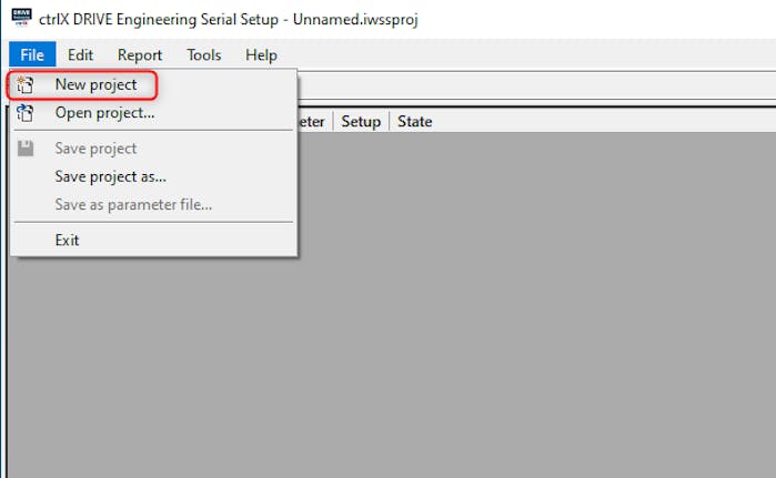

Start creating a new project
Create a new project!
Fig. 7.: Create A New Project

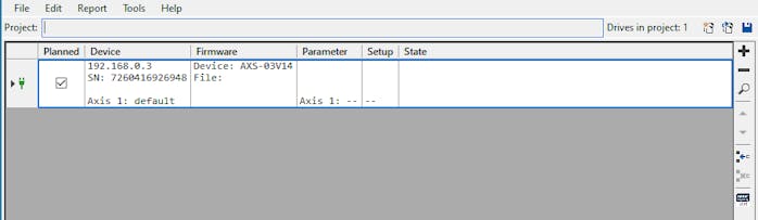

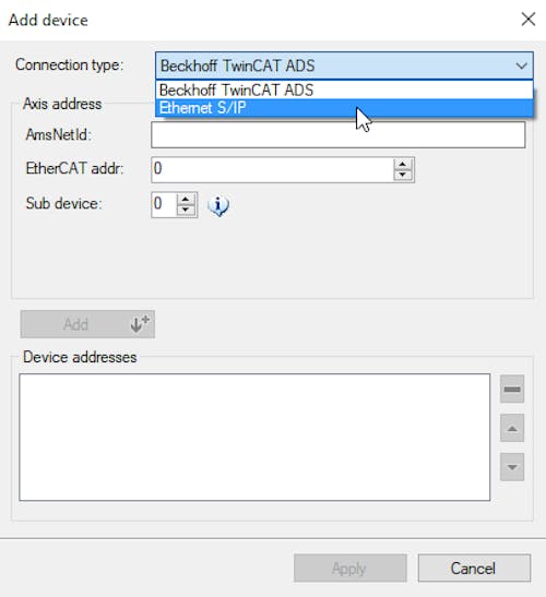

Add drive(s) to the project with the + button (highlighted on the right side)
Fig. 8.: Add Drive(s) to Project

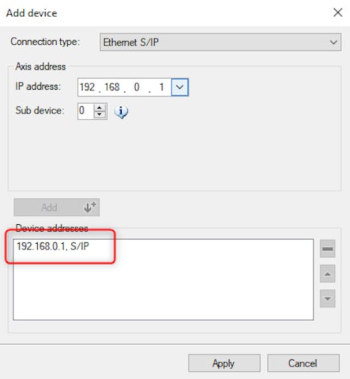

Fig. 9.: Select Communication Route
Fig. 10.: Set IP Address

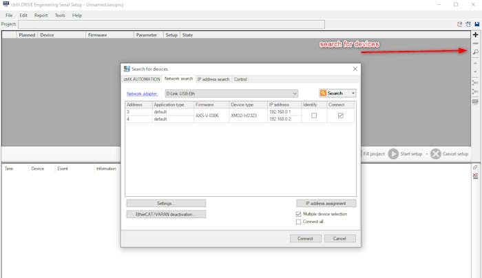

Search for drives with the button on the right side!
Fig. 11.: Search for Drives
Fig. 12.: Connection

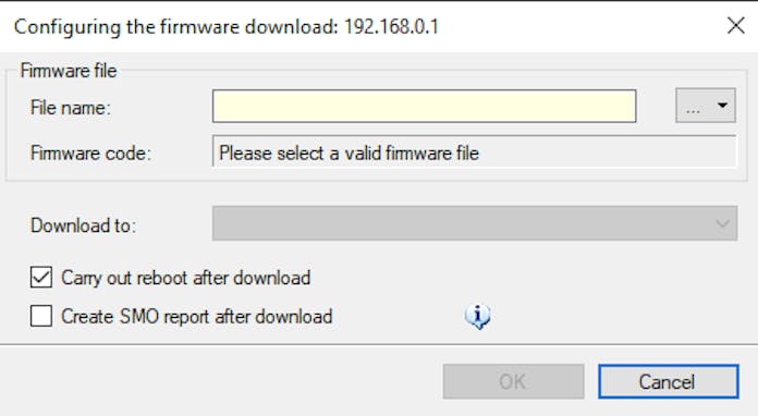

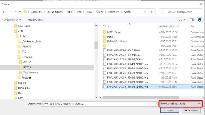

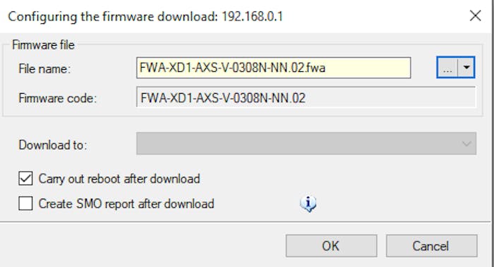

By double click with left mouse on window “Device: File:” a new tab will open to configure and select the firmware to be downloaded, if needed.
Fig. 13.: Configure Firmware Download, if needed
  • Here you can choose a firmware file you want to download for Serial Setup.
Note: The “Reboot” command is only available with AXS-V-0308 or higher!
Fig. 14.: Firmware File Selection
Be sure you select the proper fwa extension!
Fig. 15.: Configure Firmware File

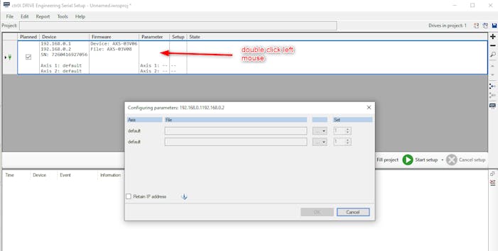

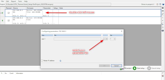

  • Select a parameter file for download to the axis, by clicking on the marked window in the screenshot.
Fig. 16.: Select Parameter File for Single Axis
Fig. 17.: Select Parameter Files for Double Axis

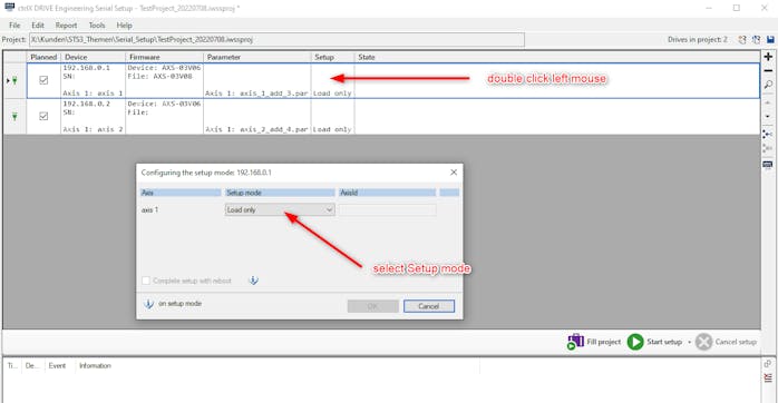

Setting the Setup mode by clicking in the window marked in the screenshot
Fig. 18.: Select Setup Mode
  • “Load only” downloads only selected parameter file(s)
  • “Standard” executes a Load defaults procedure without SMO parameters

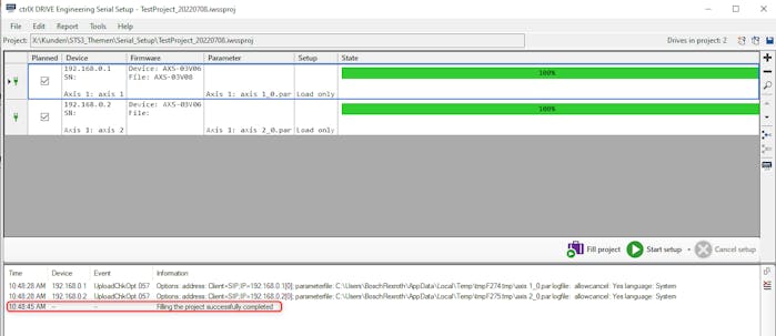

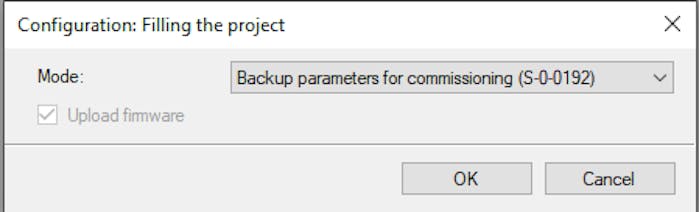

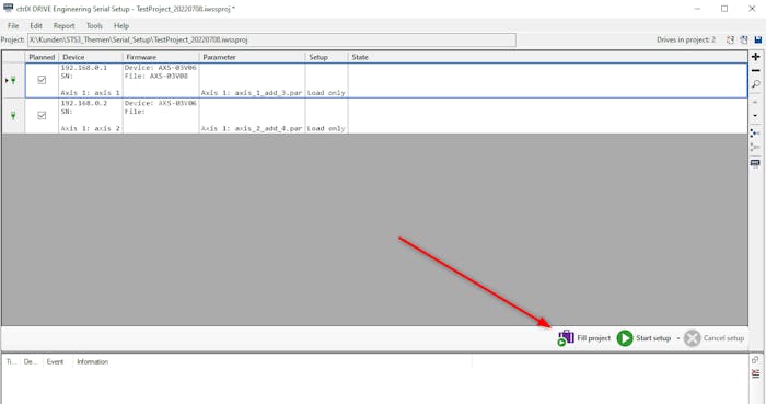

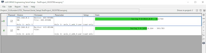

Generate the project with the button “Fill project”!
Fig. 19.: Fill Project
  •  This will start an automatic procedure (saving the actual parameter files from the connected drives) for generating an project that can be executed for start up of drives
Fig. 20.: Save Actual Parameter Settings
  • You can skip this step if you already have stored and selected parameter files for the axes in the project.
Fig. 21.: Saving Actual Parameter Settings
Fig. 22.: Saved Actual Parameter Settings

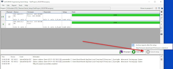

Use the created project for a Serial Setup procedure (including firmware update and parameter file download):
  • Using a before generated project file
Fig. 23.: Start Serial Setup Procedure by Selecting Generated Project File

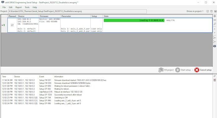

Select the function to “skip firmware download if firmware is identical” by clicking on the small black arrow and start the Setup by clicking on the green button “Start setup”!
Fig. 24.: Start Serial Setup Procedure

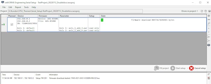

  • Running firmware update
Fig. 25.: Running Firmware Update
  • Be patient and wait for the rebooting of the drive(s)
Fig. 26.: Rebooting of the Drives
  • Parameter file download started

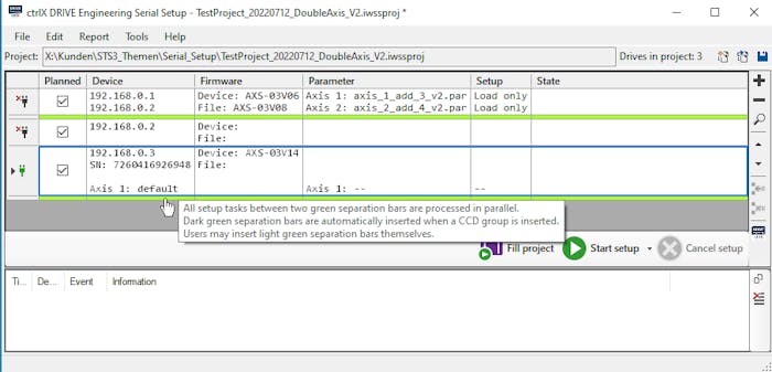

If you are using EoE as engineering connection do not use the separator for executing the operation in parallel (e.g. Firmware download). The bandwith is limited.
In the screenshot the operation between the green lines (separator) will be executed in parallel.
Use Of Separator For Parallel Execution

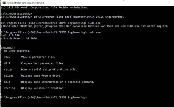

Execute the programm with Windows command prompt:
  1. Open Windows command prompt with admin rights
  2. Change to the correct folder by using command cd followed by the correct folder of iwdc.exe
    - In a standard installation the following folder is used: C:\Program Files (x86)\Rexroth\ctrlX DRIVE Engineering\iwdc.exe
  3. Open/start  IWDC.exe
  4. The screen then looks like the following
Fig. 28.: Command Prompt Method
Type in help to get more information about the available commands
