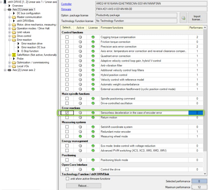

2. Prerequisite for using the “Sensorless deceleration in the case of encoder error” function
In order to activate the function the so-called productivity package must be present. It should normally already be ordered correctly or, if not ordered, be licensed afterwards by “Import license”.
The “Sensorless deceleration in the case of encoder error” function itself then needs to be selected and activated by a “Reboot”.
Fig. 1.: Productivity package with activated function “Sensorless deceleration in the case of encoder error”

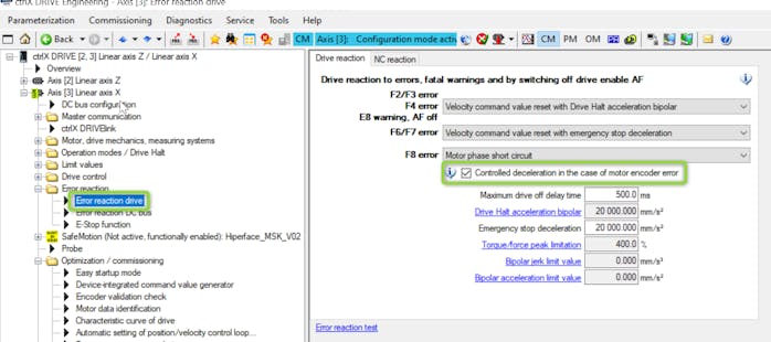

The “Sensorless deceleration in the case of encoder error” is activated by
- setting the check box for the function in case of F8 errors.
Fig. 2.: Configuration for “Sensorless deceleration in the case of encoder error”

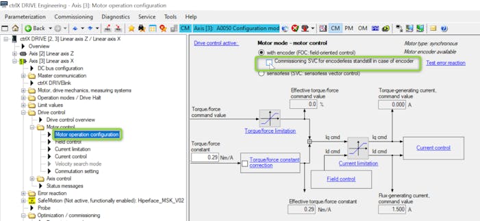

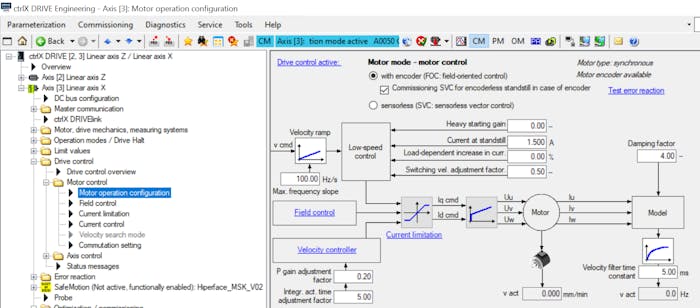

In order to check the parameters and function itself it is recommended to commission the SVC control for encoderless standstill in case of encoder error. Activate the checkbox!
Fig. 3.: Configuration for commissioning “Sensorless deceleration in the case of encoder error”
Now you may access the parameters for the sensorless vector control (SVC).
Fig. 4.: Configuration for commissioning “Sensorless deceleration in the case of encoder error”

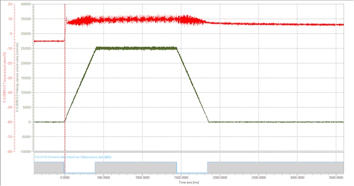

The proper functioning of the SVC control should be checked. In here we got the following behavior.
Fig. 5.: Test of “Sensorless Vector Control” (SVC) in normal condition

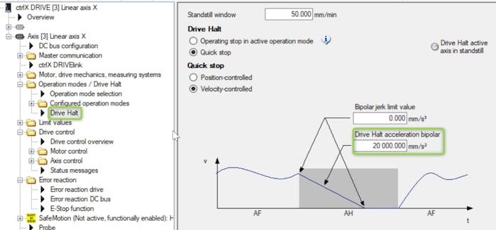

The Drive Halt function should be parameterized according to the needs of the application.
Fig. 6.: Drive Halt settings

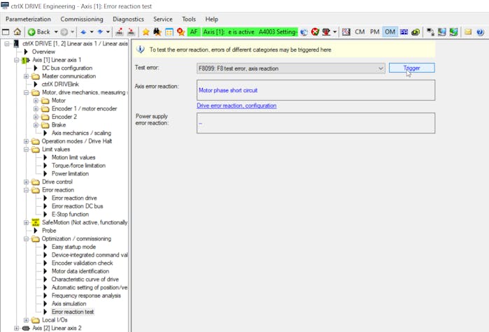

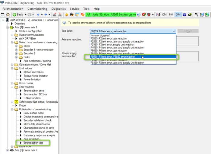

The error reaction may be tested with the help of the “Error reaction test” which allows to set the trigger. In here the “F8098 F8 test error, F8022 error reaction” is selected in the menu.
Fig. 7.: Test of the function “Sensorless deceleration in the case of encoder error”
Now the trigger of the error reaction can be set. Best is to trigger the button if the movement is on full velocity.
Fig. 8.: Trigger the test of the function “Sensorless deceleration in the case of encoder error”

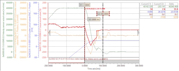

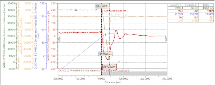

If set properly one may get the following behavior.
Fig. 9.: “Sensorless deceleration in the case of encoder error”
In here in this example moving on speed 40 m/min the distance, the axis is still moving, is 23,47 mm. The deceleration is nearly getting to 16 m/s2 like parameterized as 20 m/s2.

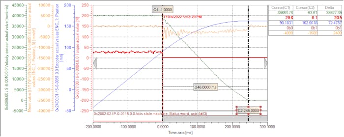

As well if compared to the behavior in F8022 error case (with encoder error) and setting the error reaction “torque disable” the reaction is quite o.k., see:
Fig. 11.: Deceleration in the case of a F8022 error with error reaction “torque disable”
In here in this example moving on speed 40 m/min the distance, the axis is still moving, is 72,48 mm, so nearly 3 times the value of the sensorless deceleration in case of encoder error.
