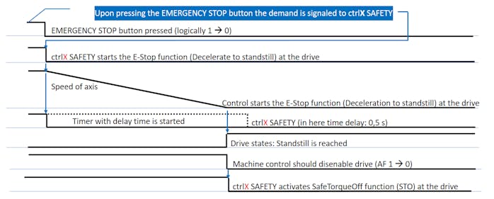

Fig. 1.: Timing diagram with normal behavior at pressing EMERGENCY STOP button (axis is in movement but reaches standstill more quickly than time foreseen)

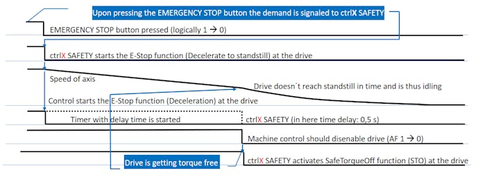

Fig. 2.: Timing diagram with behavior at pressing EMERGENCY STOP button (axis is in movement but doesn´t reach standstill in the time foreseen)
The timing diagram for switching the ModeSelect is exactly the same like as for pressing the EMERGENCY STOP button.

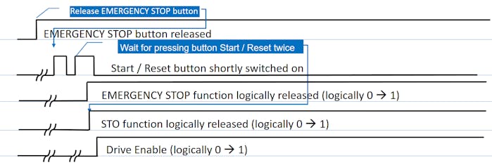

Fig. 3.: Timing diagram after releasing EMERGENCY STOP button

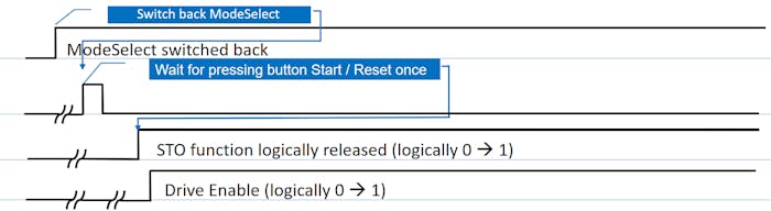

Fig. 4.: Timing diagram after switching ModeSelect back

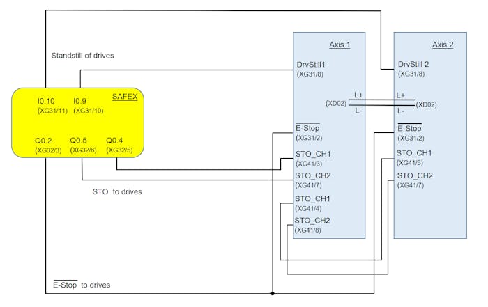

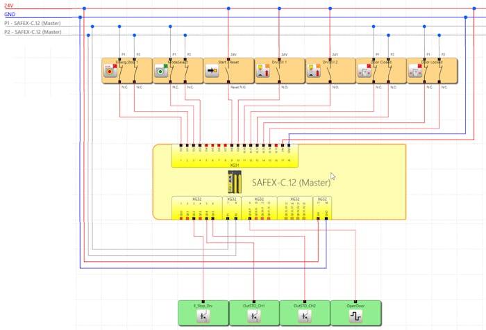

2. Wiring schematics
The SAFEX control´s input devices are:
  • One double channel EMERGENCY STOP button fed by pulsed 24V
  • One double channel Mode Select switch fed by pulsed 24V
  • One single channel reset button fed by non-pulsed 24V
  • Two single channel inputs coming from two ctrlX DRIVE indicating that standstill is achieved
  • Double channel “Door closed” contacts from the safety door
  • Double channel “Door locked” contacts from the safety door
All double channel buttons are fed by pulsed 24V
The output devices are:
  • One single channel output for control of so-called E-Stop function of drives (quick changeover to standstill)
  • Two OSSD fed outputs connected to double channel STO input of drives
  • 1 single channel output to open the safety door
Fig. 5.: Wiring schematics

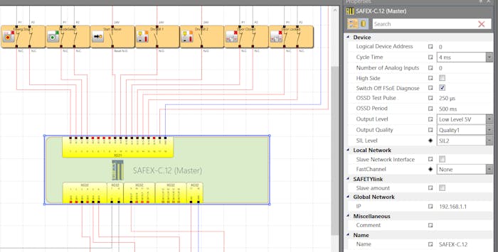

3. Settings inside SAFEX control
The settings of the SAFEX control and the devices connected to the ctrlX SAFETY control should be according to the following.
Fig. 6.: Settings of SAFEX control

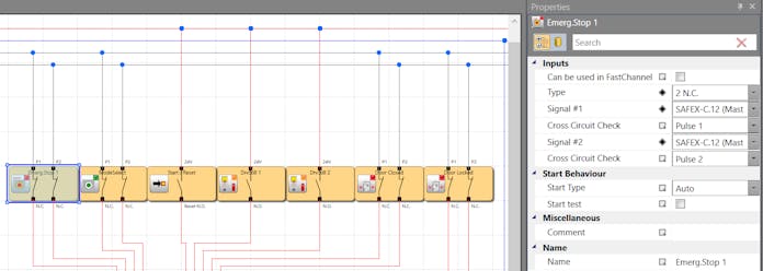

Fig. 7.: Settings of “Emergency Stop” button connected to SAFEX control

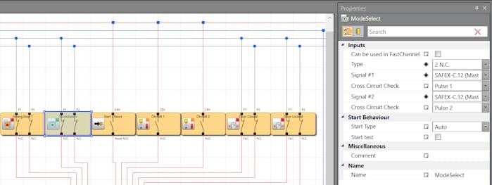

Fig. 8.: Settings of “ModeSelect” switch connected to SAFEX control

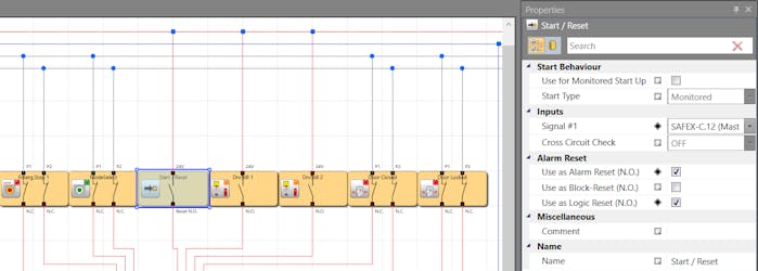

Fig. 9.: Settings of “Start/Reset” button connected to SAFEX control

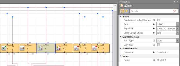

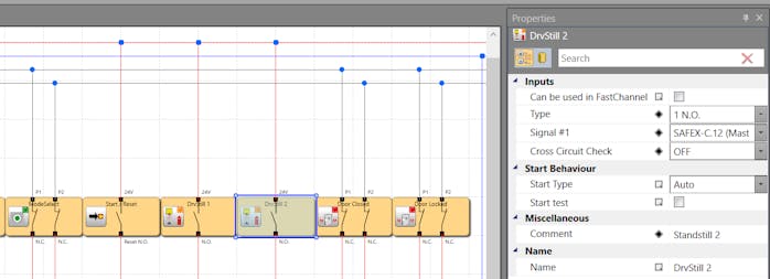

Fig. 10.: Settings of “Drive standstill” inputs connected to SAFEX control

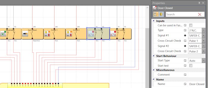

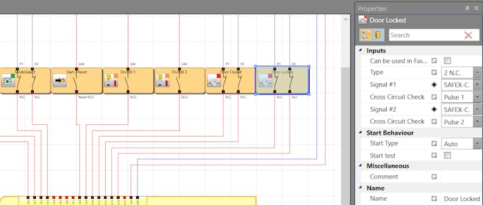

Fig. 11.: Settings of “Door closed” contacts connected to SAFEX control
Fig. 12.: Settings of “Door locked“ contacts connected to SAFEX control

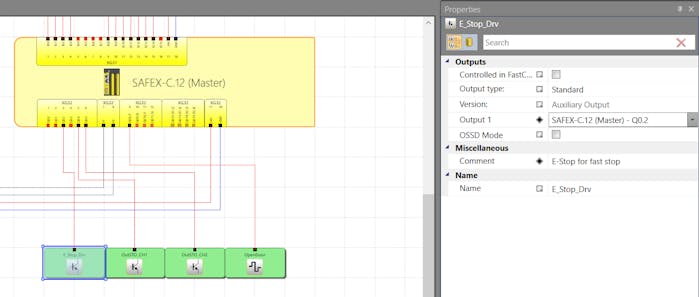

Fig. 13.: Settings of E-Stop output of SAFEX control
Mind that the E-Stop is not using an OSSD output.
In order to achieve this, the property SIL Level of the SAFETY control needs to be set to SIL2 (see Fig. 6). Then the Output type may be selectable with Standard (see in here Fig. 13)”.
If using OSSD outputs the overall SIL Level for those safety functions is SIL3, even if only SIL2 is been selected.

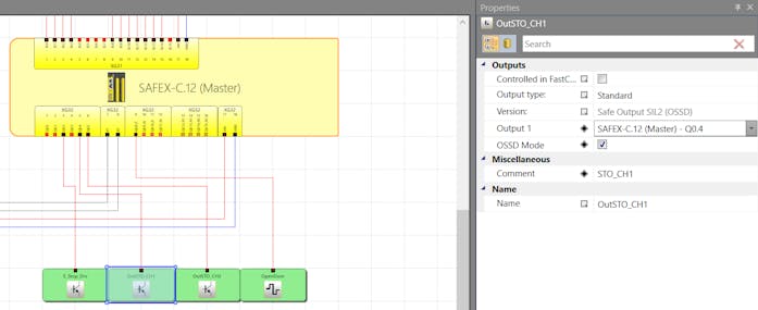

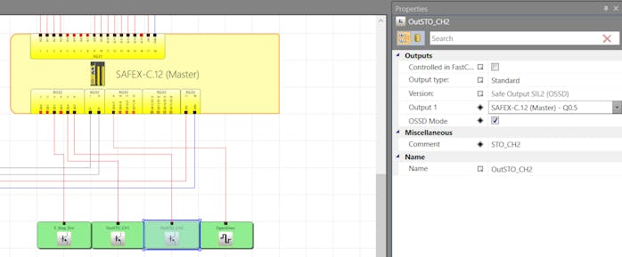

Fig. 14.: Settings of STO outputs of SAFEX control

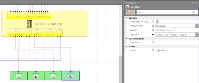

Fig. 15.: Settings of “OpenDoor” output of SAFEX control

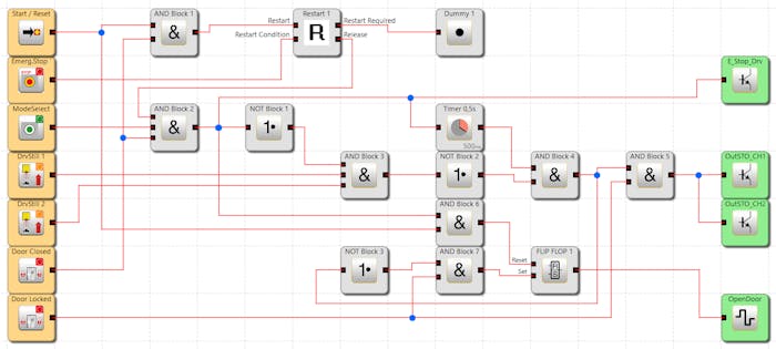

4. Safe logic inside SAFEX control
The safe logic inside the SAFEX control is created according to the following schematics.

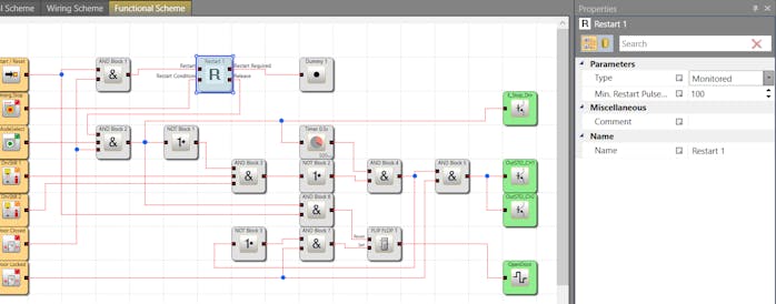

Fig. 16.: Safe logic inside SAFEX control
Fig. 17.: Settings of Restart block

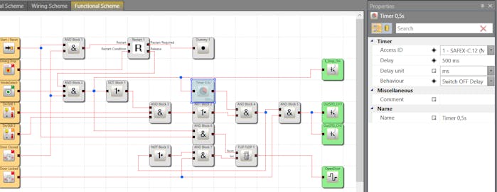

Fig. 18.: Settings of Timer (in here as delay time 0,5 s is chosen, in your application this time may differ)

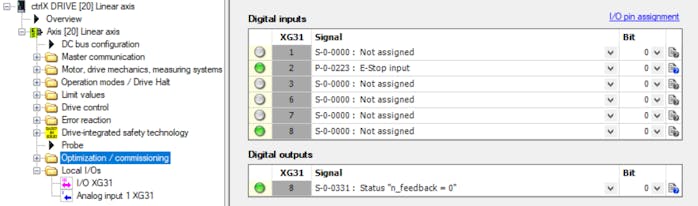

Fig. 20.: Settings of ctrlX DRIVE (1): I/O signal settings

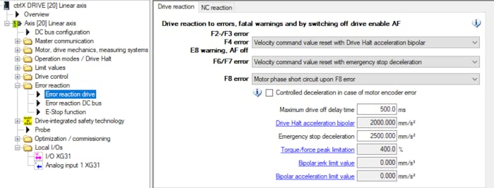

Fig. 21.: Settings of ctrlX DRIVE (2): Error reaction settings

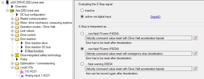

Fig. 22.: Settings of ctrlX DRIVE (3): E-Stop reaction settings
