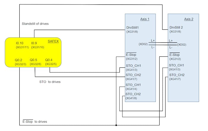

2. Wiring schematics
The SAFEX control´s input devices are:
  • 1 double channel EMERGENCY STOP button
  • 1 single channel "Reset" button
  • 1 double channel “Mode Select” switch
  • 1 double channel “Enabling control” button
  • 2 single channel inputs coming from the ctrlX DRIVE devices individually indicating that standstill is achieved
  • All double channel buttons fed by pulsed 24V
The output devices are:
  • 1 single channel output for control of so-called E-Stop function of drives (quick changeover to standstill)
  • 2 OSSD fed outputs connected to double channel STO input of drives
  • 1 single channel output SafeZoneError (SZE) to signal that an error is present in the SAFETYlink connection or the drive safety functions
  • 1 single channel output SafeZoneAcknowledge (SZA) to signal that the drive is in a safety state (EMERGENCY STOP (SMES), Safe Operational Stop (SMST2) or Safe Motion (in here SMM1) condition)
  • Drives (in here 2 are used) controlled and connected over SAFETYlink
Fig. 2.: Wiring schematics

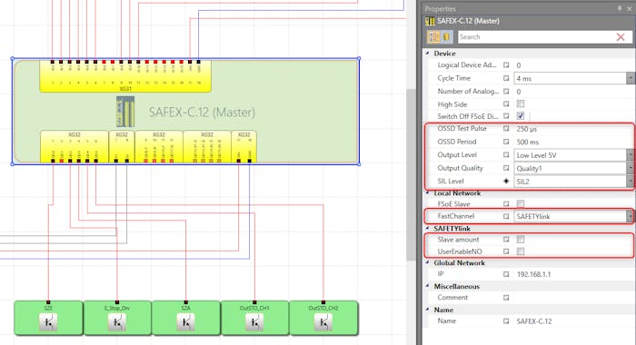

The settings of the SAFEX control and the devices connected to the ctrlX SAFETY control should be according to the following.
Fig. 3.: Settings of SAFEX control (number of slaves of SAFETYlink participants could be set corresponding to the amount really present)

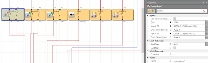

Fig. 4.: Settings of “Emergency Stop” button connected to SAFEX control

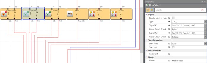

Fig. 5.: Settings of “Mode Select” switch connected to SAFEX control

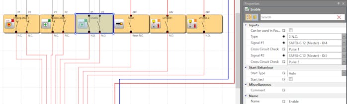

Fig. 6.: Settings of “Enabling Control” button connected to SAFEX control

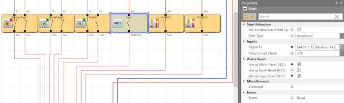

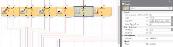

Fig. 7.: Settings of “Start/Reset” button connected to SAFEX control

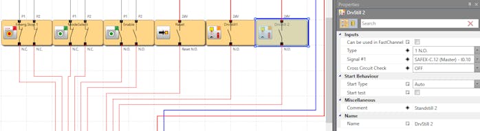

Fig. 8.: Settings of “Drive Standstill 1” signal connected to SAFEX control
Fig. 9.: Settings of “Drive Standstill 2” signal connected to SAFEX control

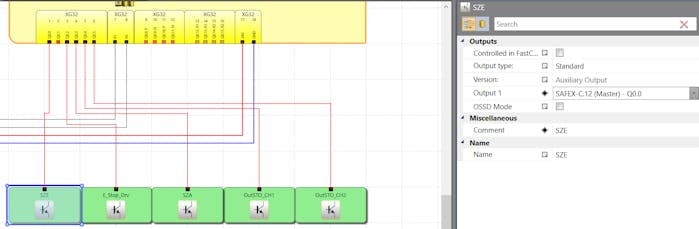

Fig. 10.: Settings of “SafeZoneError” output (SZE) of SAFEX control

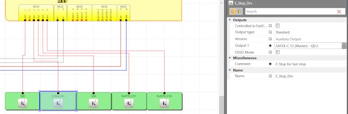

Fig. 11.: Settings of “E-Stop” output to drives of SAFEX control
Mind that the E-Stop is not using an OSSD output.
In order to achieve this, the property SIL Level of the SAFEY control needs to be set to SIL2 (see Fig. 4). Then the Output type may be selectable with Standard (see in here Fig. 12)”.
If using OSSD outputs the overall SIL Level for those safety functions is SIL3, even if only SIL2 is been selected.

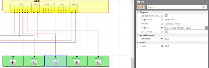

Fig. 12.: Settings of “SafeZoneAcknowledge” output (SZA) of SAFEX control

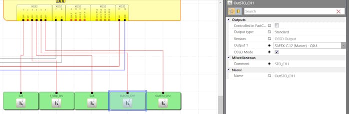

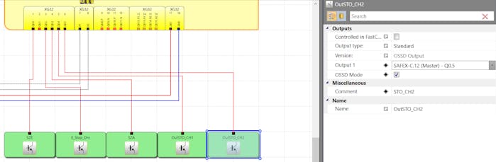

Fig. 13.: Settings of “Safe Torque Off” output channel 1 (STO_Ch1) of SAFEX control
Fig. 14.: Settings of “Safe Torque Off” output channel 2 (STO_Ch2) of SAFEX control

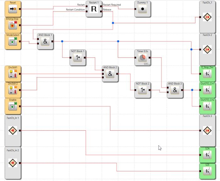

4. Safe logic inside SAFEX control
The safe logic inside the SAFEX control is created according to the following schematics.
Fig. 15.: Safe logic inside SAFEX control (1) (inside Functional Scheme)

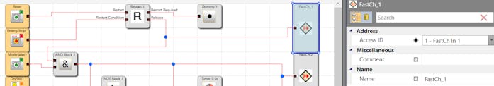

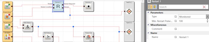

Fig. 16.: Configuration of element “Restart 1” (inside Functional Scheme)

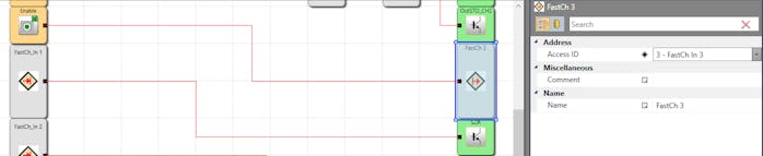

Fig. 17.: Configuration of element “FastCh_1” (inside Functional Scheme) as “FastCh In 1” (inside FastChannel Scheme)

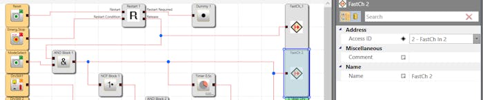

Fig. 18.: Configuration of element “FastCh_2” (inside Functional Scheme) as “FastCh In 2” (inside FastChannel Scheme)
Fig. 19.: Configuration of element “FastCh_3” (inside Functional Scheme) as “FastCh In 3” (inside FastChannel Scheme)

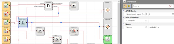

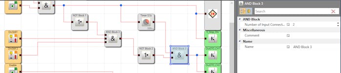

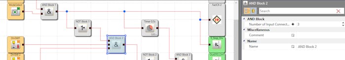

Fig. 20.: Configuration of elements “And Block” (inside Functional Scheme)

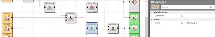

Fig. 21.: Configuration of elements “Not Block” (inside Functional Scheme)

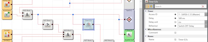

Fig. 22.: Configuration of element “Timer 0,5s” (inside Functional Scheme)
Mind that for other applications this time might have to be set different!

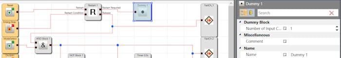

Fig. 23.: Configuration of element “Dummy” (inside Functional Scheme)

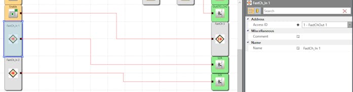

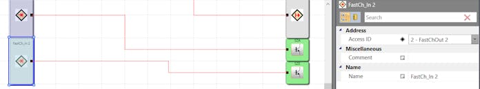

Fig. 24.: Configuration of element “FastCh_In 1” (inside Functional Scheme) as “FastChOut 1” (inside FastChannel Scheme)
Fig. 25.: Configuration of element “FastCh_In 2” (inside Functional Scheme) as “FastChOut 2” (inside FastChannel Scheme)

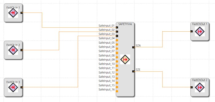

Inside the FastChannel Scheme the input elements are connected to a SAFETYlink block which communicates to the drives.
Fig. 26.: Safe logic inside SAFEX control (inside FastChannel Scheme)
Fig. 27.: Configuration of element “SAFETYlink” (inside FastChannel Scheme)

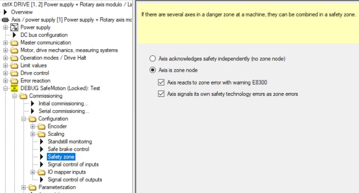

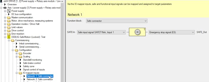

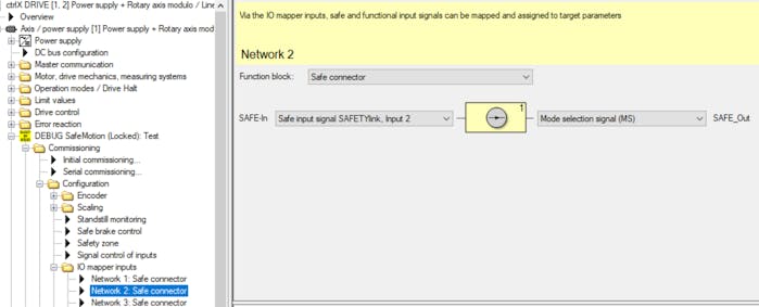

Fig. 28.: Settings of ctrlX DRIVE (1): Safety zone settings

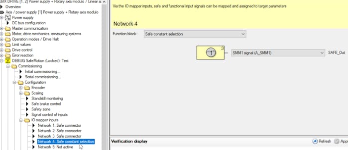

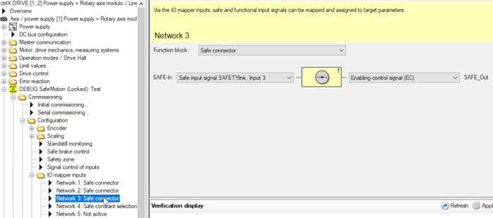

Fig. 29.: Settings of ctrlX DRIVE (2): I/O mapper input settings (1)
Fig. 30.: Settings of ctrlX DRIVE (3): I/O mapper input settings (2)
Fig. 31.: Settings of ctrlX DRIVE (4): I/O mapper input settings (3)
Fig. 32.: Settings of ctrlX DRIVE (5): I/O mapper input settings (4)
For further information to correct parameter settings of ctrlX DRIVE refer to:
How-to-commission-SafeMotion-SMO-with-ctrlX-DRIVE

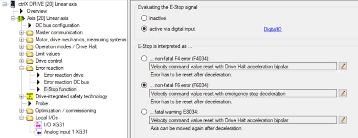

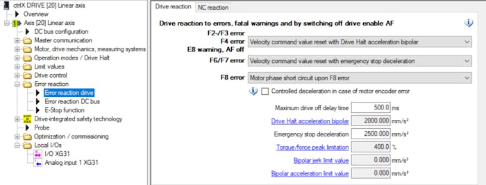

Fig. 35.: Settings of ctrlX DRIVE (2): Error reaction settings
Fig. 36.: Settings of ctrlX DRIVE (3): E-Stop reaction settings
