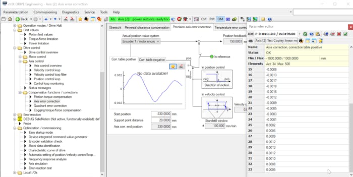

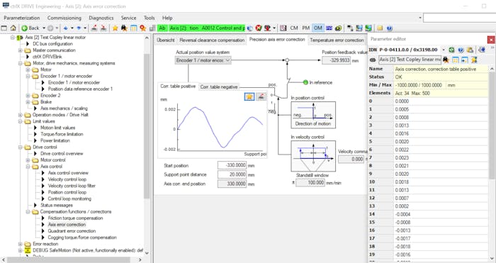

The precision axis error correction is activated by
- defining a start position (in here -330 mm) and
- defining a distance from correction point to correction point
After entering the correction values in the positive and negative correction table the axis error end position is automatically calculated by the number of correction points. In here this is +330 mm as 34 correction points from line 0 to 33 are entered.
Fig. 2.: Configuration for “Precision axis error correction” (1)
Fig. 3.: Configuration for “Precision axis error correction” (2)

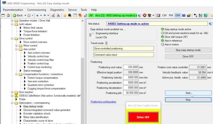

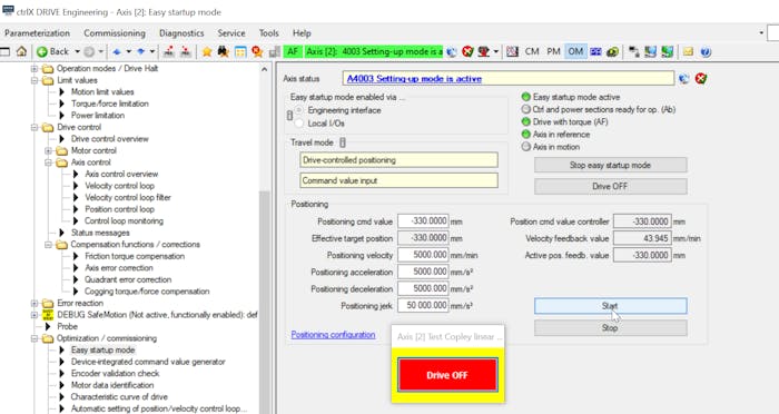

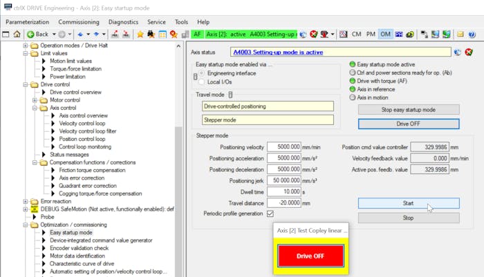

The precision axis error correction tables are simplest learned by using the “Easy Startup Mode” inside the drive. Prerequisite is that the axis is already in reference. Start “Easy Startup Mode”, select “Drive-controlled positioning”, use “Command value input”, key in the start position
(in here -330 mm) then press button “Drive On”!
Fig. 4.: Easy Startup Mode using “Drive-controlled positioning” with Command value input to get to starting point in positive direction

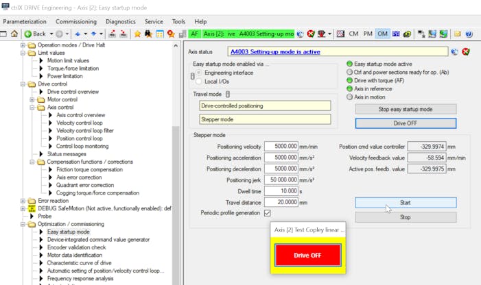

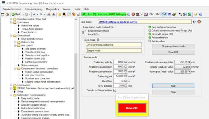

Press “Start” button! After reaching start point, press button “Drive OFF”, select “Stepper mode”, key in right distance like configured as correction points, press button “Drive ON” and start move by pressing “Start” button
Fig. 5.: Start “Stepper mode” move and write down errors at end of each stepper movement visible in e.g. the laser interferometer (in here start point is -330 mm)
Fig. 6.: In “Stepper mode” move at in here point -270 mm error table point is written down using the exact laser interferometer position

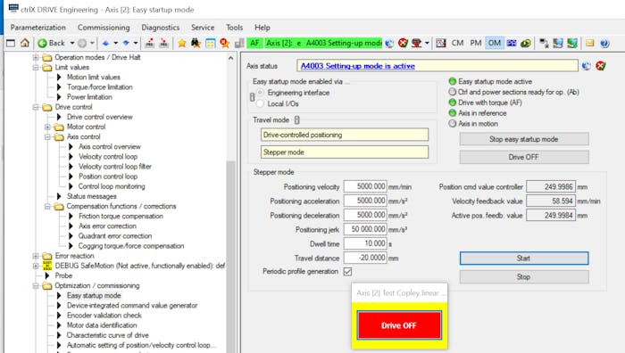

Fig. 7.: Easy Startup Mode using “Drive-controlled positioning” with Command value input to get to starting point in negative direction
Fig. 8.: Start “Stepper mode” move and write down errors at end of each stepper movement visible in e.g. the laser interferometer (in here start point is +330 mm)
Fig. 9.: In “Stepper mode” move at in here point +250 mm error table point is written down using the exact laser interferometer position
