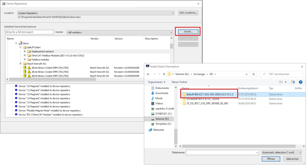

Install device description
  • Download ESI (device description) on Balluff website:
    Downloads / Software / ESI
    e.g. for this example: https://www.balluff.com/de-de/products/BNI0077
  • Open Tools > Device Repository
    Open Device Repository
  • Install device description

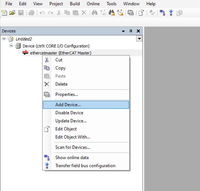

  • Add Device to EtherCAT-Master by right-click in the device tree on ethercatmaster > Add Device:
    EtherCAT device configuration

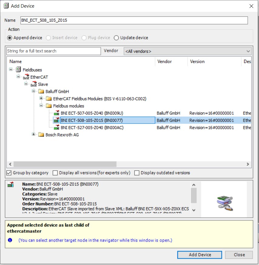

  • Choose the relevant ESI (device description) for your device from device catalog > Add Device:
    Add device

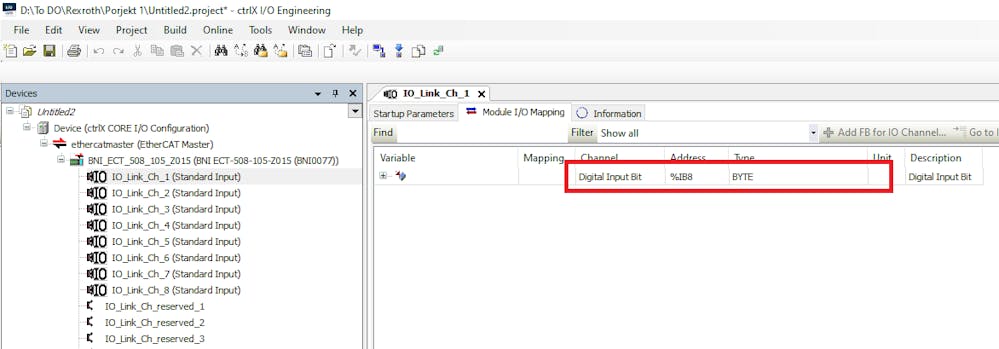

  • The IO-Link Master is now pre-configured with standard I/O on pin 4 for all ports
    Preconfiguration
Port Configuration

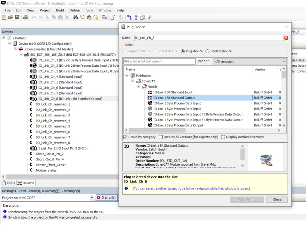

  • The ports of the IO-Link Master are freely configurable for your application and individual needs. For connecting IO-Link devices, an IO-Link communication can be set up on pin 4. If only digital IOs are needed, Pin 2 and 4 can also be configured as simple input or output. The configuration of the pin functions is done by plug device. The configuration of pin 4 has to be done for each port seperatly, pin 2 is combined for each port.

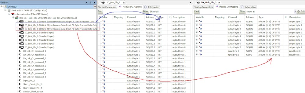

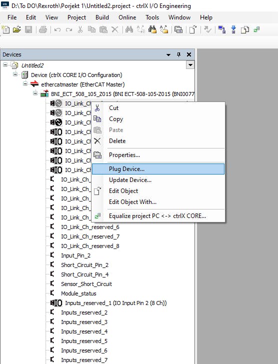

  • To configure the IO-Link port communication on pin 4, a suitable process data module must be selected: right click on IO-Link channel > Plug Device
    Plug device selection
  • Choose  module > Plug Device
    Plug Device
  • For the correct process data size, see the manual of the IO-Link device used.
    Make sure that enough memory space has been reserved in case one of the modules does not fit exactly.
    There are two possible data types for process data, which are indicated by different colors of the IO-Link icon: grey for bits and black for array of bytes. Use plug device to choose one of these representation of process data.
    Process data figure
  • To configure pin 4 as input or output, use the input or output module, not a IO-Link module
    IO_Link_CHx > Plug Device
    Configure pin 4

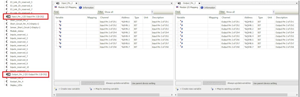

  • To configure pin 2 as input or output, plug the device into slots for pin 2.
    Input_Pin_2 > Plug Device to configure input process data
    Output_Pin_2 > Plug Device to configure output process data
    Configure pin 2
    It is alwas possible to use pin 2 in both directions. Attention: In contrast to pin 4, a common byte is used for the pin 2 function. The bits from 0 to 7 represent the pin 2 of port 0 to 7.

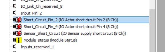

  • There are four slots for direct and fast diagnosis of the powersupply:
    Diagnostic bytes
    For short circuit modules: each bit of the byte represents one of the eight ports.
    Short circuit modules

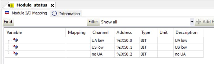

    The module status shows the power supply of the IO-Link Master
    Module status

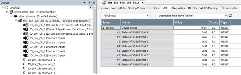

  • The status of the IO-Link communication is displayed for each channel in a status byte.
    Communication status
    The Status can also be seen in the CoE online data:
    CoE communication status
    These are the possible values:
    Possible ports

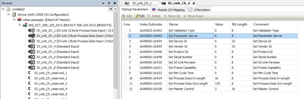

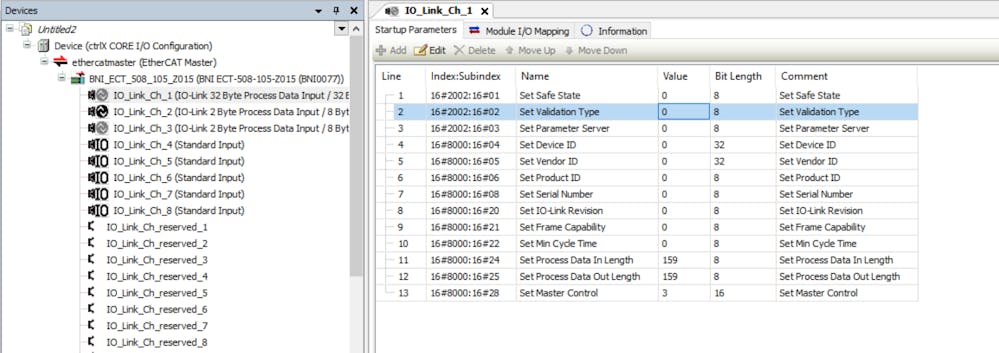

  • A validation for each Port can be configured: IO-Link_Chx > Startup Parameter
    Port validation
    The validation mode is stored in parameter index 0x20n2, subindex 0x02 (n = port number 0...7)
    No validation (value 0): validation deactivated, every device will be accepted
    Compatibility (value 1): manufacturer ID and device ID are compared to the module data. The IO-Link communication is only started if there is a match.
    Identity (value 2): manufacturer ID and device ID and serial number are compared to the module data. The IO-Link communication is only started if there is a match.
    The values for validation are stored in index x80n0, subindex 0x04 (Device ID), 0x05 (Vendor ID), 0x08 (Serial Number).

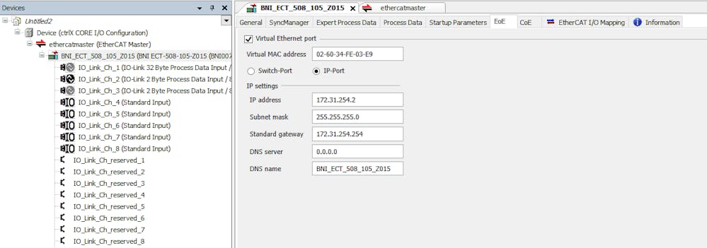

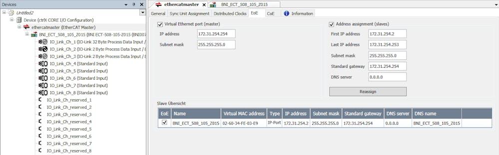

  • EtherCAT network configuration
    Activate the virtual ethernet port and configure the network adress in the tab EoE of the EtherCAT Master:
    EtherCAT Master > EoE > virtual Ethernet port (master)
    EoE settings
    In the tab EoE of the EtherCAT Master is a overview of all slaves that support EoE functionality. Here, it is possible to activate the virtual port of the slaves and assign the network configuration automatically or manually.

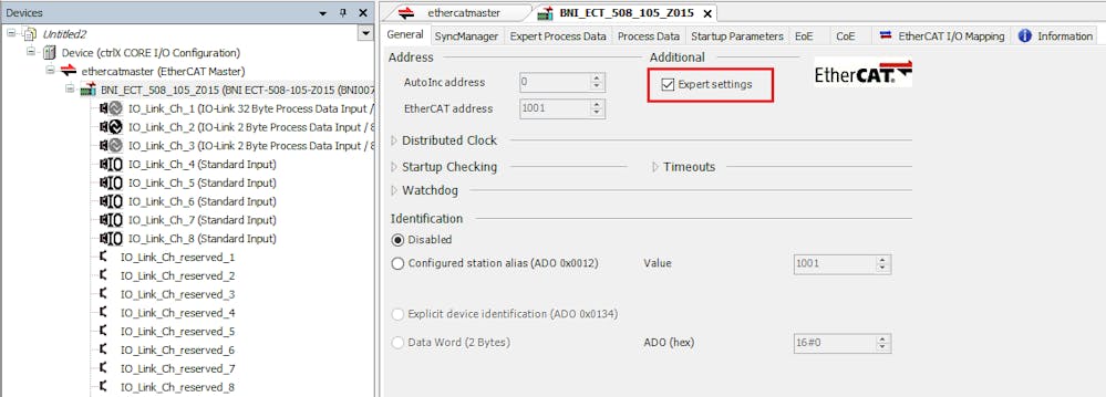

    It is also possible to activate expert settings to enable EoE on the IO-Link Master. The EoE tab appears. Now you can activate the virtual port of the IO-Link Master and assign the network configuration here .
    EtherCAT Slave > General > enable expert settings
    Expert settings
    EtherCAT Slave > EoE > virtual ethernet port
    Virtual ethernet port

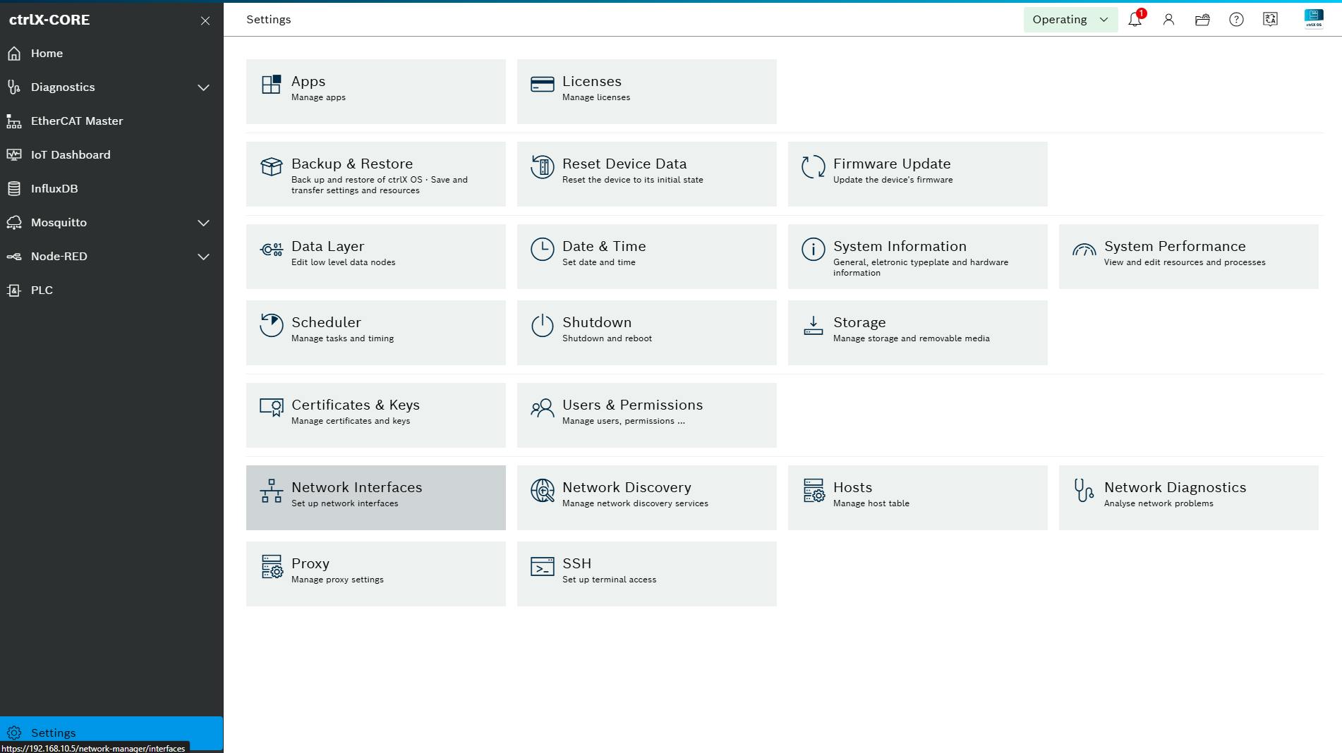

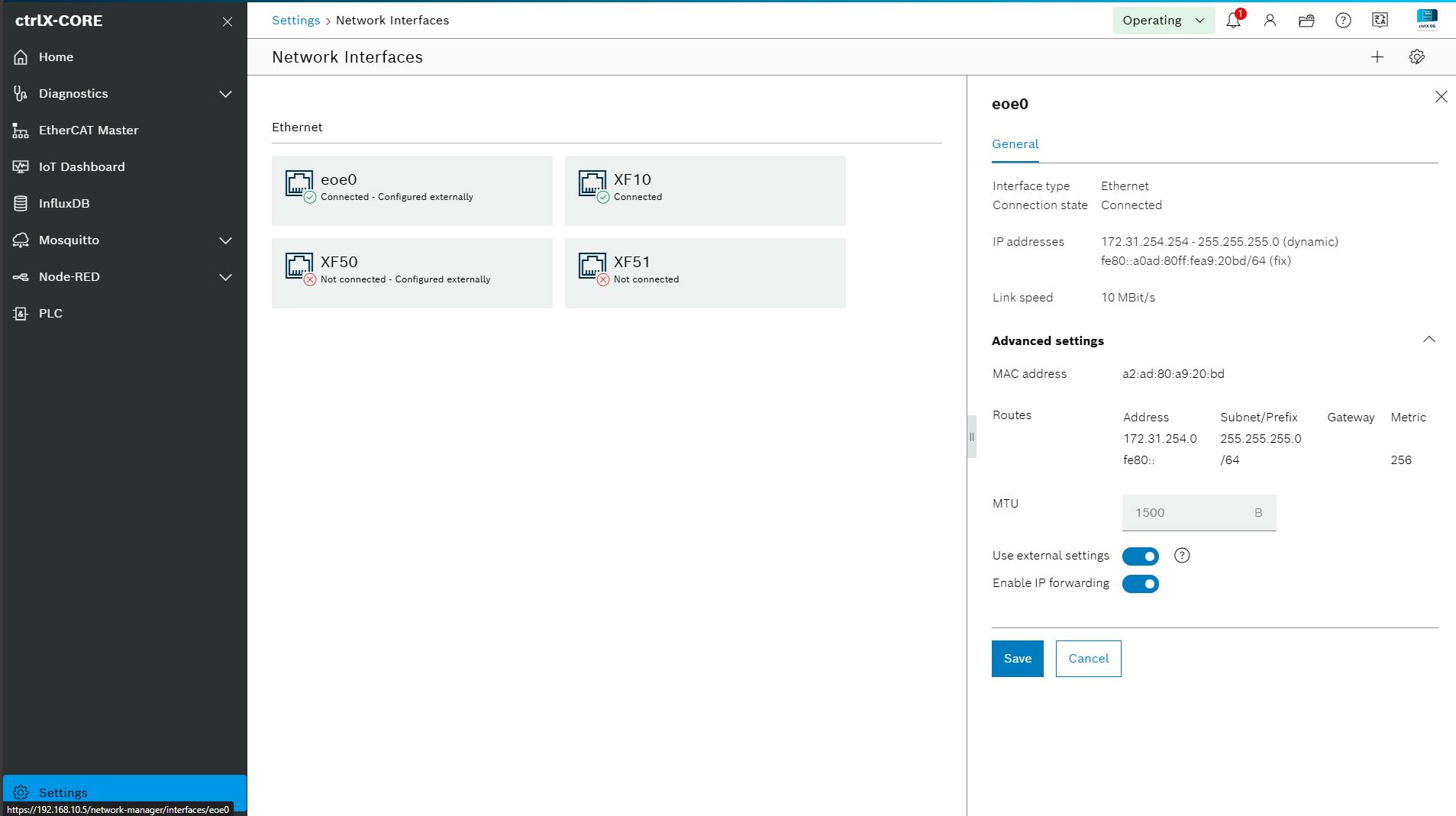

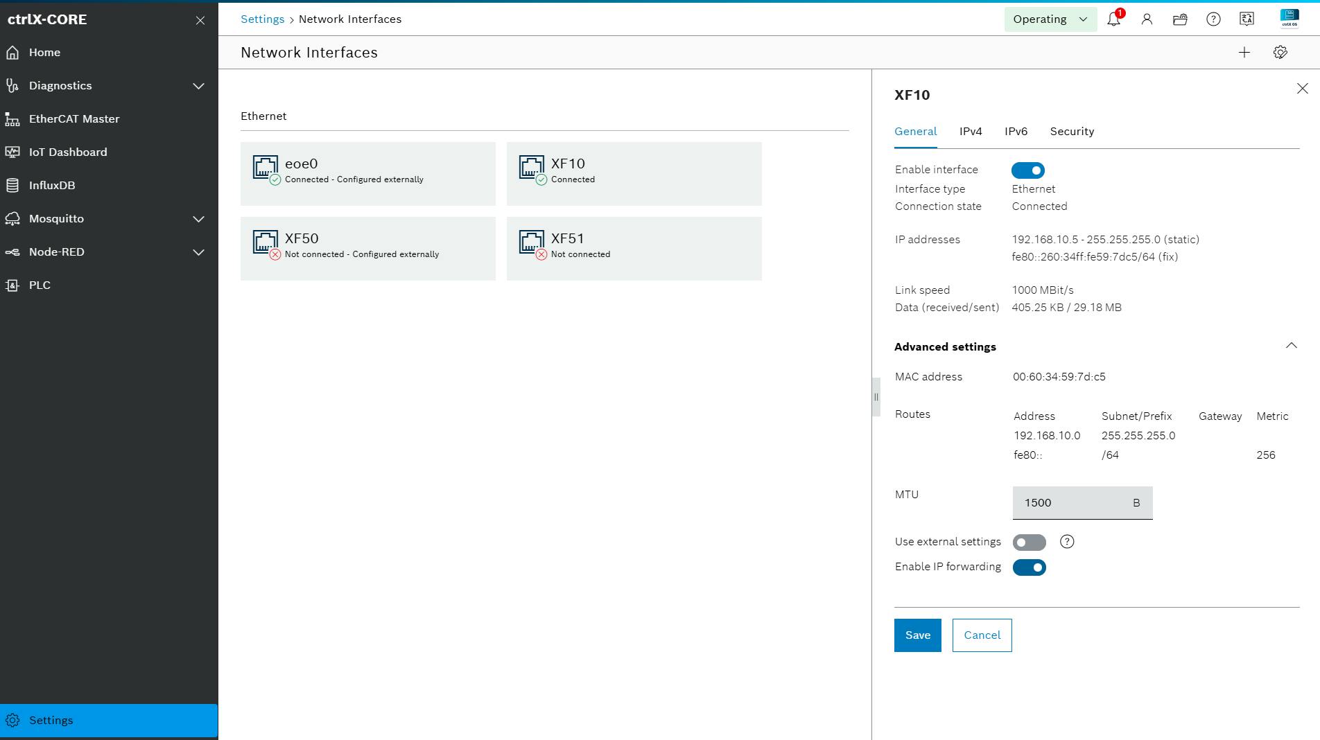

  • ctrlX CORE network configuration
    It's necessary to enable IP forwarding in the connectivity settings of the EoE port (eoe0) and the engineering port (eth0).
    Settings > Network Interfaces
    ctrlX CORE Network Interface Settings
    Settings > Network Interfaces > eoe0 > Advanced settings > enable IP forwarding
    ctrlX CORE IP forwarding eoe0
    Settings > Network Interfaces > eth0 > Advanced settings > enable IP forwarding
    ctrlX CORE IP forwarding XF10

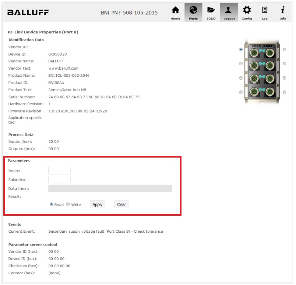

IO-Link Parametrization
  • Via Webserver
    If you have access to Webserver over EoE, you can configure your IO-Link devices in a web browser.
    Open website via IP-Adress > ports
    Webserver
    To write parameters, you must log in. Password: BNIECT.
    It's also possible to upload an IODD file to set parameters with plane text.
  • Via Parameter Server:
    An IO-Link master according to IO-Link Specification 1.1 can act as a parameter assignment server for the IO-Link device.
    IO-Link_Chx > Startup Parameter > Set Parameter Server index 0x20n2, subindex 0x03 (n = port number 0...7)
    Parameter server
    Switched on: data management functions enabled, parameter data and identification data of the IO-Link devices are residually saved.
    Switched off: data management functions disabled, saved data are retained.
    Deleted: data management functions disabled, saved data is deleted.
    Enable upload: Select whether an upload of parameter data to the data management of the IO-Link master port is to be carried out or not. If the upload is enabled, the master starts a parameter data upload as soon as a device requests an upload (upload flag set) or if there is no data saved in the master port (e.g. after data has been deleted or before the first data upload)
    Block upload: If the upload is disabled, no data upload will be started. When there is an upload request from the IO-Link device, a download (if enabled) is started because no upload may be carried out if there are different parameter sets.
    Enable download: Select whether a download of parameter data to the IO-Link device is to be carried out or not. As soon as the saved parameter data in the parameter server of the port is differentiated from the connected IO-Link device and no upload request from the IO-Link device is present, a download is carried out.
    Block download: If the download is blocked, an upload (if enabled) of the parameter data occurs independent of the upload flag of the IO-Link device.
    Block upload and download: If upload and download are blocked, no parameter data exchange occurs. The IO-Link device then communicates anyway with the IO-Link port.
    The following values are possible for the settings:
    0x8X Switch on
    0x0X Switch off
    0x40 Delete
    0xX1 Switch on upload
    0xX2 Switch on download
    To enable the upload flag of an IO-Link device, the value 0x05 must be entered in the index 0x02, subindex 0
    (e.g. see Parametrization via CoE Online)

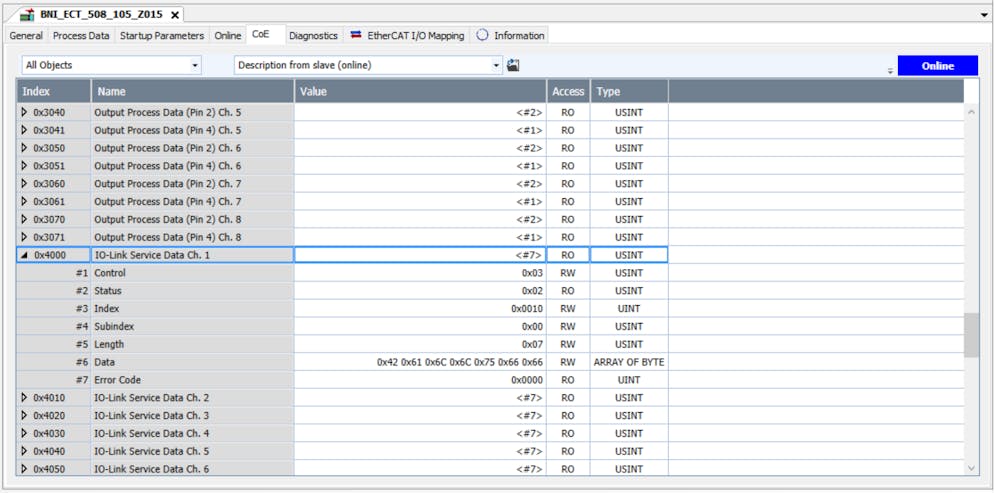

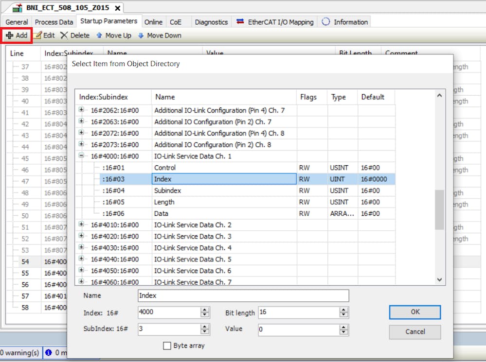

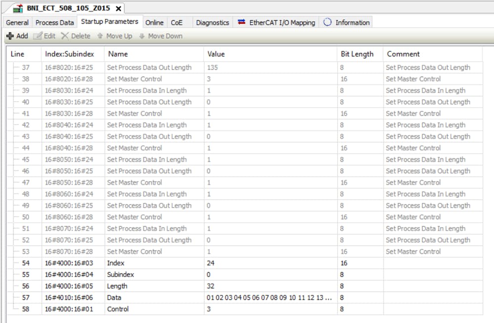

  • via CoE online
    Via object 0x40n0 (IO-Link Service Data Ch. X), IO-Link ISDU parameters can be read or written from the IO-Link device. To do this, the corresponding index and subindex must be entered. In addition, the corresponding length and the data must still be entered when writing. Via the control object, the read or write task is then started. In the Object status, the result is then displayed.
    IO-Link_Chx > Startup Parameter > IO-Link Service Data CH .X index 0x40n2 (n = port number 0...7)
    Control Values for the Control:
    • 0x00: No action
    • 0x02: Write
    • 0x03: Read
    Status Values for the Status:
    • 0x00: No activity
    • 0x01: Active / Busy
    • 0x02: Access
    • 0x04: Error
    • 0xFF: Failure
    example: reading index 0x10 Vendor Name
    1. Set IO-Link index (CoE Subindex 0x03), IO-Link subindex (0x04)
    2. Set contol (0x01) to value 0x03 (read)
    CoE read
    3. The answer is displayes in Data (0x06), Status (0x02) displays answer 0x02 (access).
    To write parameter, also set lenght (0x05) and data array (0x06).
  • via Startup Parameter
    For startup parameter you have to follow the same steps as for parameters via CoE.
    Make sure that the control command is always the last command for this parameter set. For more than one parameter, start again by setting index, subindex, lenght and Data and end the parameter with the command control .
    Startup parameter selection
    Startup parameter overview
