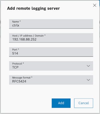

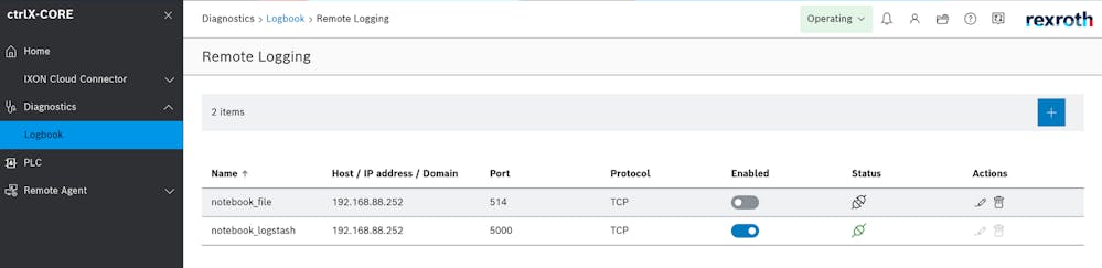

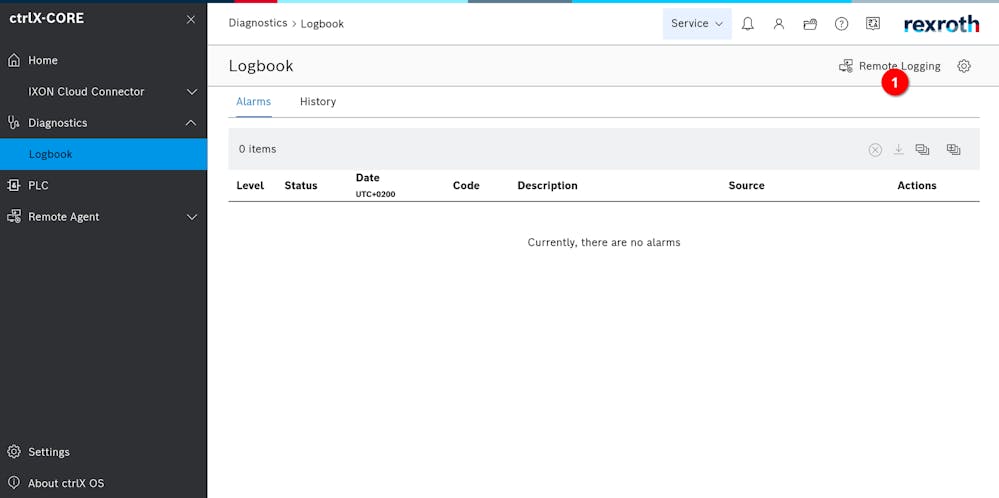

Setup ctrlX Core
ctrlX CORE settings
Remote logging server settings
Use the Host address where the syslog server will be reachable.

Setup ctrlX CORE
Same as in the rsyslog configuration but this time we use port 5000.

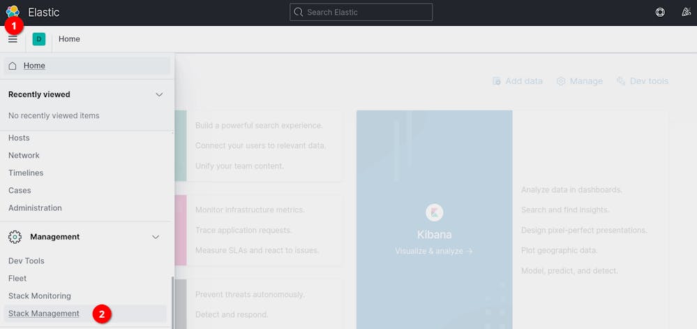

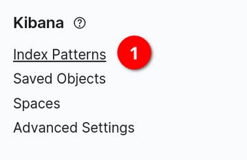

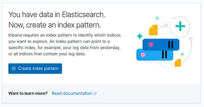

In Kibana, go to "Management" > "Stack Management" > "Index Patterns" > "Create index pattern".
Create index
Navigation
Navigation global

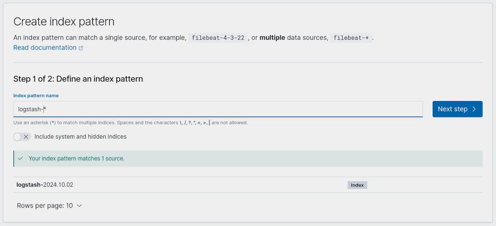

Enter logstash-* as the index pattern and click "Next step".
Index pattern

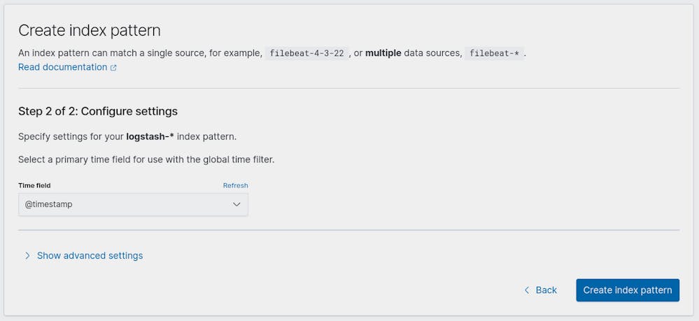

Select @timestamp as the Time field and click "Create index pattern".
Index pattern timestamp

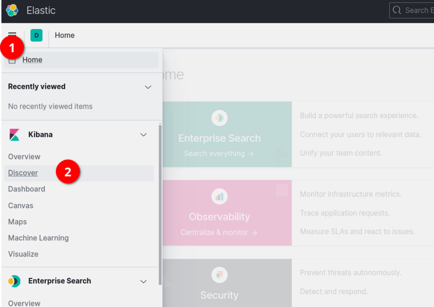

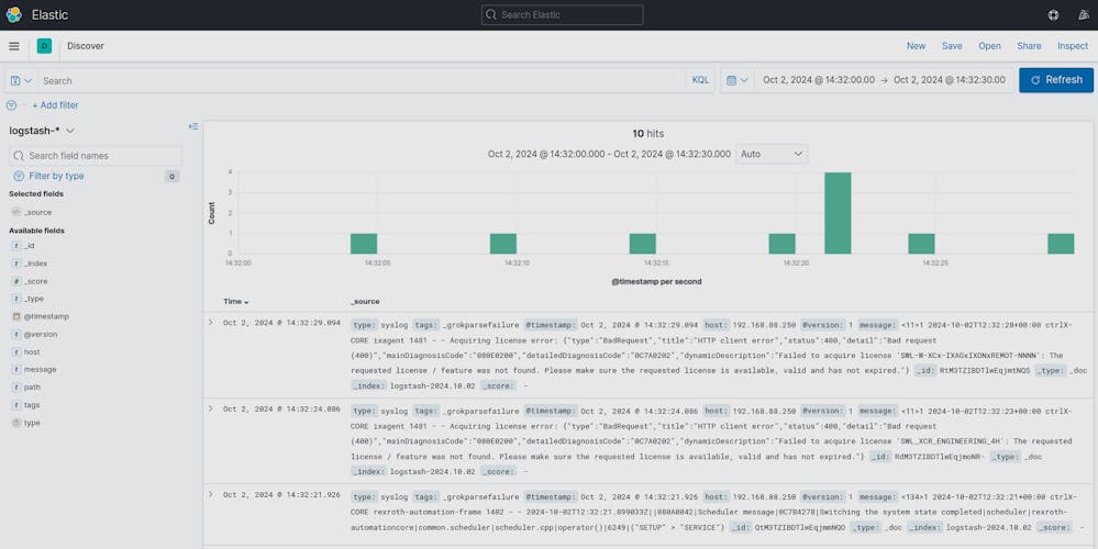

Go to "Discover" in the main menu to start exploring your logs.
Start Discover to explore your logs

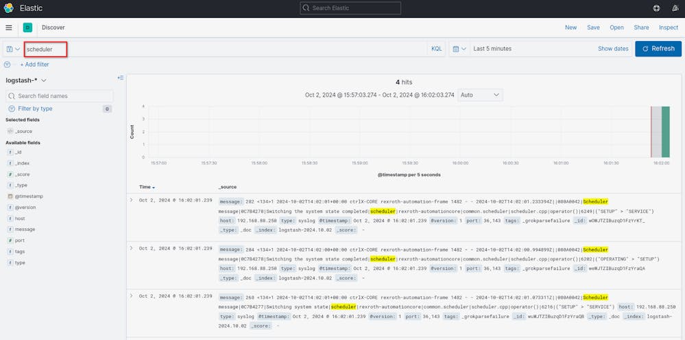

Example: Search for scheduler
Search scheduler
