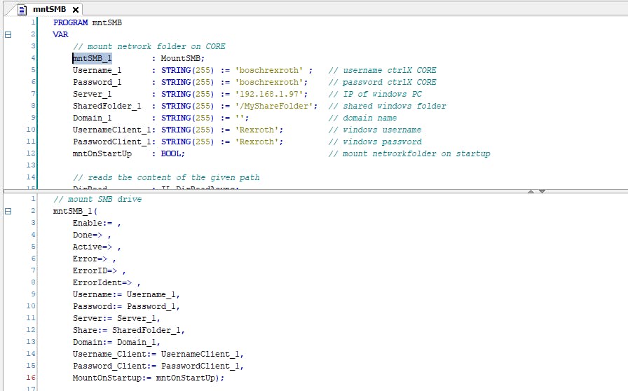

PLC code for mount network folder.
  • Add MountSMB function block from library manager
    This function block mounts an external network-server (SMB)
PLC example code

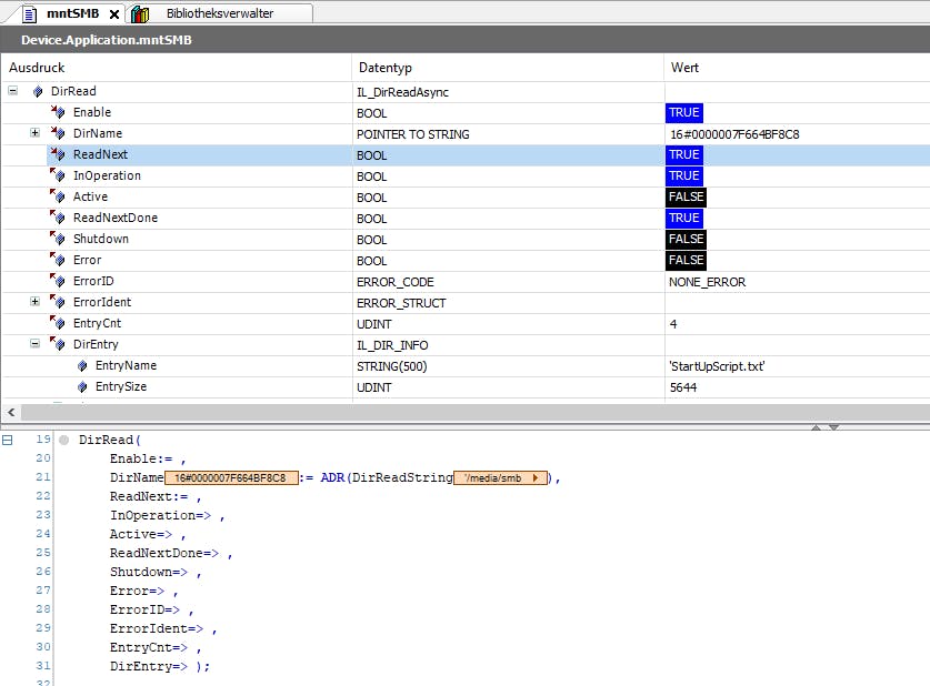

PLC code for reading the content of the given path
  • Add IL_DirReadAsync function block from library manager
PLC example code
With each flank at the ReadNext input, the next content of the path is read.
PLC example code

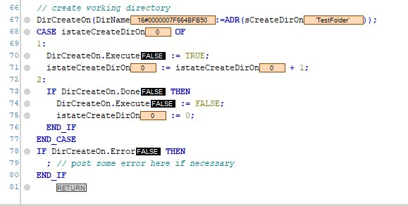

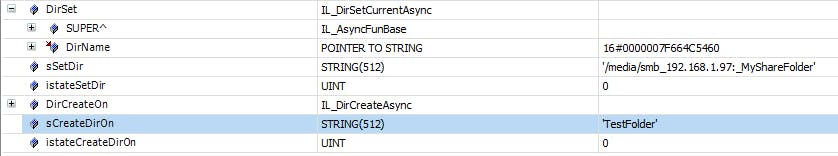

PLC code for create folder in the given path
  • Add IL_DirSetCurrentAsync function block from library manager
PLC example code
PLC example code
