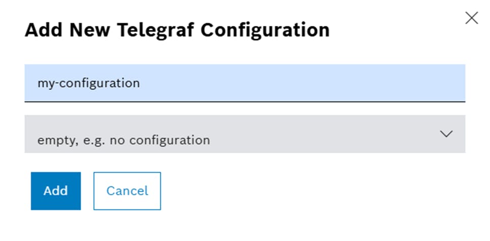

Create a new Telegraf configuration before the installation of the plugin. In the ctrlX OS Web-UI click on the “Telegraf” in the sidebar and on “+” to create a new Telegraf configuration. Choose a name of your choice and an empty configuration.
Add a new Telegraf Configuration

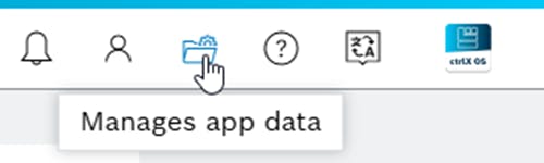

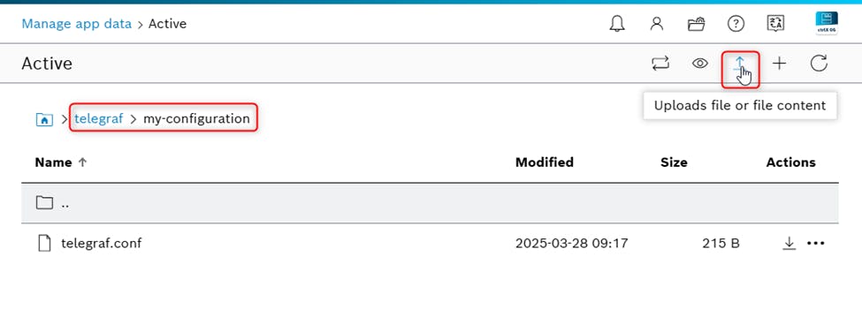

The Telegraf plugin can now be uploaded via the the app data manager:
  1. Click on the icon "Manage app data" in the header bar
    app data icon in the header bar
  2. Click on the Telegraf folder of the active configuration
  3. Navigate into the folder of your configuration (e.g. “my-configration")
  4. Click on upload file or file content button
    uploading files to the app data of the Telegraf configuration

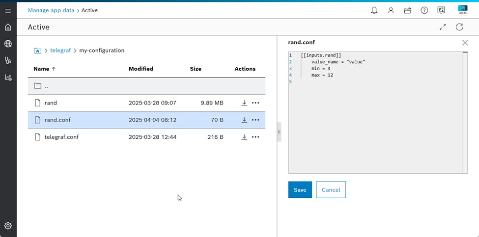

  6. Create a new file “rand.conf” (with a click on “+”)
  7. Edit the file and add the following configuration
    rand.conf in the app data of the Telegraf configuration
    [[inputs.rand]]
        value_name = "value"
        min = 4
        max = 12

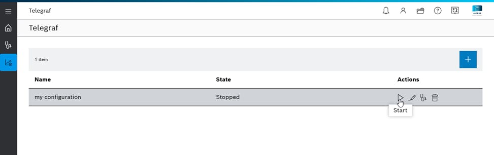

  1. Start the Telegraf configuration
    start the Telegraf configuration

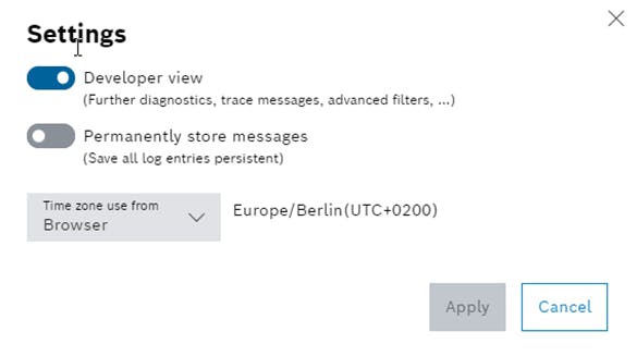

  2. Go to "Diagnostics->Logbook" in the sidebar and click on Settings there
  3. Enable the Developer view
    Activate developer view in the Logbook settings
