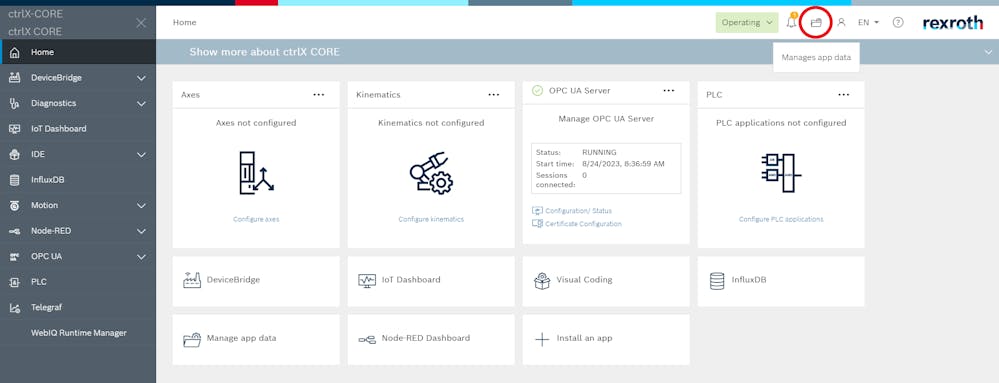

First, select the "Manage App Data" button.
Manage App Data

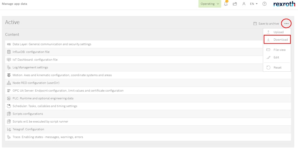

 Next, select the ellipsis to reveal menu options related to the active configuration. Select the "Download" option to download the active configuration as a zipped file.
Download Configuration

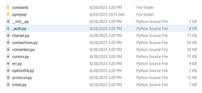

Using the PyMySQL library, copy the following files into /scripts/libraries/external/PyMySQL.
Python source files

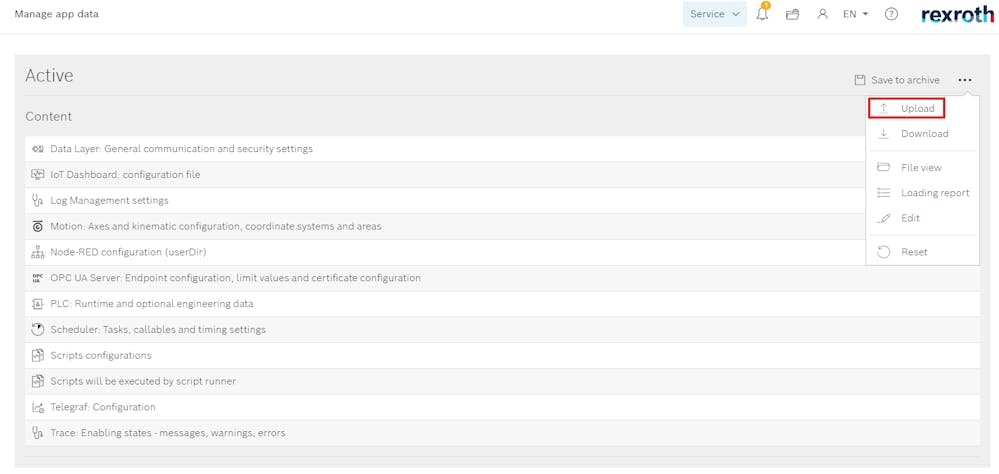

Upload New Configuration
Once the library has been packaged in the configuration, upload the configuration archive to the ctrlX OS.
Upload configuration
