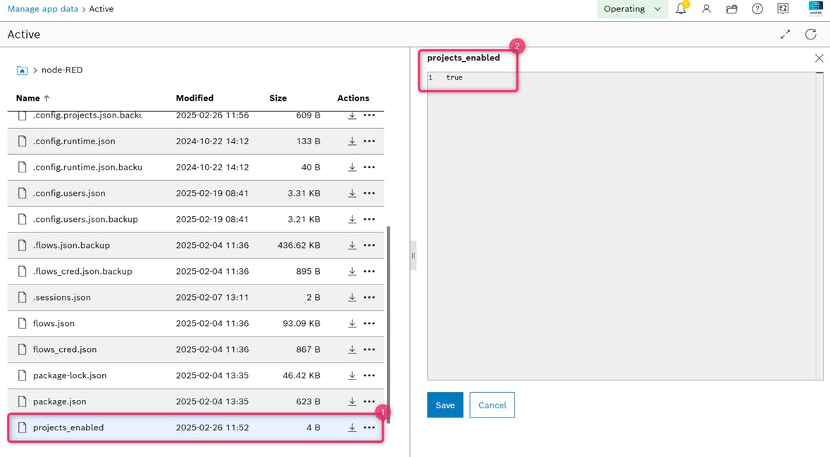

1) Enable Node-RED Projects

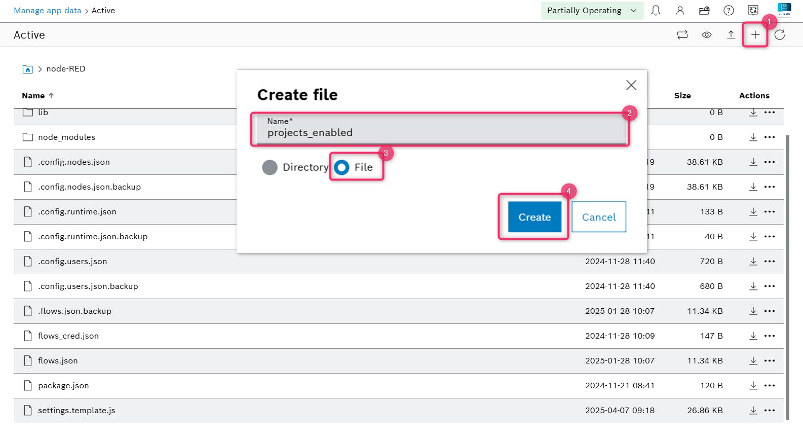

Navigate to "Manage App Data" -> "Node-RED configuration" -> "projects_enabled".
Set "projects_enabled" to "true" and click "Save".
Navigate to Node-RED configuration
If the file does not exist, simply create it by clicking on the plus in the top right corner, name it "projects_enabled" and set it to "true".
Create "projects_enabled" - file manually
In order to make the changes be effective, Node-RED has to be restarted once.

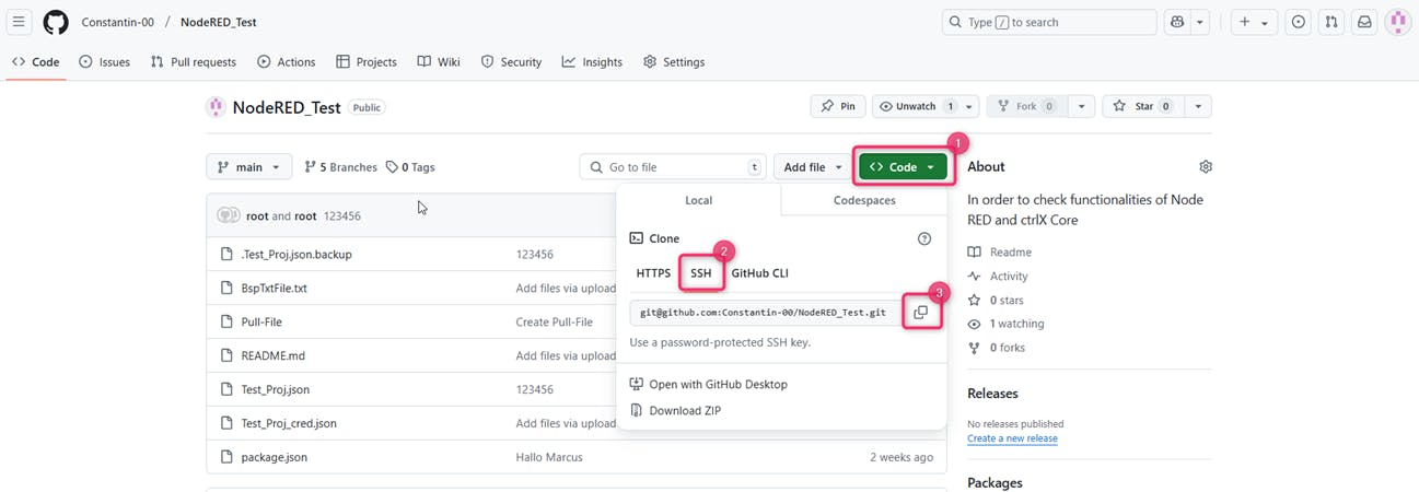

Open the GitHub repository that you want to connect with and copy the SSH URL.
Copy SSH-URL

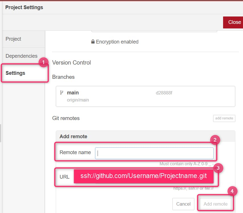

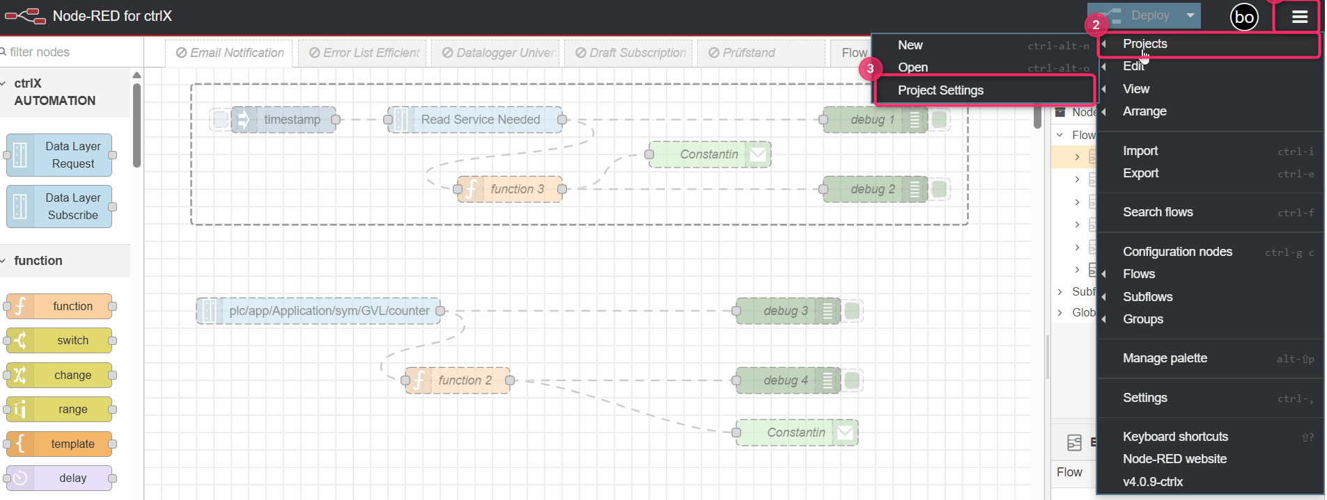

Go to Node-RED, open/create a project and add the URL as remote connection. The SSH-URL has to be modified to ssh://[email protected]/Username/Projectname.git
Navigate to Project Settings
Add a remote

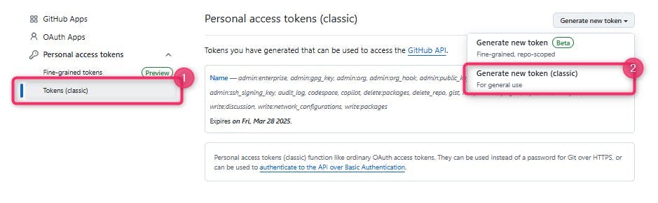

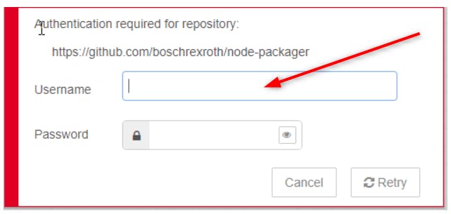

Furthermore, you have to add a personal access token to your GitHub Account:
Open GitHub and Navigate to "Settings" -> "Developer Settings" (at the very bottom) and generate a Classic Token.
Generate a token inside GitHub
Name the token and give it all necessary rights (You can just fill all of the boxes). Then click "Generate Token" and store the token at a secure location (f.e. KeyPass).
When using NodeRED Projects, following field will pop up, in which you will have to insert the token:
Paste your token into this field

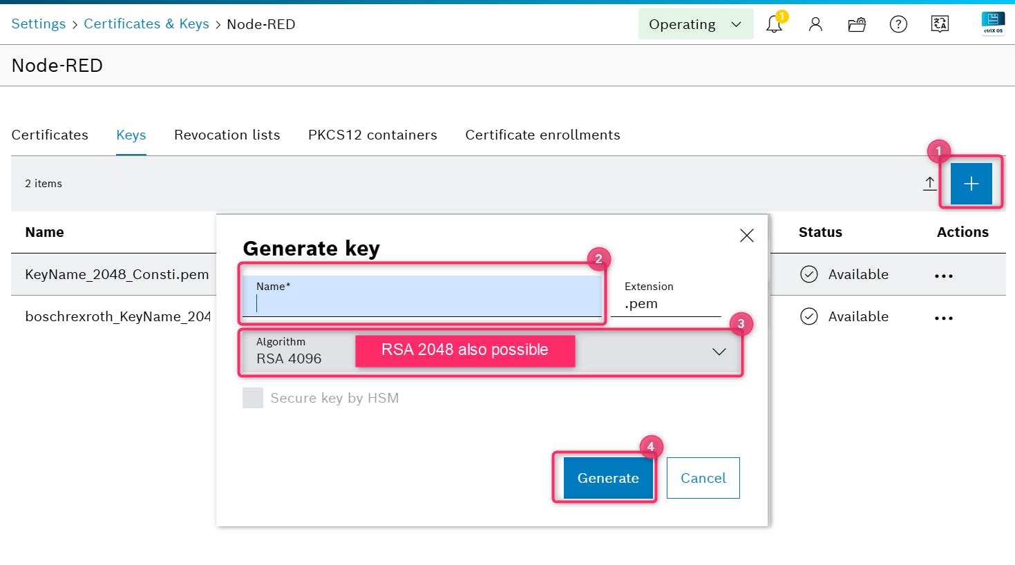

3) Generate an RSA Key and add it to your GitHub Account
Open the ctrlX Web-Interface and navigate to "Settings" -> "Certificates & Keys" -> "Node-RED" -> "Keys"
Generate a new Key

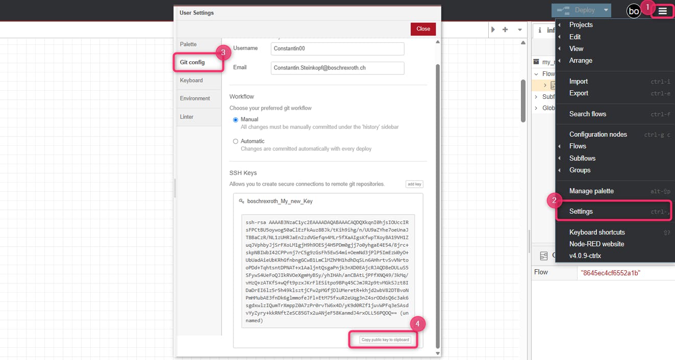

Next, you need to copy the correct key from Node-RED. Therefore, open Node-RED and Navigate to "Settings" -> "Git config" -> "SSH Keys" and copy the newly created key.
Copy the newly created key inside NodeRED

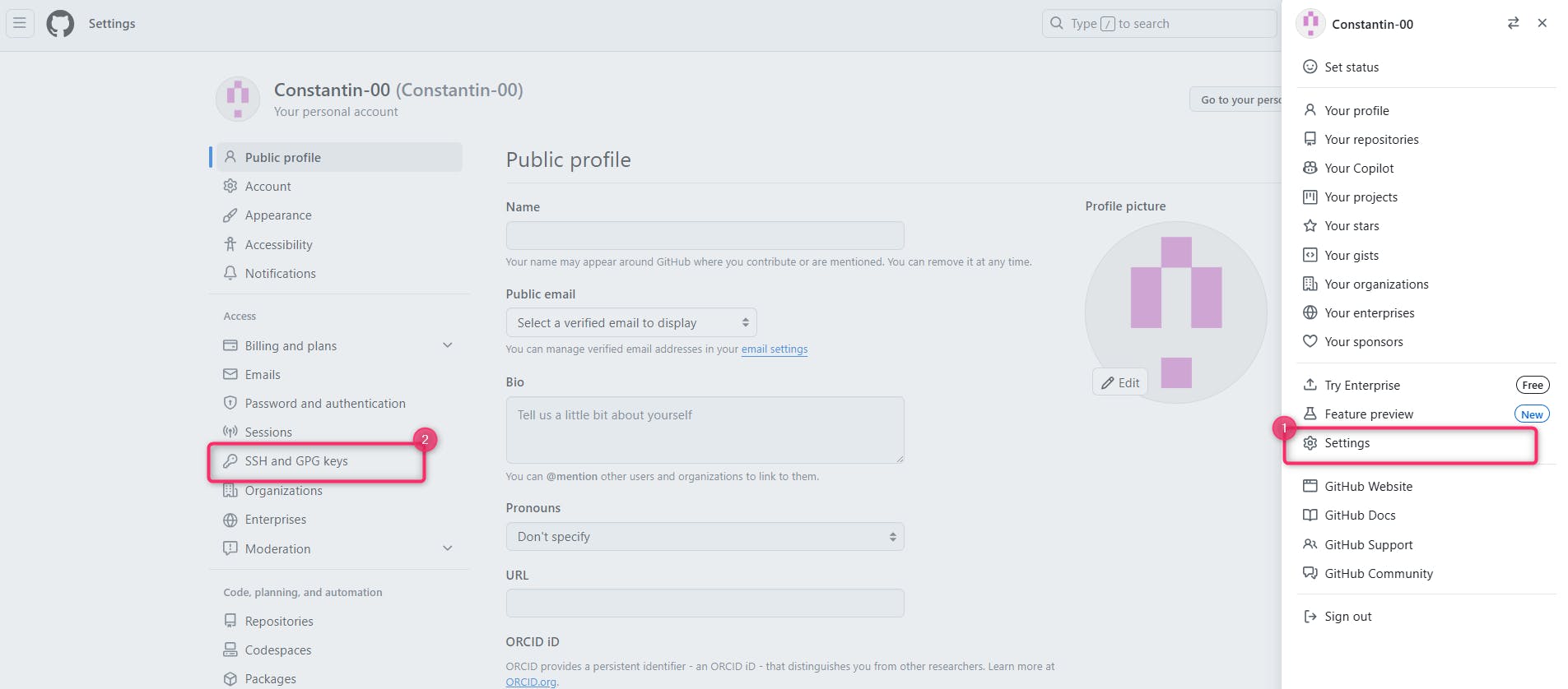

Open your Github Account and navigate to "Settings" -> "SSH and GPG Keys"
Navigate to "SSH and GPG Keys" inside GitHub

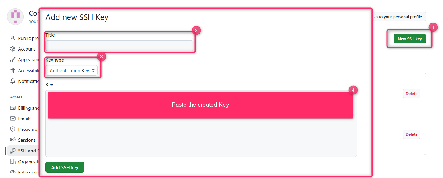

Click on "New SSH Key" and paste the newly generated key into your GitHub account.
Add a new SSH Key

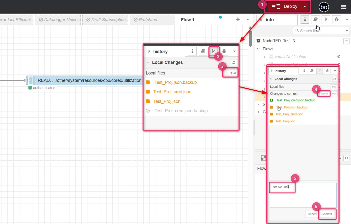

2) Commit your changes
If you made some changes in your flow, you can commit them afterwards. Therefore, first hit deploy, then stage your changes and commit them with a corresponding commit message.
Commit new changes

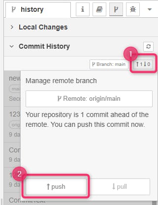

3) Push your changes into GitHub
To make your commits visible in your Online GitHub-repository, you have to push them. Therefore, open your Commit History, select a branch and click the small button in the top right corner, select the correct branch and click push.
Push commit to repository
