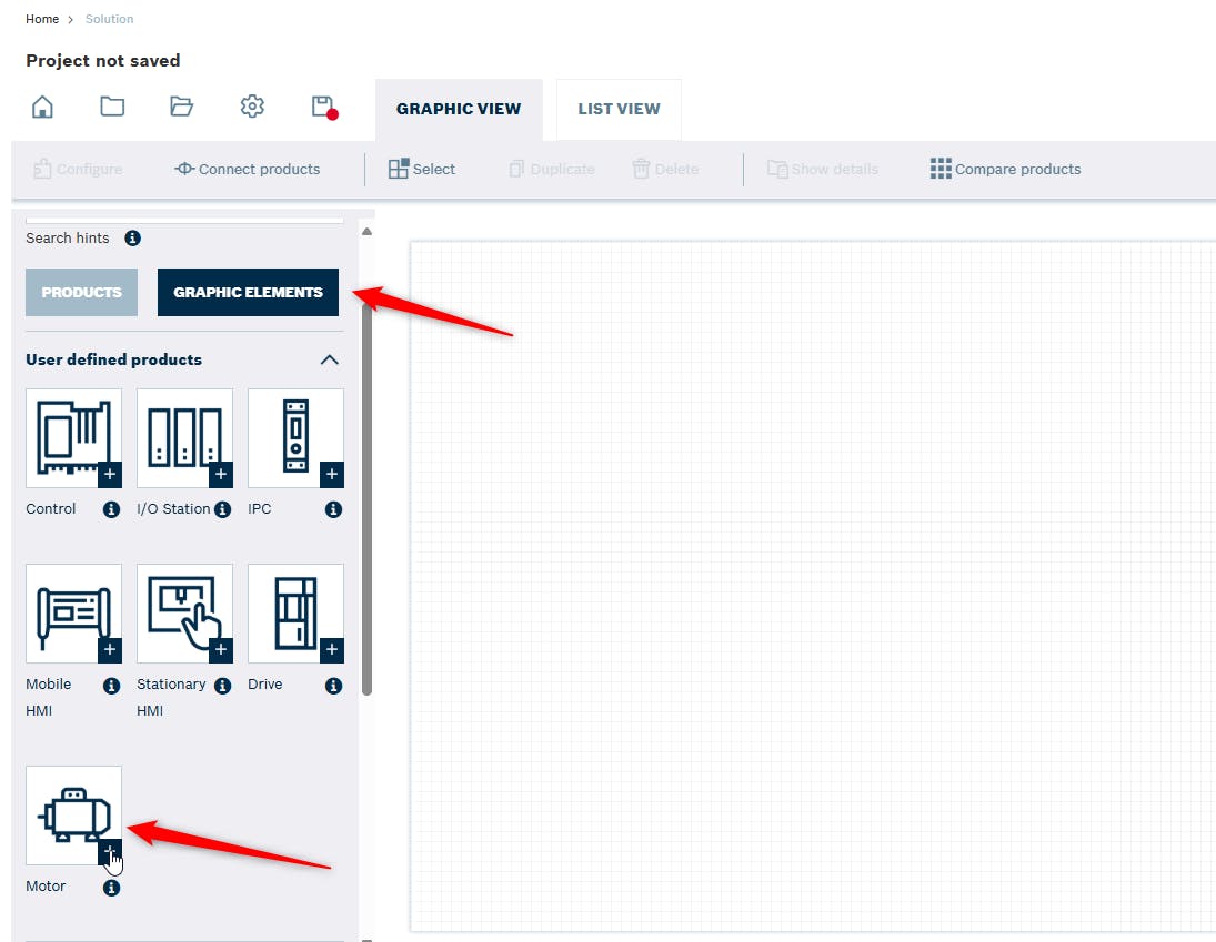

Step 1:
Under "Graphic Elements," look for the option to add generic components. In this example, we're adding a third-party motor."
Click: Grafic Elements

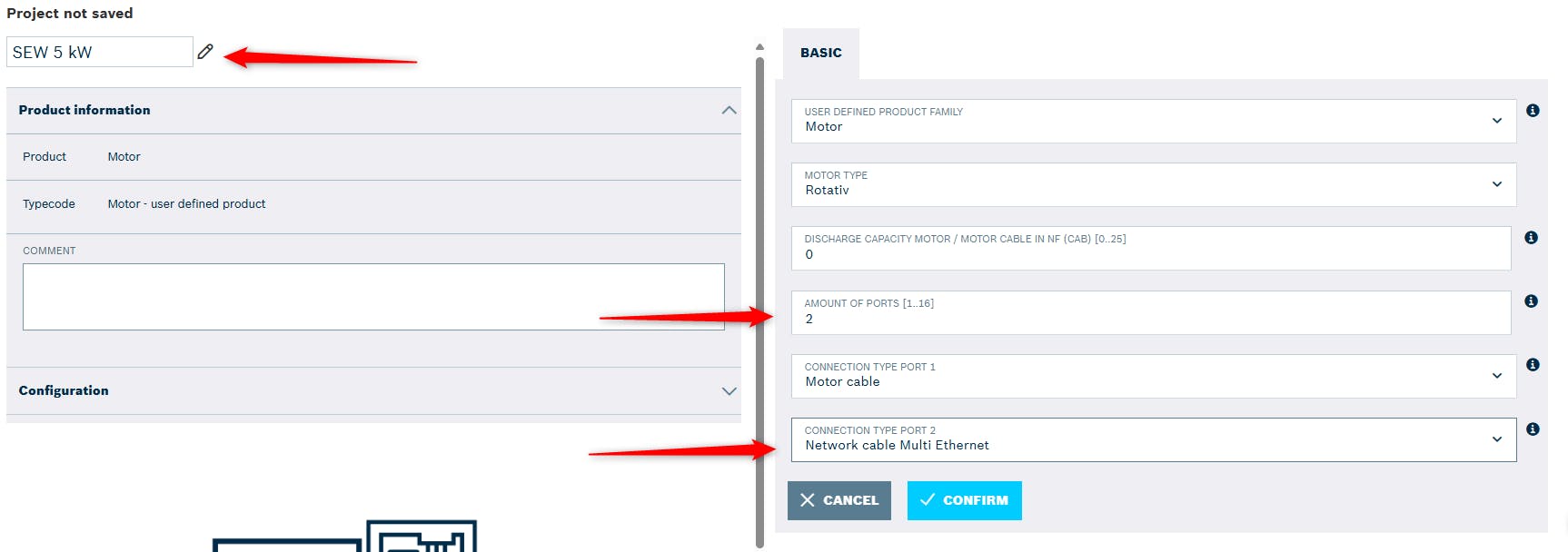

Step 2:
We rename it to "SEW 5 kW. There is a possibility to configure the connection ports. We change number of ports to 2, to add a additional Port. Then we choose the requested connection Type.
Change Amount

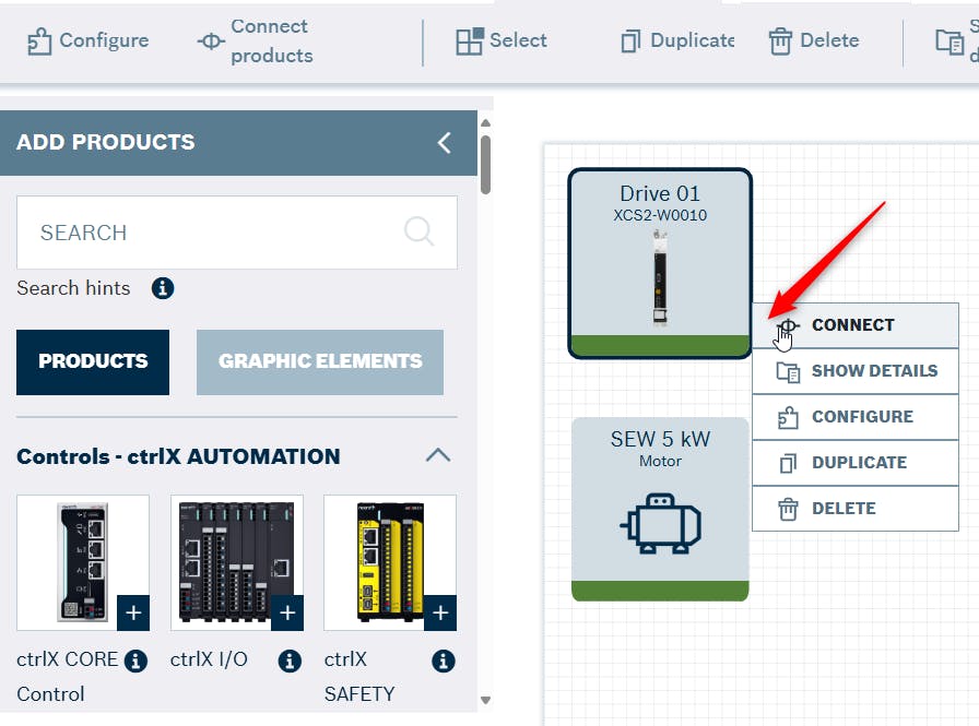

Step 3:
Connect the Device to each other by clicking the "..." and click to connect.
Click: Connect
