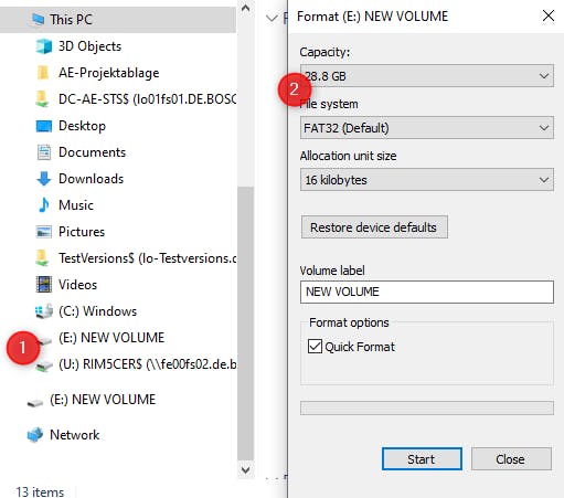

Step 1: Format the uSD as FAT32
Right click on the device (1) and then click on format. Be carefoul to choose the right formatting (2), which is FAT32.
FAT32 ctrlX

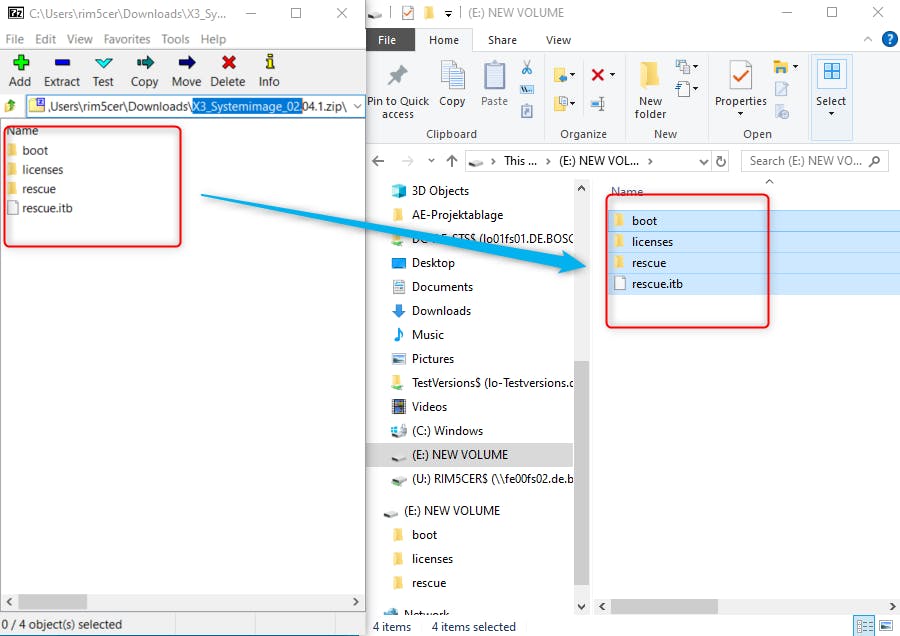

Step 2: Unzip the content and put it inside the ctrlX CORE
Unzip the content of the ".._Systemimage_Version.zip" inside the uSD, the result will be the following:
Created uSD

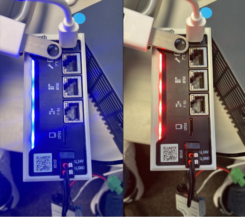

Remove the uSD and stick it inside the right slot, which is called CF01, and boot up the device. From the version 2.0 and above it is working also with a USB stick but it is better to use a uSD to be sure. The device will start blinking blue and red like this:
ctrlX Blue and Red
At the end the device will boot up clean and with standard Login and Password.
