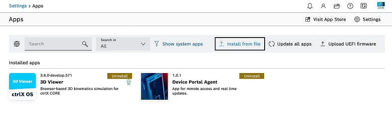

Install apps
  • Open your ctrlX OS Core device and navigate to Settings
  • In Settings click Apps
  • Click on Install from file and select the downloaded file to upload
Image from a CORE with system version 2.4.1. For other versions there might be sight differences.

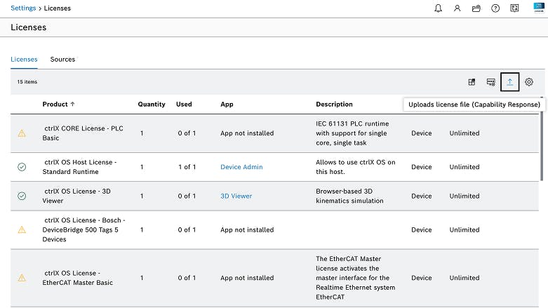

Install licenses
  • In Settings click on Licenses
  • Click on Upload license file (capability response) and select the downloaded file to complete the upload
