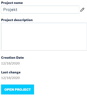

PROJECT NAME AND INFORMATION
Each project is given the initial name "Project" or "Projekt" according to the language setting. At the time of saving a project the user can change the name, later a change of the name can be done in the project management. For this purpose, the user clicks on the "Details" icon to display extended project information. In the input field "Project name" the project name can be changed. In the input field "Project description" further information can be entered by the user.

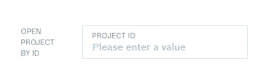

Opening another user's project is done by entering the corresponding ID in the "Open Project by ID" field, see below.
Text input field for opening a project via ID
Please note: a copy of this project will be created and opened with a new project ID. It is not possible to work on the same configuration project by several users.

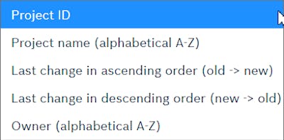

SORT OF LISTED PROJECTS
The sort order of the project list can be changed via the "Sort by" selection field. The following options are available:
