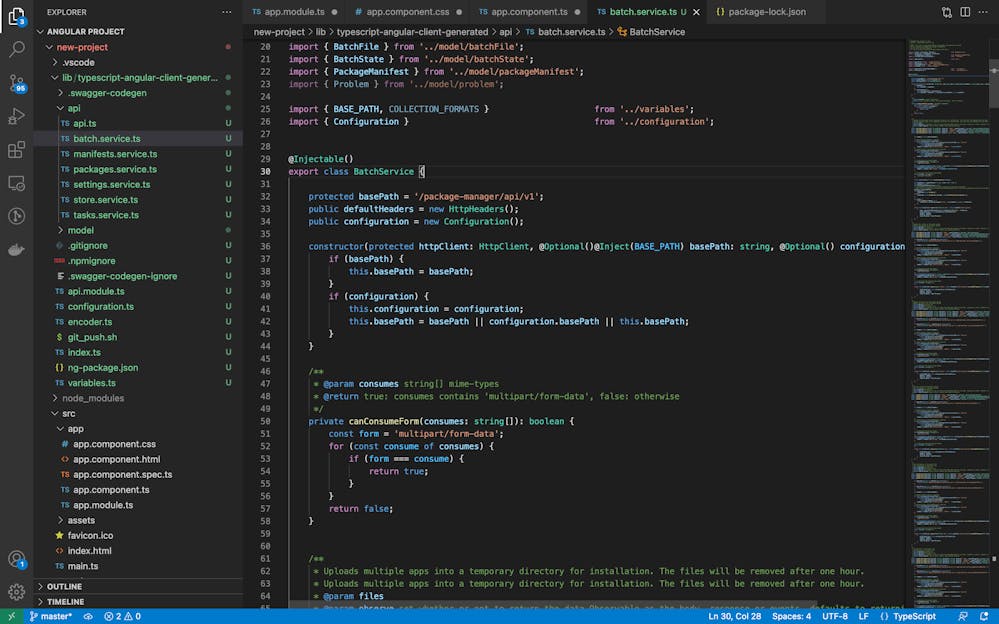

  1. On creating your Angular project, import the openApi generated library into your project. The import folder might vary based upon the project architecture. We here use a lib folder to store the libraries to store and import our self generated libraries.

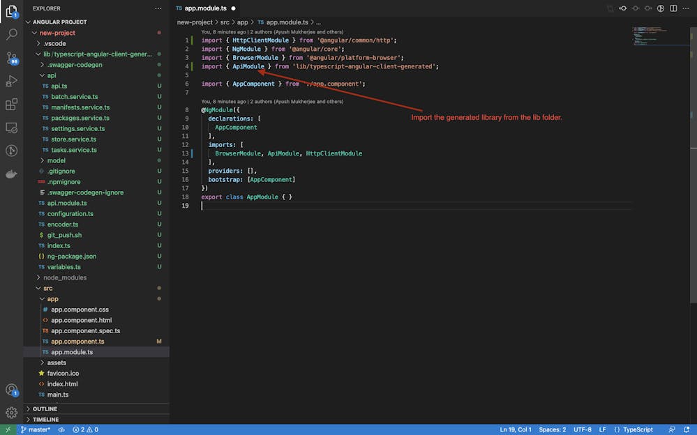

  2. On addition of library into the project, we add the path to the library in to our App.module.ts file as shown in the image below. After importing the File, we add the import variable ApiModule into imports array variable in @MyModule.
    Angular app.module.ts
  3. After addition of the library path, we will start working with the library as per our needs. To show an example, we here import BatchService into our component. To learn about the service usage, we refer to the service description in the OpenApi file of the generated library folder.
    Angular Import API library
    ctrlX BatchService API Description

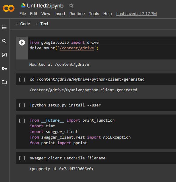

For the demonstration, we are using google colab.
  1. Upload the library file in the google drive and mount google drive in the notebook as shown in the image below.
    Google collab notebook demonstration
    import swagger_client
    python setup.py install --user
    from __future__ import print_function
    import time
    from swagger_client.rest import ApiException
    from pprint import pprint
    configuration = swagger_client.Configuration()
    configuration.access_token = 'YOUR_ACCESS_TOKEN'

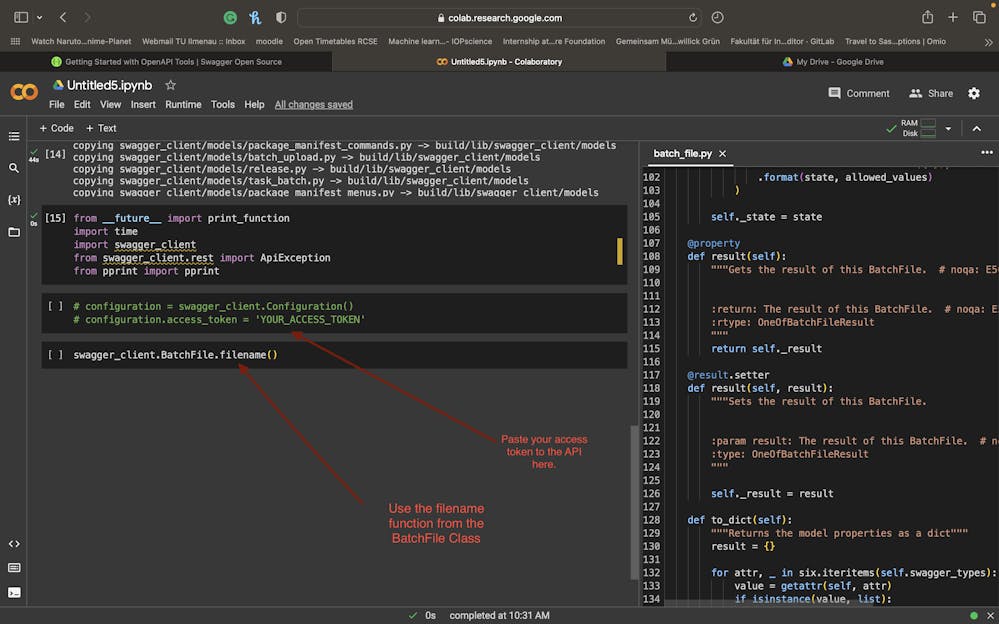

  2. We are importing the Swagger client into the notebook which we use to access the API classes and their functionality.
    Swagger API library usage demonstration
  3. Here now we simply use the required class and its function using the '.' operator.
    Sample Python Scripts to run
As we can see, generating OpenApi libraries help in integration of the ctrlX WORKS Apis considerably, without the need to make individual HTTP requests to the server.
