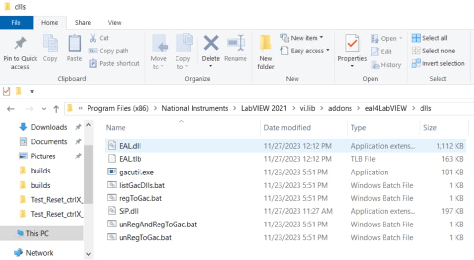

Make sure that the eal4LabVIEW library is properly installed. The recommended way to do this is by using LabVIEW’s VI Package Manager (VIPM), a tool designed specifically to find, download, and manage LabVIEW add-ons and libraries.
Once the installation is complete, a corresponding folder will be created within the National Instruments installation directory. This folder will contain two important files: EAL.dll and SIP.dll.
These DLL files (Dynamic Link Libraries) are essential for the eal4LabVIEW library to function correctly. You will need to manually add both files to your LabVIEW project to ensure full integration and functionality.
Figure 1: Directory structure showing the default location of EAL.dll and SIP.dll files in the National Instruments

Note 1: Make sure to add the EAL.dll and SIP.dll files from the National Instruments installation folder, as shown in Figure 1. Using versions from other locations will not work.

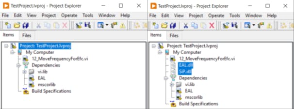

Figure 2: Project structure with and without the DLLs added

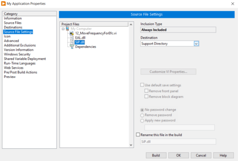

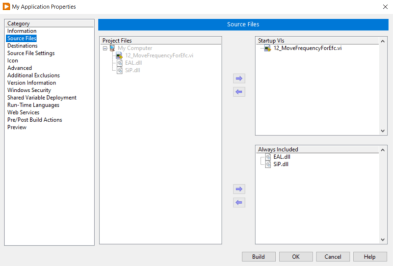

Figure 3: Adding the DLLs to the build

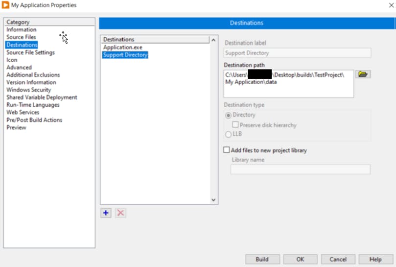

Figure 4: Default path for the support directory

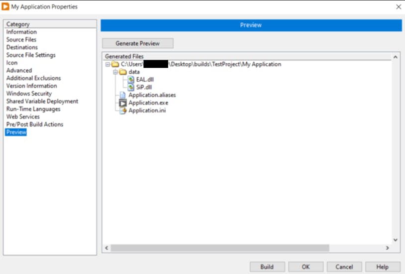

Figure 6: Structure of the built project

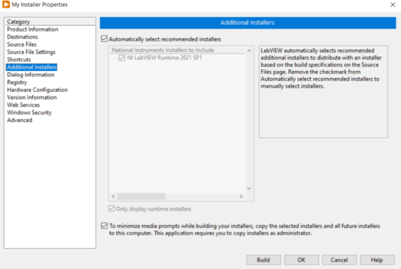

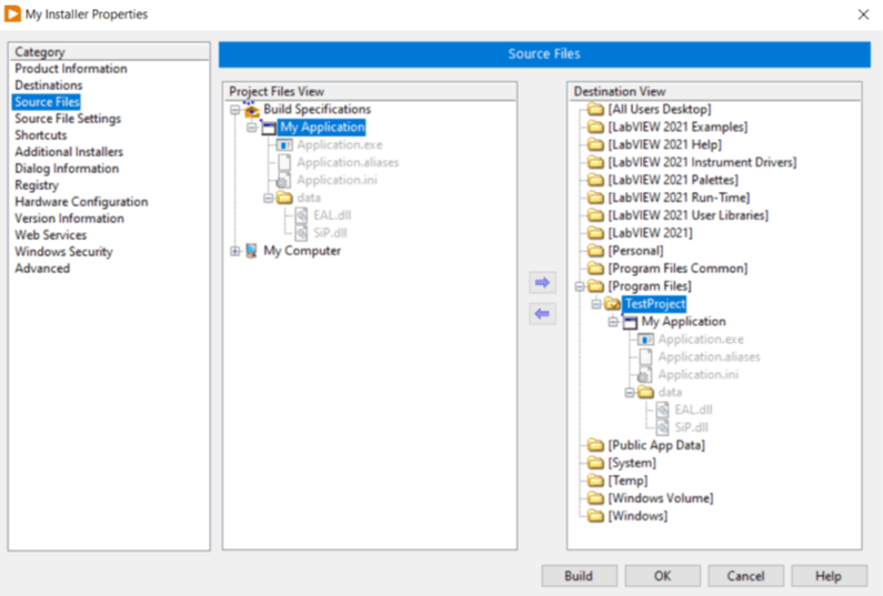

Figure 7: Adding the components to the Installer
Figure 8: Library files included in the installer
