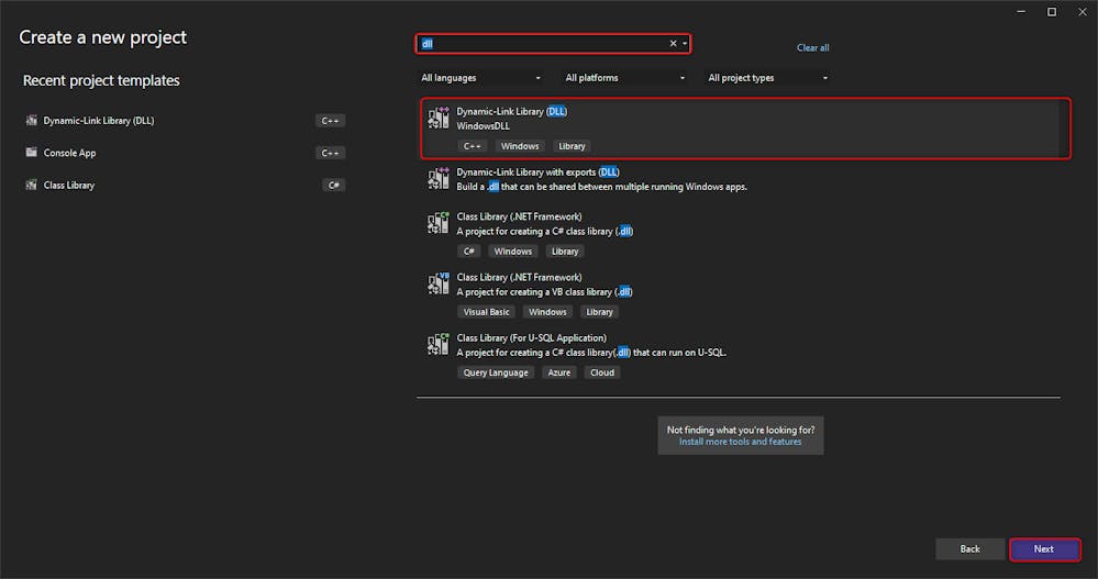

Step 1: Create a Dynamic-Link Library project in Visual Studio
Open a Visual Studio and click on create a new project as shown in the picture below.
Create a new project
Now you can see the templates library for creating a new project. In the search bar type in "DLL" and choose the ICON shown in the picture below.
Choose DLL Project for C++
After clicking on the Next button, you will encounter configure window. There you can give your project a relevant name and click on Create. Now your project window should look like in the picture below.
DLL project window

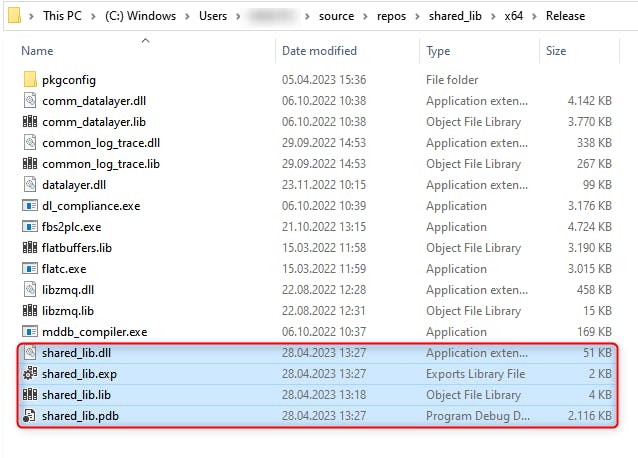

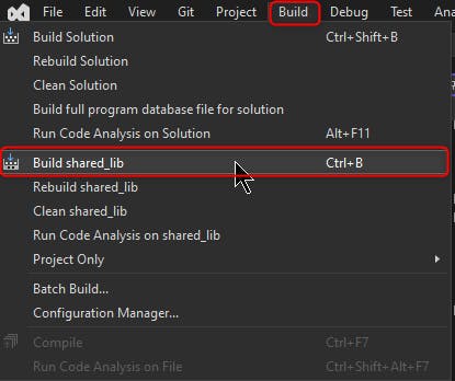

Save this project and build DLL in Release mode by clicking on "Menubar-->build -->build Shared_Lib" or pressing ctrl+B.
Build DLL

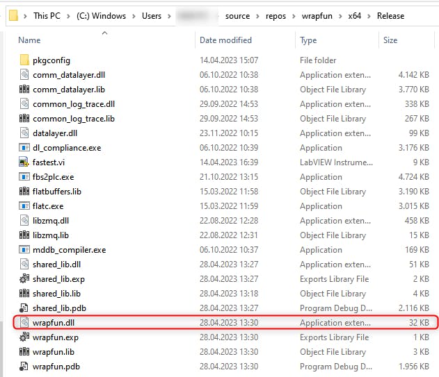

You can realise 4 new files in the dll project directory of your File Explorer as shown below.
Release folder
Remember the location of these files because we will copy them as dependencies for wrapper DLL.

At the time of the configuration dependencies for this project we need to add one more dependency for DLL that we have created in Step 2. Via linking the .lib file of that project and copying 4 files that we generated in the release folder earlier.
Now build this project in release mode and you will see the .dll file created in the directory of file explorer. In my case, I have named the project "wrapfun".
Wrapper DLL

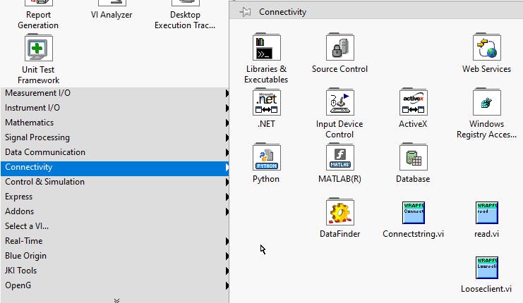

If you do not want to use call library function then one can also directly import dll function inside LabVIEW via "tools-->import-->shared library (.dll).  It will generate vis for each function, which you also make accessible in pallet. But for call Library function vi, first open LabVIEW and create a new VI.
Import vis in pallet

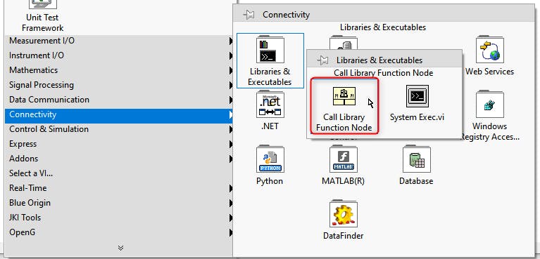

In this VI go to the block diagram window and right-click on the whiteboard and the Function dialogue box will pop up. Go to Connectivity --> Libraries & Executables --> Call Library Function Node.
Call library function node

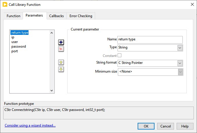

Double click on this node and the configuration dialogue box for the call library function will open. There you can define the path for wrapper DLL and import the function from the drop-down as shown in the picture below.
Configure dialogue box for CLF
Before hitting the ok button go to the parameters tab and there you have to create and define the input-output variables of the function that you have chosen as can be seen in the picture below.
Configuration of variables
Now click on ok and your function is ready to use inside LabVIEW. You can import each useful function using the "Call library function node"

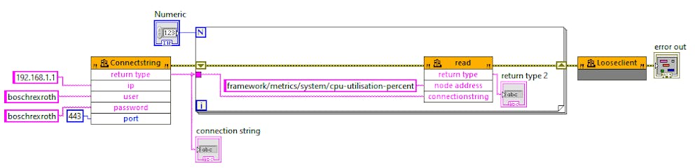

Step 5: Read the data layer node
To read the datalayer node from ctrlX CORE, you have to create a flow of call library functions first as can be seen in the picture below.
Labview flow
Or with the help of imported dll in tools, it will look something like below.
Imported vi connection

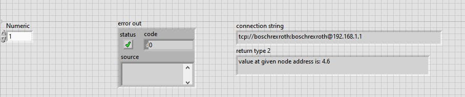

Now click on the "run" button on the top-left of the block diagram window and view on your front panel as shown in picture below.
Front panel
This how-to example is just for reading a single datalayer node, depending on your use case further development is possible 🙂
