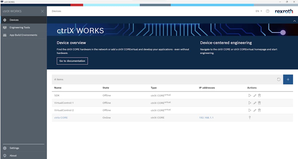

Switch on the Kassow RC, ctrlX PLC, and a PC with ctrlX PLC Engineering installed. The PLC should be blinking blue. Connect to the ctrlX CORE using ctrlX WORKS. The PLC should start blinking red.
ctrlX Works Dashboard

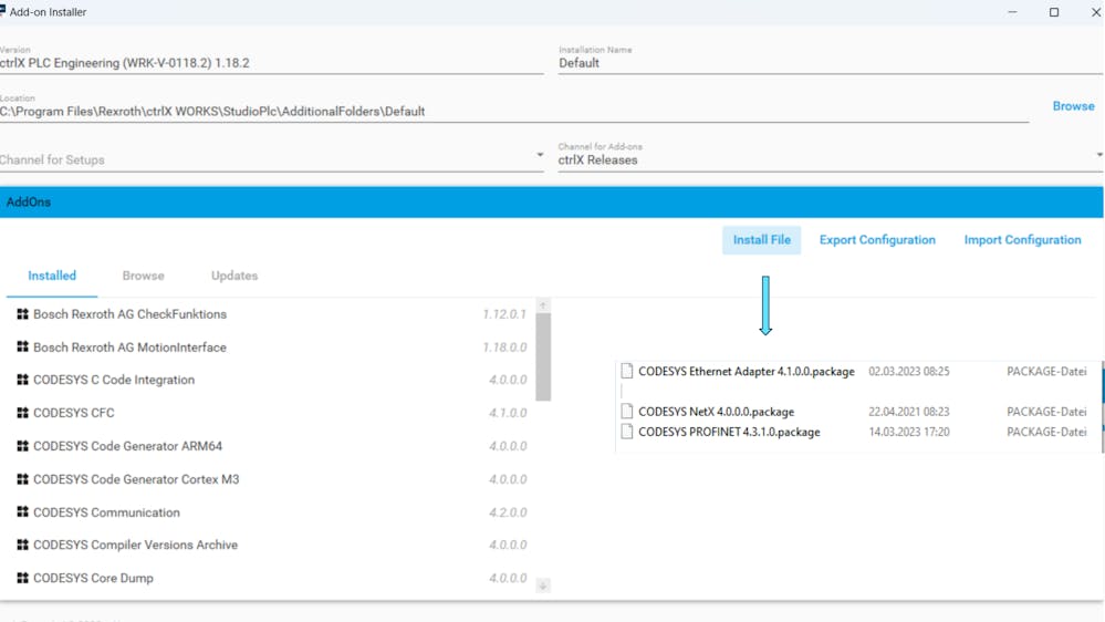

When establishing the initial connection of the Profinet fieldbus to the ctrlX CORE, it is essential to initialize the ctrlX as a fieldbus device. To accomplish this, update the PLC Engineering IDE with the necessary add-ons, particularly the Fieldbus Ethernet IP and PROFINET Codesys drivers:
  • CODESYS Ethernet Adapter package (4.2.0 or higher)
  • CODESYS NetX package (4.0.0 or higher)
  • CODESYS PROFINET package (4.4.0 or higher)
For a comprehensive guide on downloading and installing these dependencies, please refer to the ctrlX support pages.

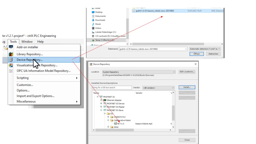

Note: If you are not using the template and creating your own project, load the GSDML file "gsdml-v2.35-kassow_robots-axxx-20210602.xml" (included in the enclosed zip file).
Load the GSDML file, build the code and deploy it on the ctrlX PLC
Build the code and deploy it on the ctrlX PLC Engineering. The Profinet master (ctrlX) should now be active, allowing you to attempt connecting the Kassow RC as its IO Device counterpart.

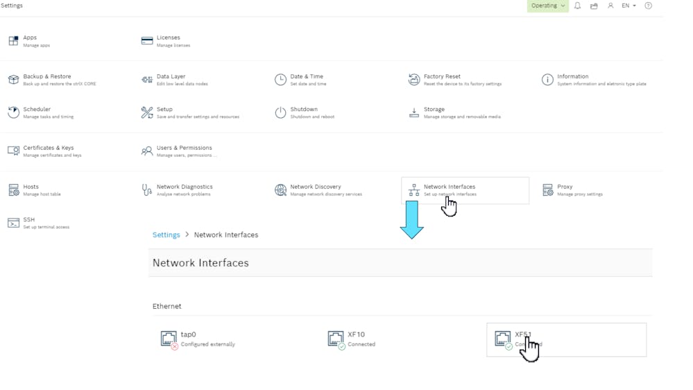

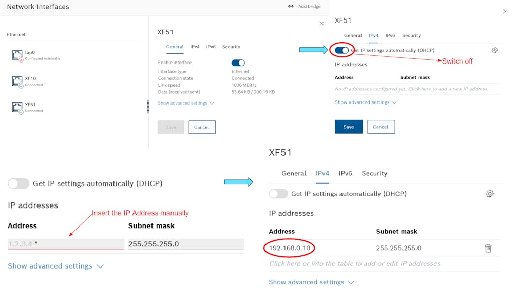

We use the Network Interface XF51 for the profinet connection as mentioned before. For this template, we use the IP address 192.168.0.10. You can set that in ctrlX CORE Settings > Network Interfaces
Adjustments in ctrlX CORE Settings > Network Interfaces
Choose XF51 and set the IP address this way.

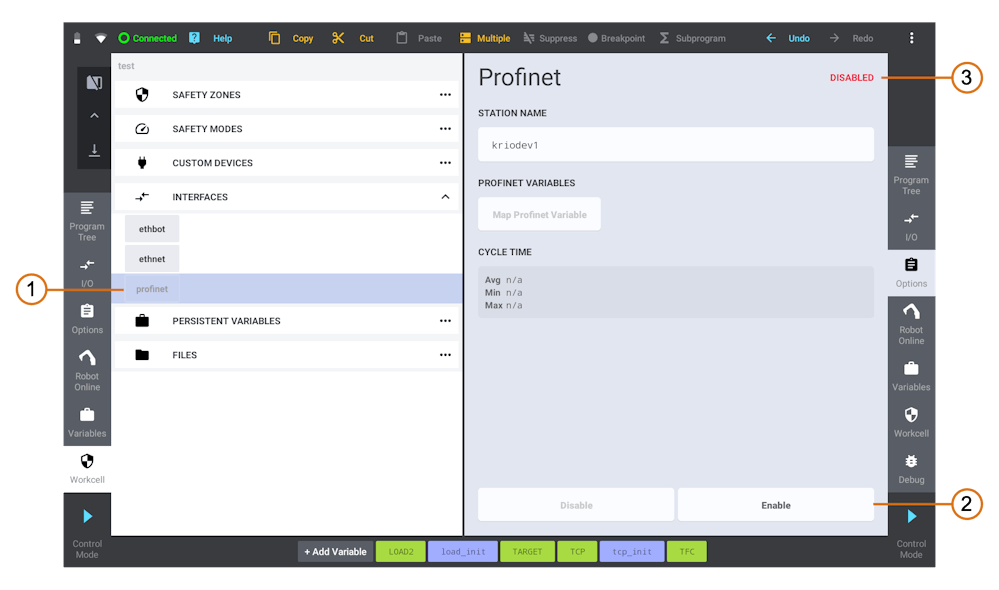

Enabling Profinet on the Kassow

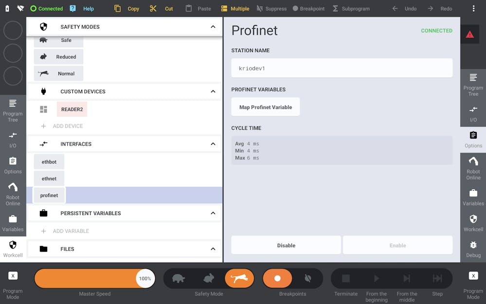

With the fieldbus successfully running on your master node, the next step involves setting it up on the robot controller as well. To achieve this, utilize the teach pendant UI. Navigate to the Workcell/Interfaces section and select the "profinet" item.
Note: If the Profinet interface is not available, it is likely that your robot is not equipped with the optional Profinet HW (please confirm with Kassow Robots tech support if you are uncertain).
Profinet Activation
Click "Enable" to activate the Profinet and wait until the status is changed to "Connected.
By now, the teachpendant should be showing connected in the top left corner, indicating that the teachpendant is communicating with the robot. 

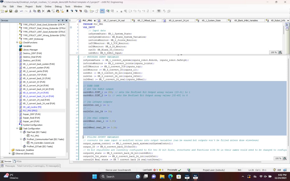

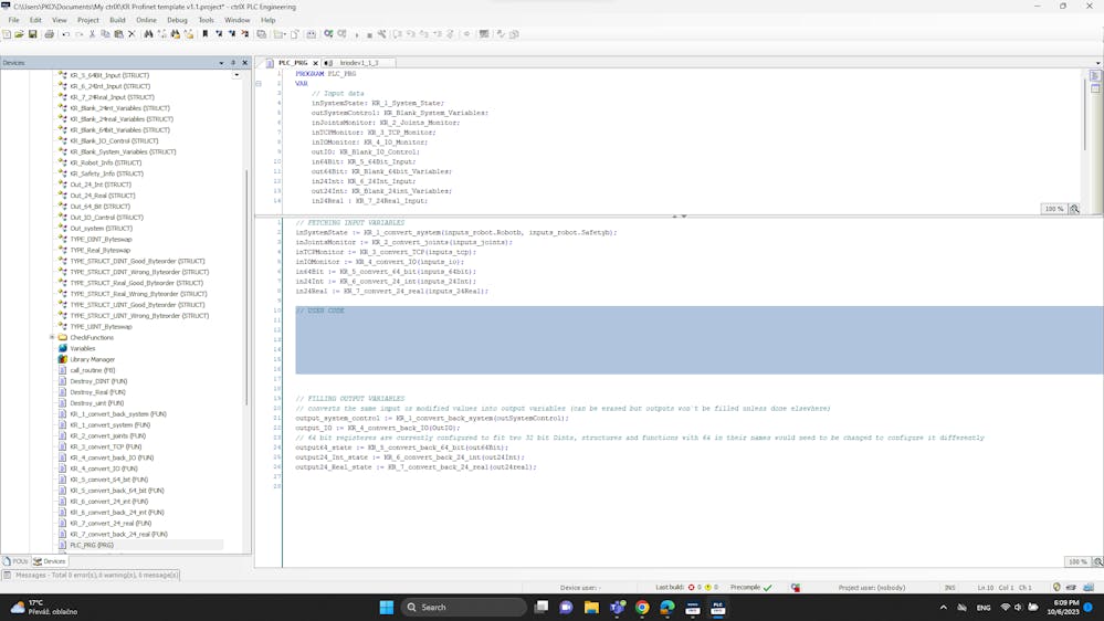

Now, we return to the PLC Engineering IDE with the "KR Profinet template v1.2.1.project" project open.
Every KR template project contains all necessary types and functions for converting between the fieldbus and internal program representations. The primary user code is located within the PLC_PRG program, with pre-defined local variables reflecting 12 KR Profinet modules. In the "FETCHING INPUT VARIABLES" preamble, the input fieldbus variables are updated, followed by the "USER CODE" section. This is where your PLC code logic, combining fieldbus data reading and writing, should be placed. The final section, "FILLING OUT VARIABLES" provides the necessary conversion to the fieldbus structure.
PLC_PRG user code
The "USER CODE" section essentially establishes the boundaries for your PLC code. Here, you should access the RC Profinet data and call all your dedicated functions constituting your PLC program. Leave the preamble and final section intact.
For illustration purposes, you can easily modify user slots 10, 11, and 12 of the KR Profinet frame by accessing variables out64Bit, out24Int, out24Real as follows:

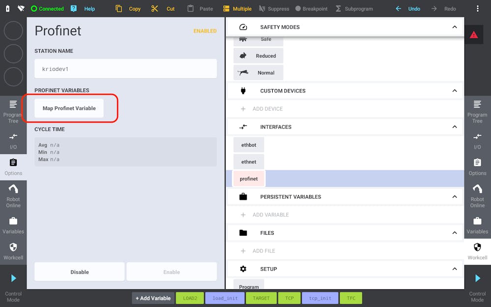

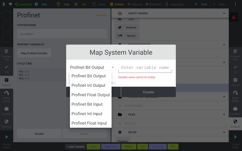

To do this, navigate to the Workcell/Profinet option panel and inside that, click the 'Map Profinet Variable' button.
Map Profinet variable button
This action opens up a variable map dialog where you can select the Profinet IO slot. Give it a name and click "Create". This will generate an outlet array within the RC user variable, providing access to the Profinet IO user slot for reading or writing:
Profinet IO User array mapping
There are six user slots defined in the KR PROFINET IO fieldbus specifically designated for user data exchange. For more details check the USER INPUTS AND OUTPUTS table in the Appendix of this article.

Now, you can attempt to assign values to the KR PROFINET IO slots using predefined output variables (PLC -> RC). Utilize the same empty 'KR Profinet template v1.2.project' template and add the following lines into the "USER CODE" section of the PLC_PRG program:
// USER CODE
// set 64 plc output variables
out64Bit.DINT_1 := 255;
// 24x integer outputs
out24Int.in1 := 1;
out24Int.in24 := 24;
// 24x real outputs
out24Real.real_1 := 3.0;
out24Real.real_24 := 3.24;

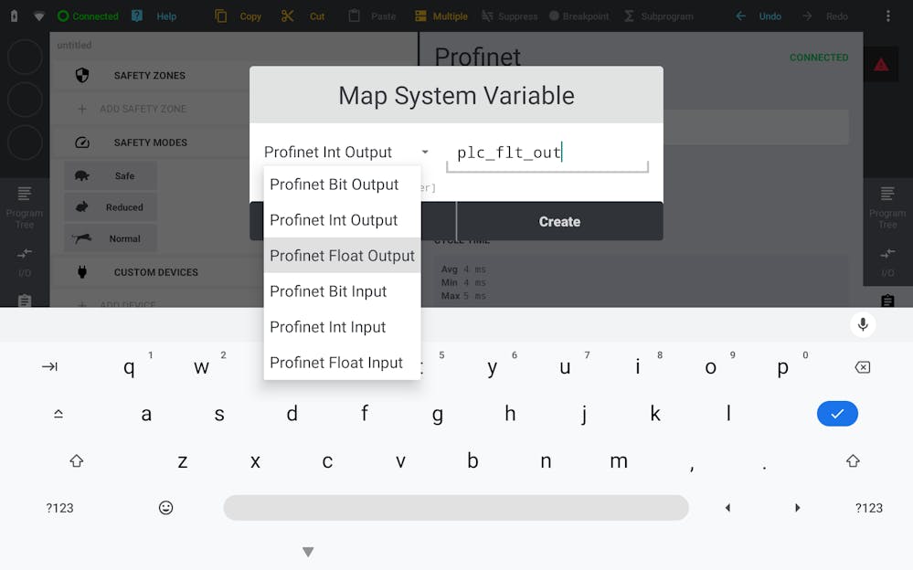

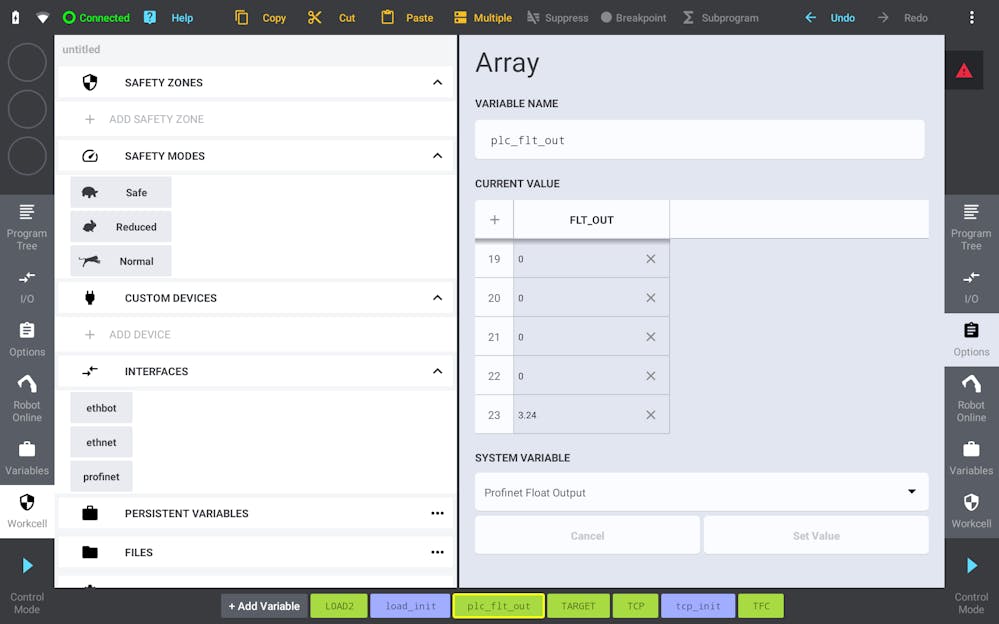

In the RC user interface, create the mapping to provide access to the Profinet Float output array:
Profinet mapping
To observe the assigned outputs provided by the ctrlX PLC program, click "Login" at the top of the ctrlX PLC Engineering tool and use the "Play" button to execute the PLC code. This action will compile the code, load it into the PLC, and set it in motion. In the brief moment after ctrlX runs the code, the mapped Profinet array block (Float Outputs) will display transferred values:
Profinet Float Outputs array

out64Bit
PLC -> Robot (Profinet Bit Output)
The PLC outputs 64 bit register for user data.The out64Bit variable consists of two 32 bit entries, DINT_1 and DINT_2:
out64Bit.DINT_1 -> Profinet Bit Output [0-31]
out64Bit.DINT_2 -> Profinet Bit Output [32-63]
The mapped array represents bit values in the net order, i.e. the MSB of DINT_1 is stored at index 0, while the LSB of DINT_1 at 31.  Similarly, the MSB of DINT_2 is at index 32 and LSB of DINT_1 at 63.
out24Int
PLC -> Robot (Profinet Int Output)
The PLC outputs 24 integer values (32-bit) for user data. When assigning a value to the PLC's int_XX output item, it becomes accessible in the RC through the system array:
out24Int.int_1 -> Profinet Int Output[0]
out24Int.int_24 -> Profinet Int Output[23]
out24Real
PLC -> Robot (Profinet Float Output)
The PLC outputs 24 floating point values for user data. When assigning a value to the PLC's real_XX output item, it becomes accessible in the RC through the system array:
out24Real.real_1 -> Profinet Float Output[0]
out24Real.real_24 -> Profinet Float Output[23]
in64Bit
Robot -> PLC (Profinet Bit Input)
The PLC inputs 64 bit register for user data. The in64Bit variable consists of two 32 bit entries, DINT_1 and DINT_2:
Profinet Bit Input [0-31] -> in64Bit.DINT_1
Profinet Bit Input [32-63] ->
in64Bit.DINT_2
in24Int
Robot -> PLC (Profinet Int Input)
The PLC inputs 24x integer values (32-bit) for user data. When assigning a value to the RC's Profinet Input array index, it becomes accessible in the PLC in24Int.int_XX input item:
Profinet Int Input[0] -> in24Int.int_1
Profinet Int Input[23] ->
in24Int.int_24
in24Real
Robot -> PLC (Profinet Float Input)
The PLC inputs 24x floating point values for user data. When assigning a value to the RC's Profinet Input array index, it becomes accessible in the PLC in24Real.real_XX input item:
Profinet Float Input[0] -> in24Real.real_1
Profinet Float Input[23] ->
in24Real.real_24
