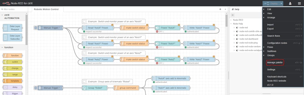

  1. Inside the Node-RED flow editor, select "Manage palette" on the sidebar menu.
    Manage palette

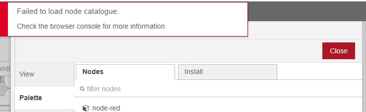

  2. In this example, I am using a virtual CORE running on the same system as the client browser. You'll see this warning message when you open the palette manager without an internet connection.
    Failed to load nodes error

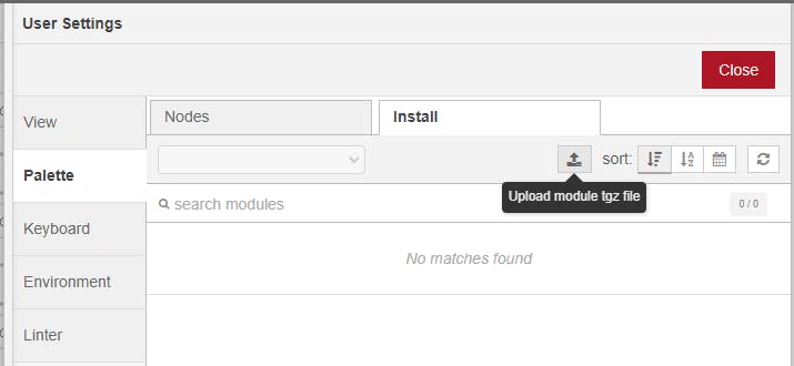

  3. Select "Install" and then the "Upload module tgz file" button. Browse to the file location and select the bundled module.
    Upload module
  4. The module should install successfully, along with all dependencies.
