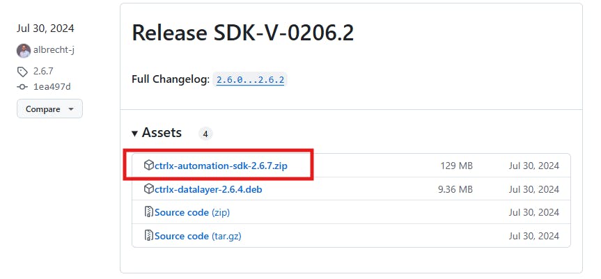

  1. Download the released SDK compressed package from GitHub and decompress it. For example, ctrlx-automation-sdk-2.6.7.zip
    Released ctrlx-automation-sdk on github

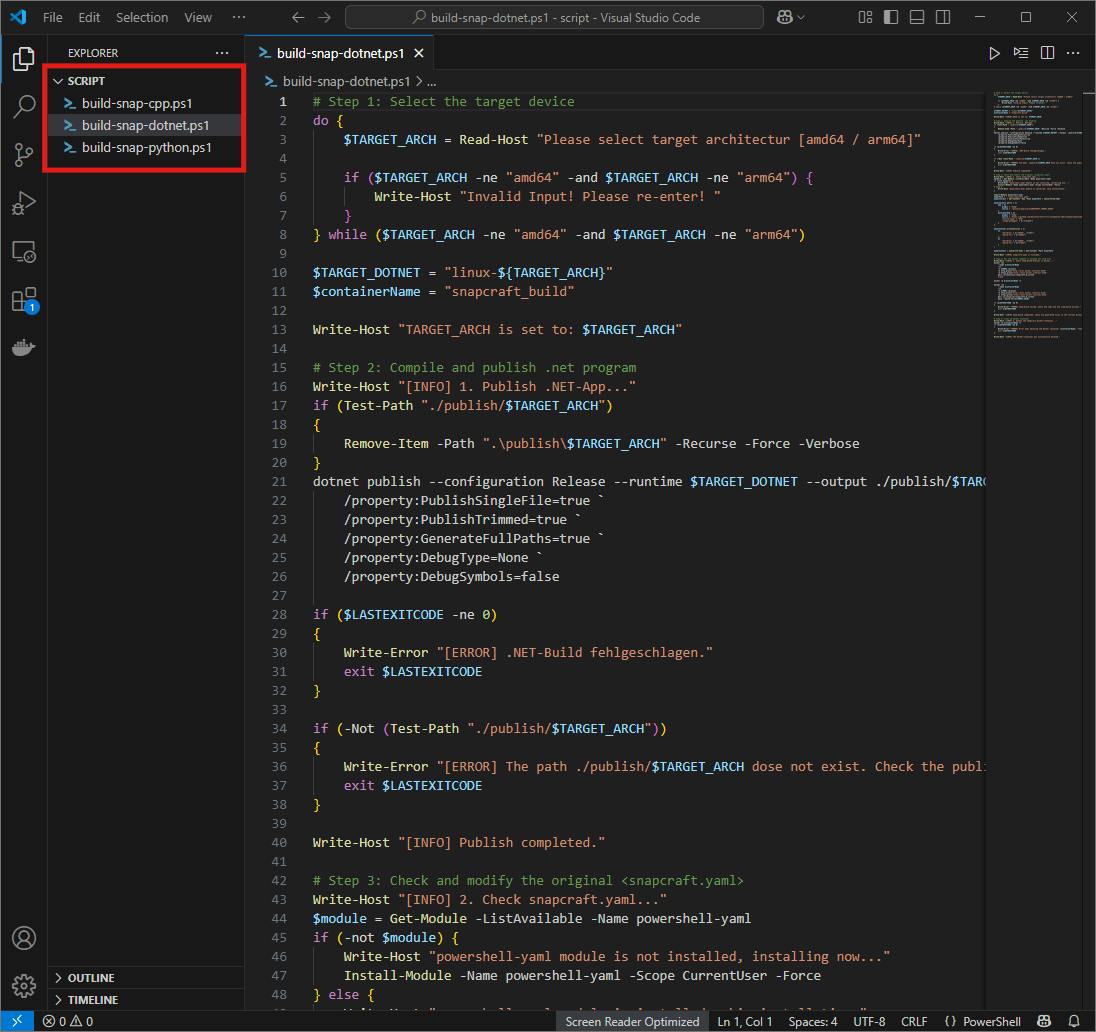

  2. Download the snap build script compressed package and decompress it. There are scripts in three different languages (.net, python and C++) ​​for Windows.
    Script overview

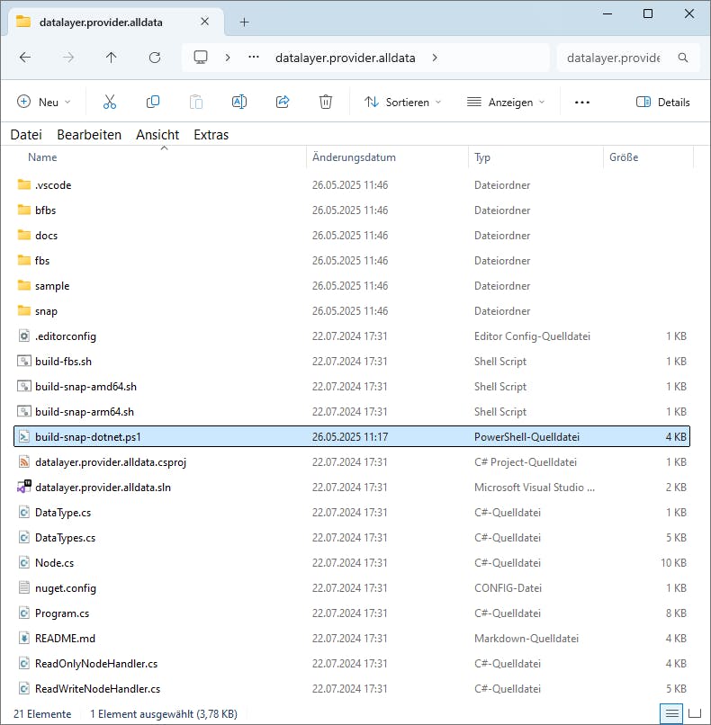

  3. Copy the script to the corresponding sample project. For example, you want to package a .net sample project datalayer.provider.alldata under the Windows system. Then you can copy the script in this way: Win\Net\build-snap-dotnet.ps1 -> ctrlx-automation-sdk\samples-net\datalayer.provider.alldata
    Copy the script to the project root directory

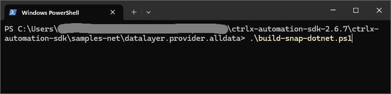

  5. Open a command window in the project root. Then run the commend:
    .\build-snap-dotnet.ps1
    Run the script in the command window

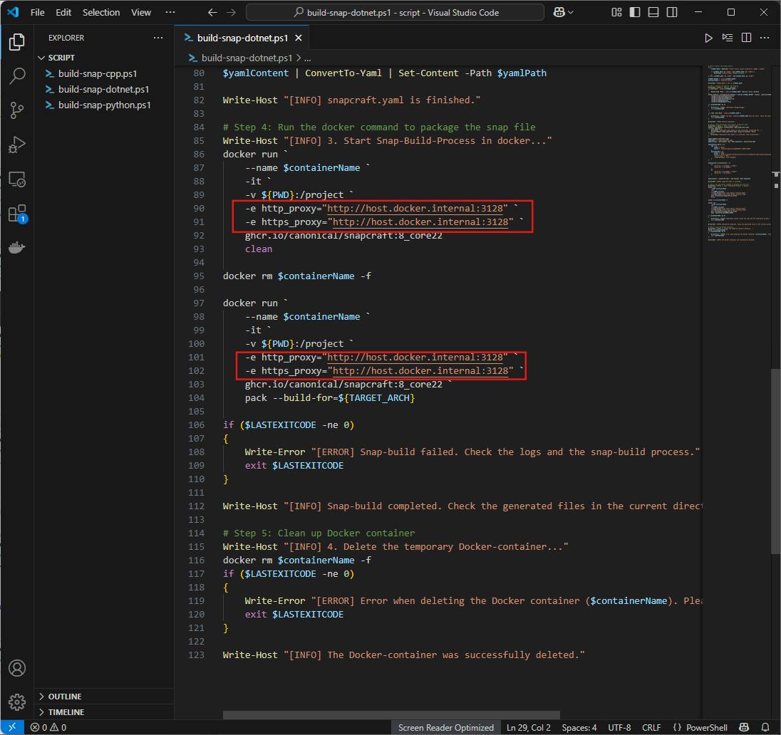

    Notice: If you are not using a proxy, please remove these lines from the script.
    -e http_proxy="http://host.docker.internal:3128" `
    -e https_proxy="http://host.docker.internal:3128" `
    Content that needs to be deleted if without proxy

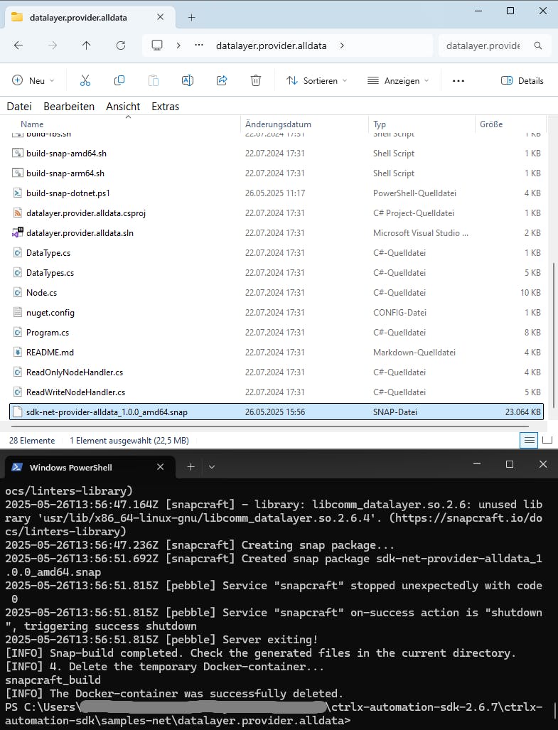

    If you end up seeing something like this, congratulations! You can install the snap-App on your ctrlX CORE now.
    The result of successful script execution
