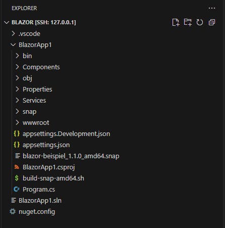

  1. Open the directory in the App Build Environments: ~/ctrlx-automation-sdk/samples-net/
  2. Create a new folder Blazor as the root directory of the project. The original project structure is as follows.

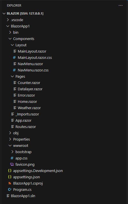

  11. Copy the snap folder and build-snap-arm64.sh script in the attachment to the ./BlazorApp1 directory to package snap files. The final project structure is as follows
    Modified project structure

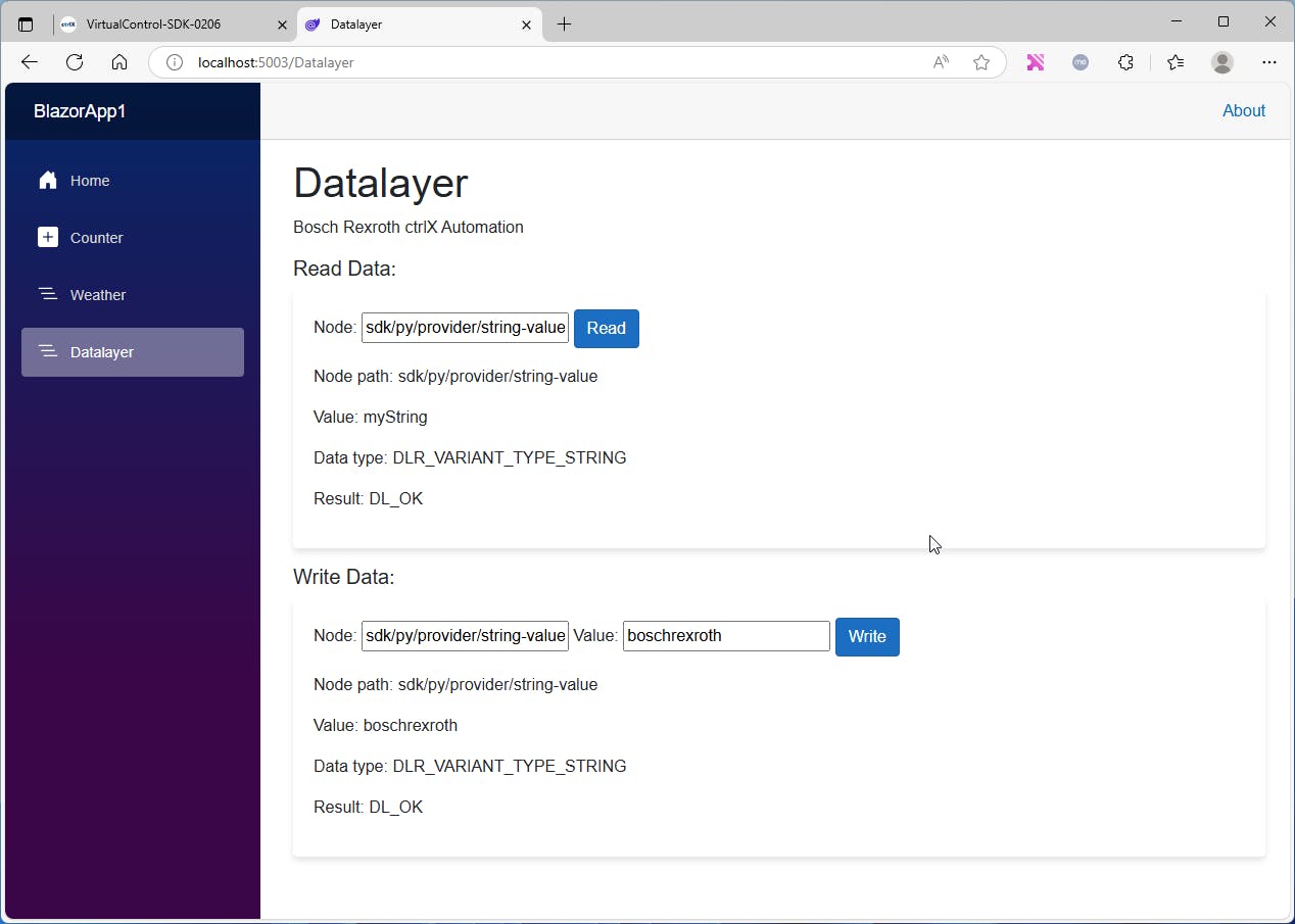

  12. Run the build-snap-arm64.sh script in terminal and install the snap on your Virtual Core. You can read and write variables in a specified node on the “Datalayer” page.
    Blazor Web App - Datalayer page
