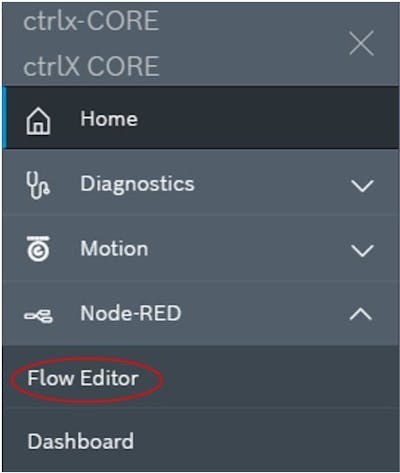

  1. Open the Node-RED App using the ctrlX Works interface.

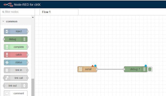

  2. In the Node-RED dashboard, the nodes that can be added are visible on the left-hand side.
    For the realisation of the project we need to add a "serial in" and a "debug" node. Then the nodes are connected to each other.

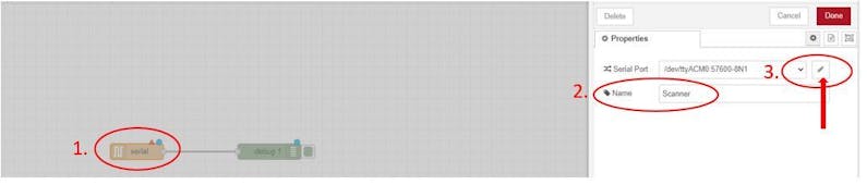

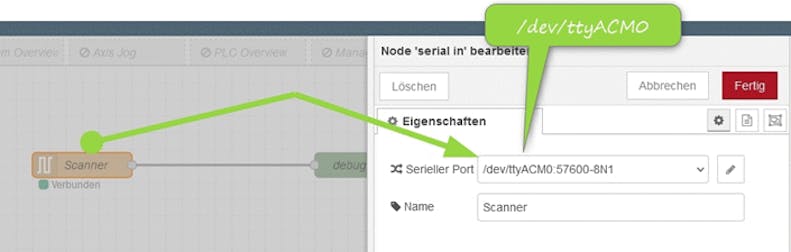

  3. Then double-click on the "serial in" node and rename it to "Scanner".
    Then define the serial port.
  4.  Change the port as follows and accept it:

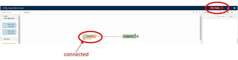

  5. Check if the "Scanner Node" is connected (when the green light is on). Then execute the Node-RED Flow by pressing the "Deploy" button. From now on, the scanner is online and you can scan.

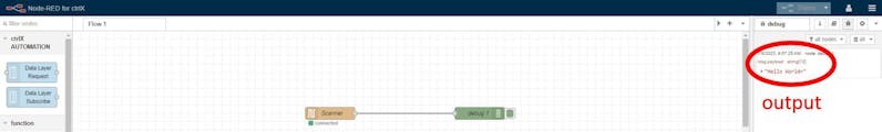

  6.  Now it is possible to read the barcode using the barcode scanner. To do this, we read in the example barcode "Hello World" from the chapter "Scanner Configuration". It can be seen that the interpretation of the barcode is now displayed in Node-RED:

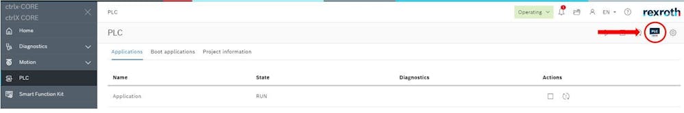

  1. Open the PLC App using the ctrlX Works interface.

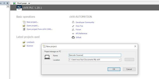

  2. When the PLC programme has opened, create a new project. Make sure that the PLC app is connected to the ctrlX CORE.

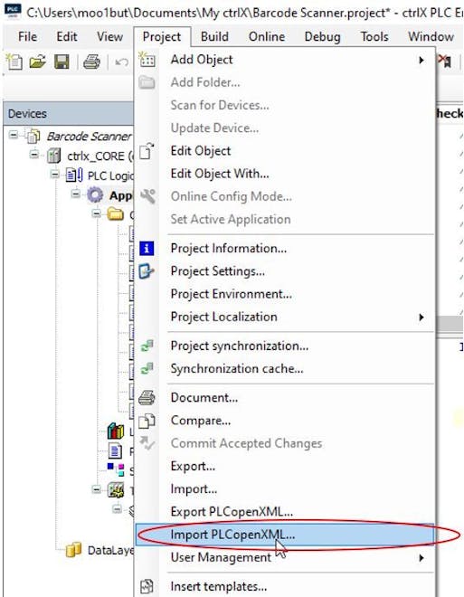

  3. Download the PRG_Barcode_Scanner.xml file attached to this How-To.
  4. Import the file PRG_Barcode_Scanner.xml into the PLC App.

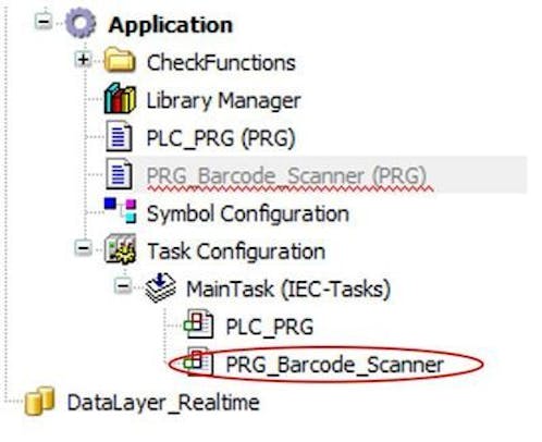

  5. Drag the program "PRG_Barcode_Scanner (PRG)" from "Application" into the "Task Configuration" of the PLC App.

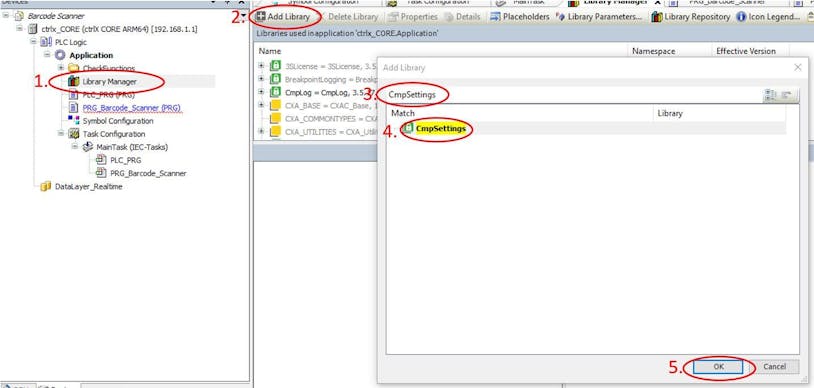

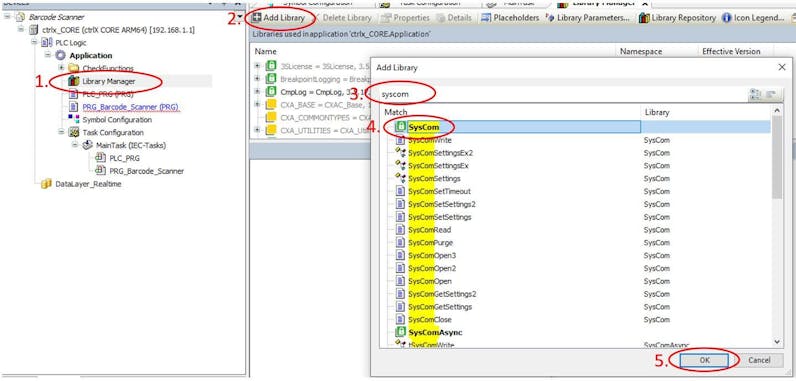

  6. Add the "SysCom" library. To do this, double-click on "Library Manager", then click on "Add Library" and use the search function to find and add the "SysCom" library.
  7. Repeat the process and add the library "CmpSettings".

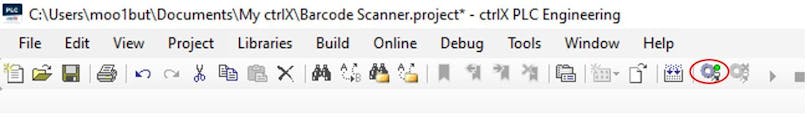

  8. Generate the code of the programme. Check that there are no error messages. Otherwise, correct the error messages.

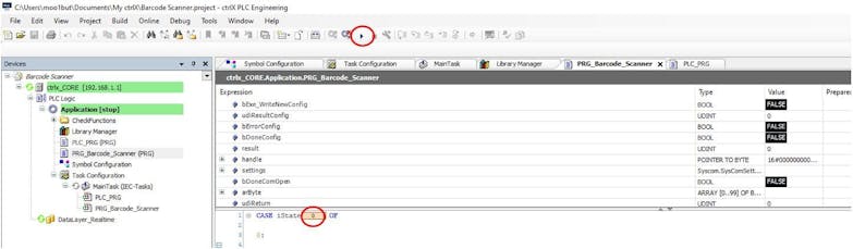

  9. Press the "Login" button.
  10. After logging in, check that the "iState" in the programme corresponds to "0". Then press the "Start" button.

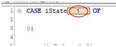

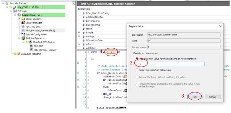

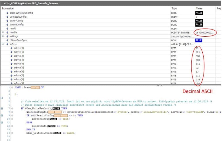

  14. In the PRG_Barcode_Scanner programme, change the "iState" from 0 to 1. To do this, double-click on the red box next to "iState". Then a new window opens and replace the 0 with a 1. Then accept this with "OK".

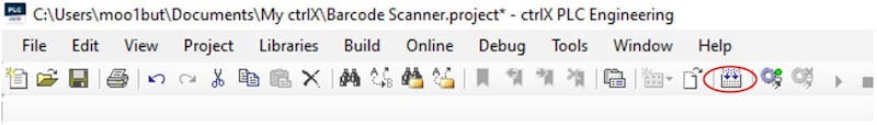

  15. Press the key combination "Ctrl" + "F7" to write the values online.
  16.  Press the "Start" button to run the program.
  17. Now it is possible to read the barcode using the barcode scanner. To do this, we read in the example barcode "Hello World" from the chapter "Scanner Configuration".
    It can be seen that it displays the barcode in the PLC as decimal - ASCII:
