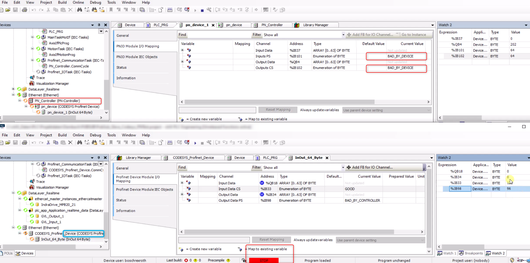

Emulation the S7 with another ctrlX-PLC running the Codesys PN-Scanner Stack reacts different. Start and Stop of the PN Device is possible. The PN Controller detects the "inactive/unavailable/passive" PN-Device and labels the Communication-state with Bad-by-Device instead of Good.

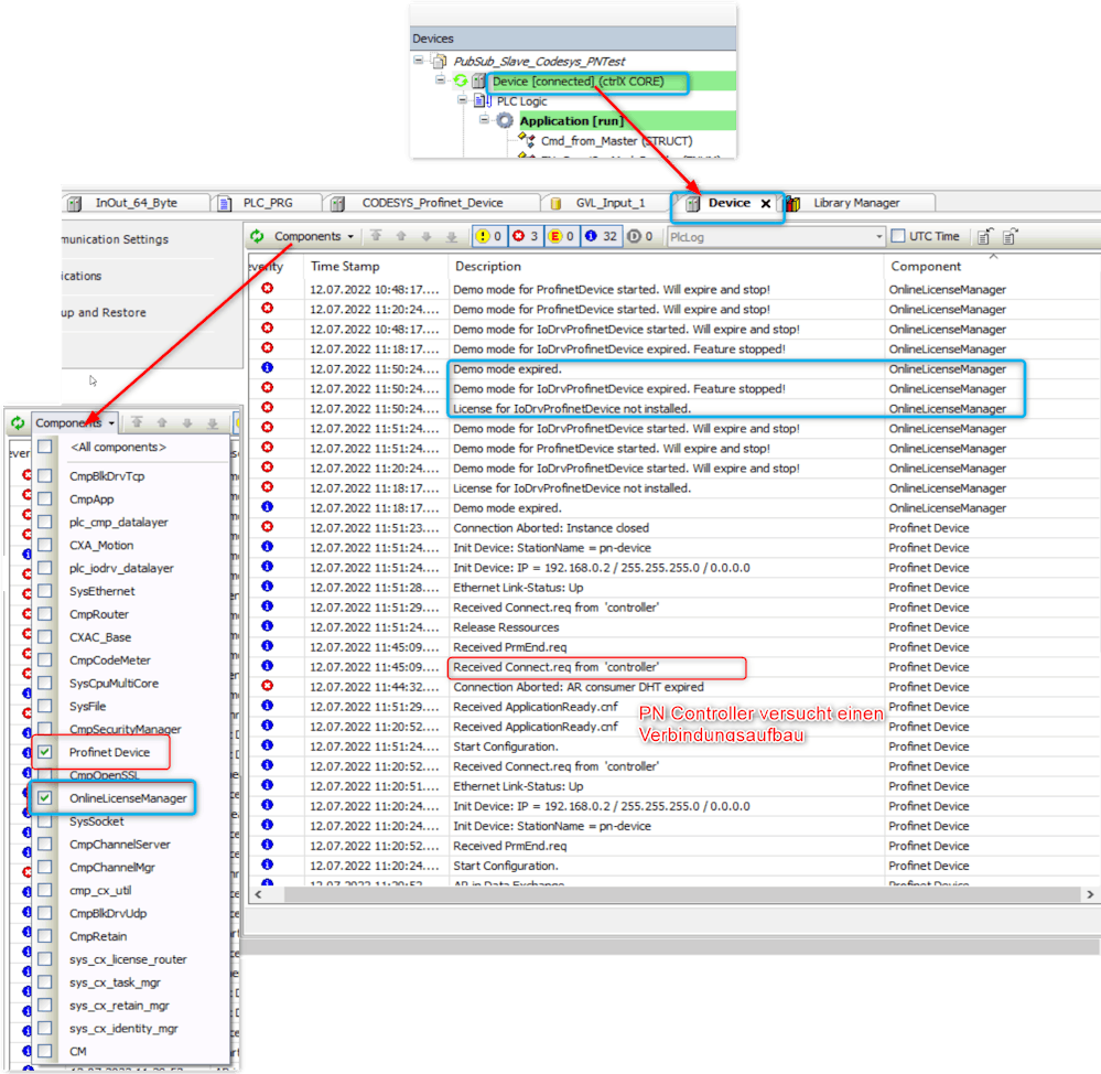

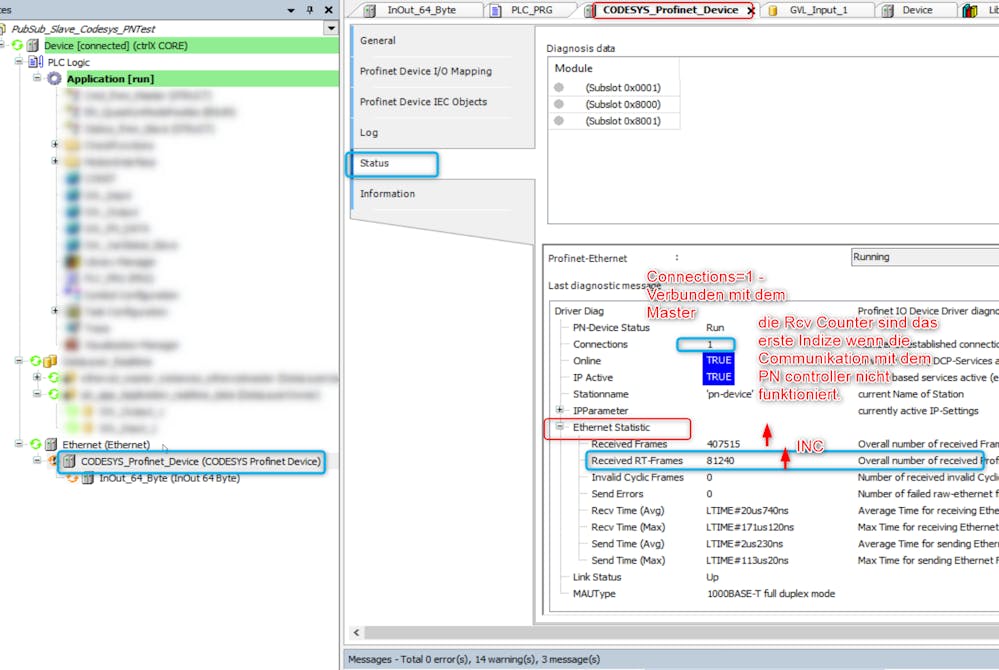

2 useful dialogs to judge the PN communication state:
-> on the PN-Device view the Ethernet state - Counter for Receive-frames rising? if so - OK.
-> Device / PLCLogger : does the PN Controller send comm requests?
