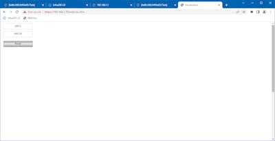

WebVisu started on port 80, normal hmi not avaiable
For some reason the codesys webvisu suddenly started on port 80, thus making the normal HMI inaccessible.
Anyway to get around this?ย  Or do i need to reflash the core?
