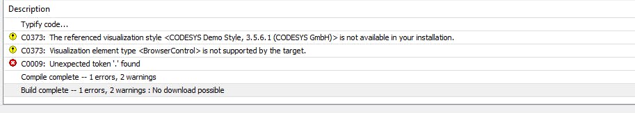

I tried to use the codesys web browser in webvisu project but there is compile error that says "Visualization element type <BrowserControl> is not supported by the target.
Is that correct? or have I just got something else wrong? I'm trying to display a WebIQ project from inside webvisu. There are two projects that need to be combined.

error is 'unexpected token "." found' BrowserElement is just a warning. and should not avoid download. Can you fix that token first?

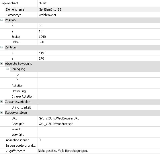

Because, I use WebBrowser inside a WebVisu to have access on ctrlX without issues (except certificate issues because of no https:// if you use a Windows-machine)
Just control tags are used
