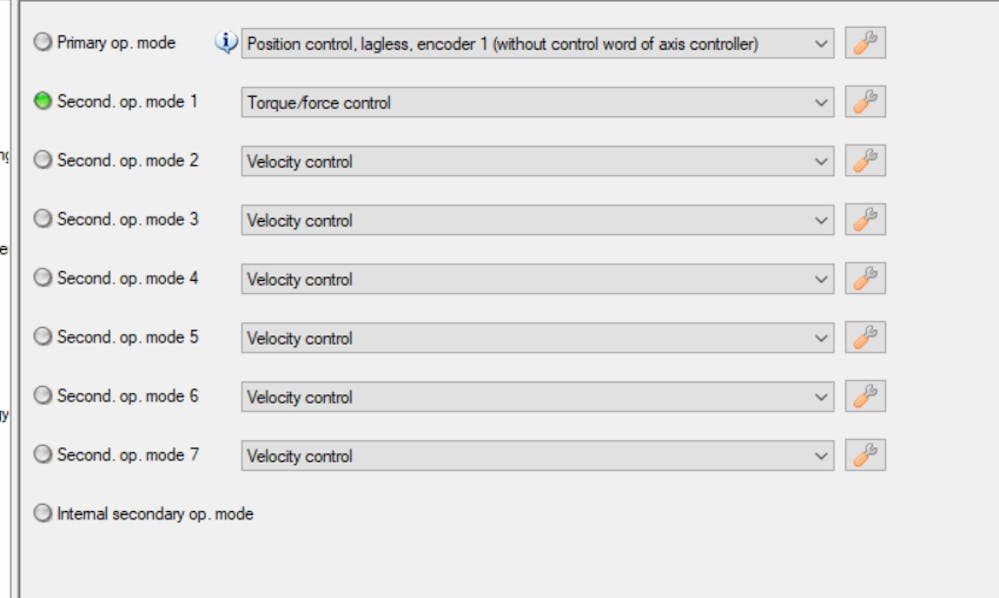

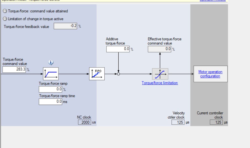

If I change to smc_torque in the "SMC_SetControllerMode" function block the cmd of the position, velocity and torque changes constantly and I cannot find a way to change it,
It seems that the force/control mode is selected in the Drive but then the CMD of the parameters are updated
I only have one drive with softmotion and I changed the mapping of the variables but the problem still persists,
