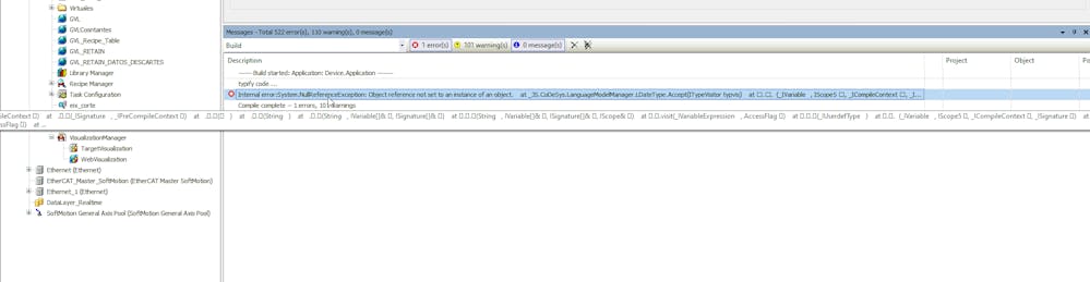

Does anyone know what type of error is this?
We are using a ctrlX Core Virtual and the Softmotion and Codesys WebVisu packages but we do not have any idea why this error appears when we build the code,
Many thanks,
Many thanks,
ctrlX CORE virtual will support the licensing of CODESYS Add-Ons from ctrlX Store in version 01V18.
