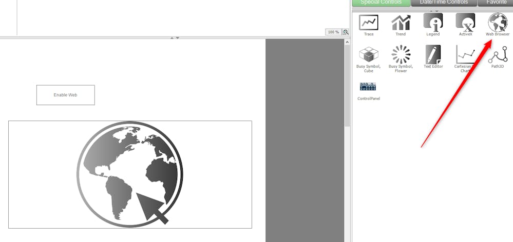

A customer is trying to access to the WebServer of the Core through Codesys WebVisu using the object “Web Browser”:
In this object we just type the string of the URL which is the IP of the Core and a Boolean variable that enables the web visualization,

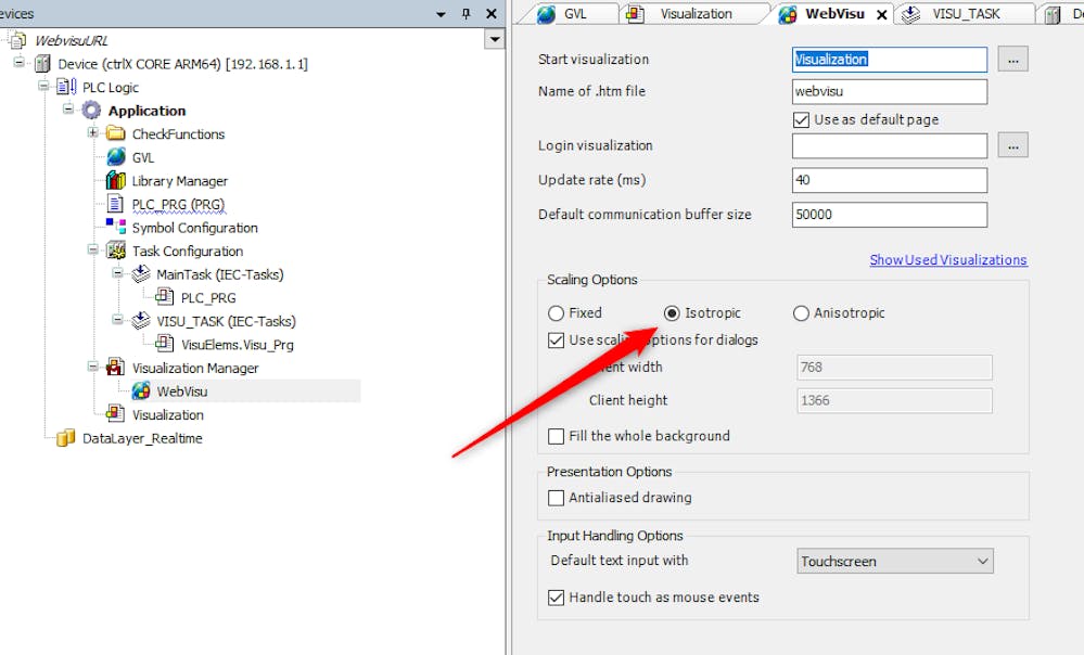

The customer wants to have an Isotropic scaling configuration as it would build some machines with different HMI screens so the content needs to adapt depending on the hardware,

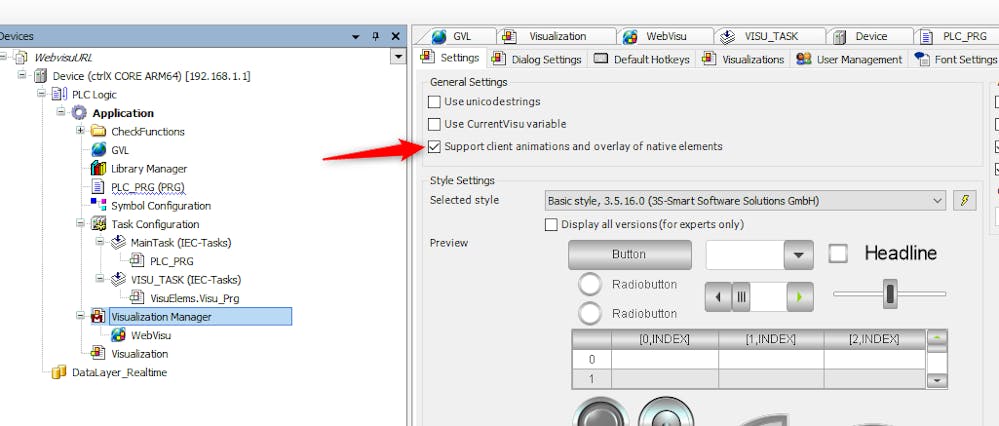

Furthermore the option from below needs to be activated as they have screens with animations:

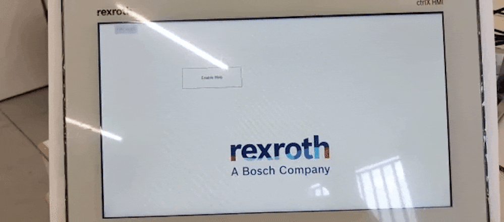

I attach a video of the outcome but it seems that when I enable the URL and when I am trying to use the keyboard of the Android of the WR21 I lose the connection and I cannot recover it,
If I change the scaling to “fixed” it works but the customer wants to use the automatic scaling and also if I deactivate the “Support client animations” works but then the animations of the screen do not work anymore,

Best reply by CODESYS
Codesys has fixed such a bug in the Visu Add-on version 4.4.0.0. ("Keyboard goes away quickly")
Jira VIS-1882 - WebVisu Smartphone: When "support client animation" is activated, the smartphone keyboard is only displayed for a few seconds
Basically concludes:
Whether the URL works in the browser element depends on the page, whether it can be displayed in an iFrame.
