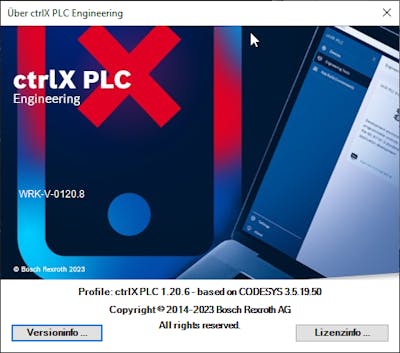

Project attached ctrlX PLC Engineering version 1.20.6, WORKS version 1.20.8
