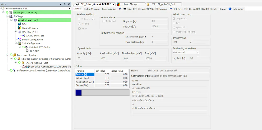

Hi everyone,

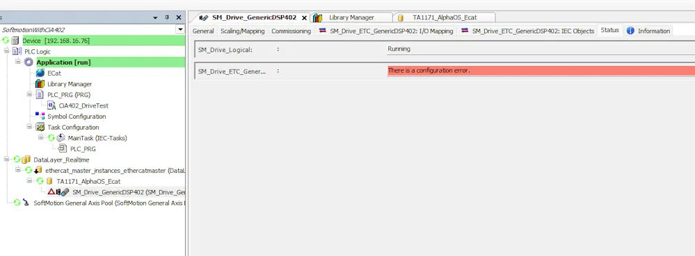

we are tring to control a CoE drive with SoftMotion library, but we keep getting an error on the softmotion axis in the device three.
Axis General
Configuration fault

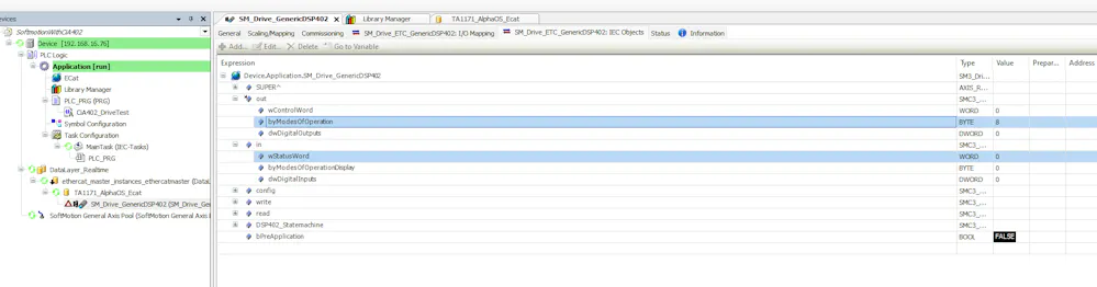

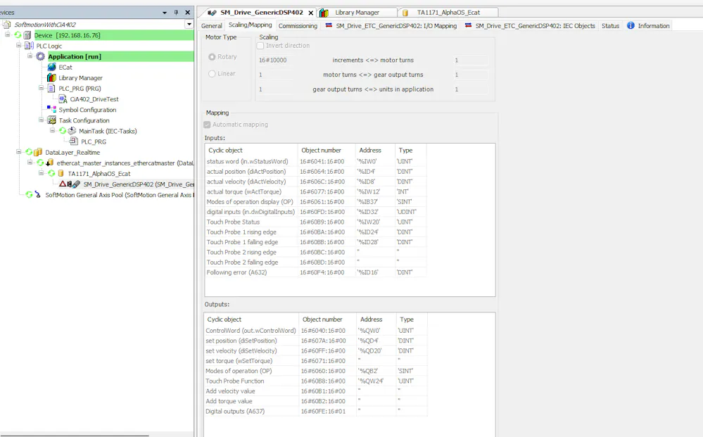

The EtherCat configuration seems ok (and in OP)ย  but if I check in the axis istance i can see a mismatch between the actual values in the EtherCat and in the Axis istance (ex. statusword and mode of operation).

Best reply by _Beppo
Rookie mistake,
Found out I needed to reference anything in a 2ms "Motion" Task.
