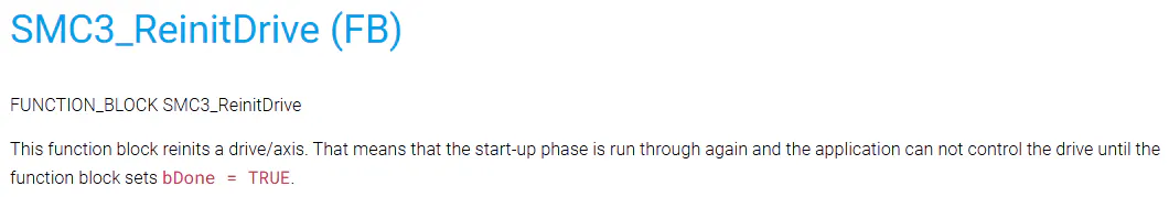

According to the Softmotion manual, this fault cannot be reset by MC_Reset, but can be handled by using the SMC3_ReInitDrive.
Unfortunately this command has not been implemented as part of the softmotion package for ctrlX.
Any suggestion how to reset a possible Ethercat comm issue without restarting the PLC app?
