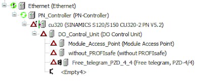

We are using the Codesys Profinet Master to establish a Profinet Connection to a Siemens SINAMICs S120 Converter. (The gsdml file can be found here:PROFINET GSDML - SINAMICS S120 )
Scanning for the connected devices seems to work.

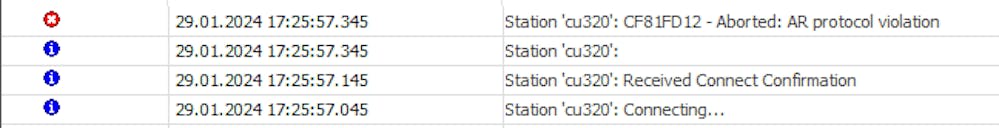

But as soon as we start the execution of the profinet the SINAMICS shows an error: " Error code CF81FD12 - Aborted: AR protocol violation"
We have not been able to find the reason for this error.
