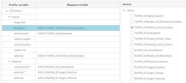

Please tell me how to operate Velocity mode and add SoftMotion in "CoE".
“CoE” was set with reference to "https://developer.community.boschrexroth.com/t5/ctrlX-MOTION/Third-party-EtherCat-servo-drives-CiA402-profile-and-ctrlX/m-p/57261"
In “ctrlX-CORE / Motion / Axes / Commissioning”, Positioning (Position Mode) proceeds normally.
But Velocity doesn't work.
Alarms "091F200F : Error in axis command MoveVelocity" and "0C550170 : Operation mode velocity not supported by commanded drive" are triggered.
Ask for help.

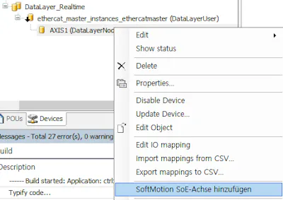

And I installed Softmotion Package from CtrlX PLC Engineering.
Softmotion is not added in DataLayer.
Alarm occurs. Alarm content “Value does not fail within the expected range.”
Best reply by PLC2030
The CODESYS Softmotion Adaption for CtrlX CORE supports EtherCAT SoE, but not CoE so far. A description how to configure CODESYS Softmotion on ctrlX CORE to operate an IndraDrive or an ctrlX DRIVE via EtherCAT SoE with ctrlX CORE is here.
