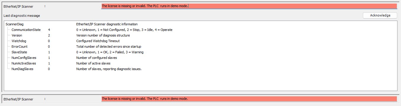

I'm currently using Ethernet/IP scanner with Codesys add on.

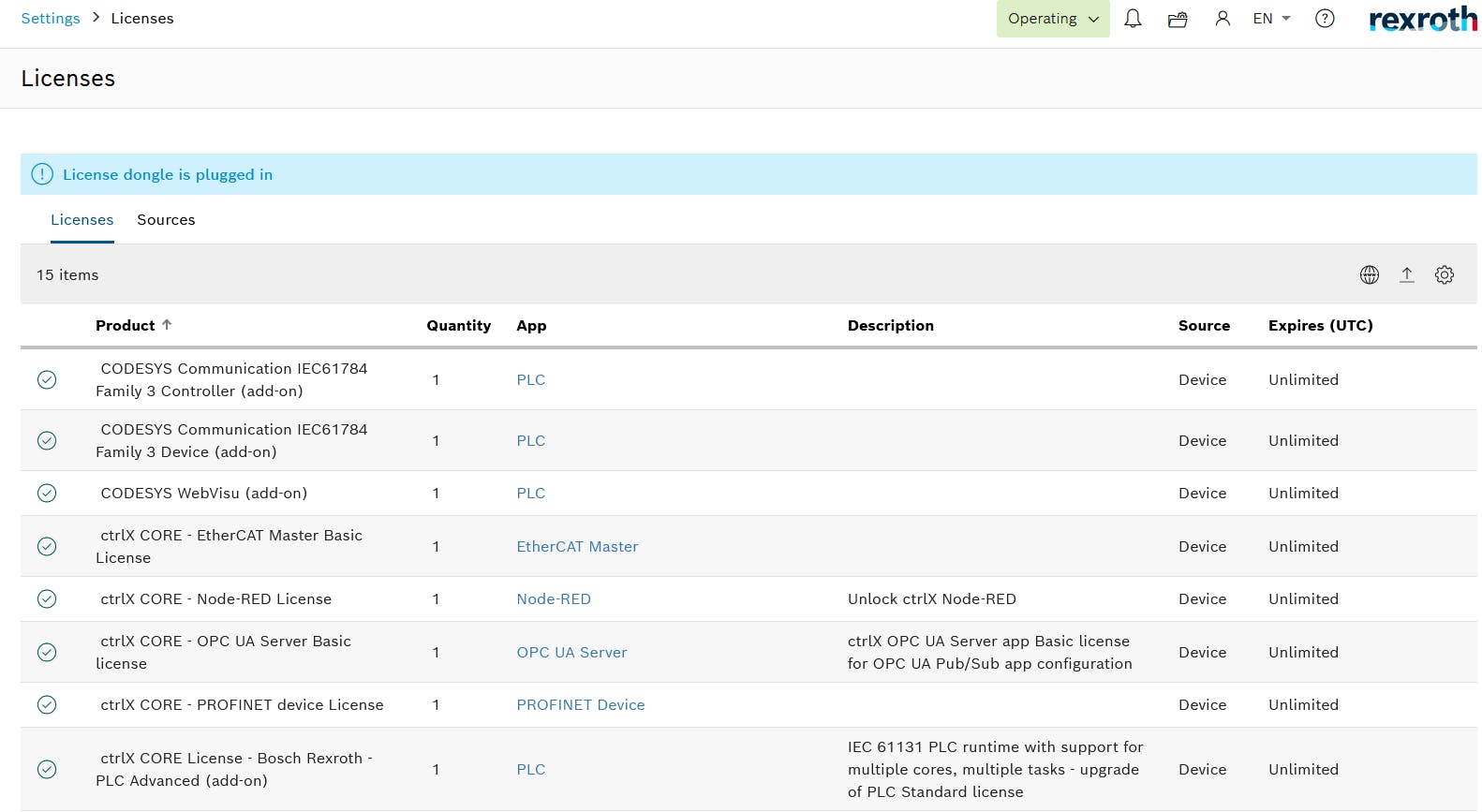

The license Codesys Fieldbus communication IEC 61784 family controller is well present on CtrlX licenses. But in PLC engineering, the Ethernet interface shows that I'm still in demo mode as "The license is missing or invalid. The PLC runs in demo mode.".
The communication is time limited (30 minutes).
Any ideas ?
