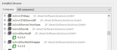

When I add the Codesys Ethernet/Ip Scanner I can't download the project to the PLC, it pops up the following errors:
It seems that it is a library error, I have tried with the 3.5.17.0 IoDrvEthernetIpAdapter library version but it returns even more errors and the PLC project is empty, I have only added the Ethernet/Ip Scanner,
Does anyone know what should I do?
Thanks for the help,
Best reply by PLC2030
It seems your project uses an older version of the Ethernet/IP libraries. A check of the library versions with RM 22.03 (01V14) should have the following result:
Did you install the Ethernet/IP package 4.2.0.0. from the ctrlX Collaboration Room?
If you already have Ethernet/IP package 4.2.0.0, please check whether the library in your project is set to an older version.
