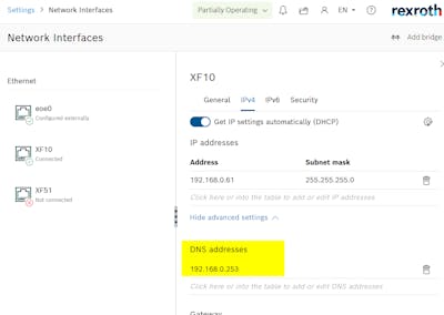

Manually configure a DNS server, the IP adress should not be the same as the ctrlX or the engineering PC

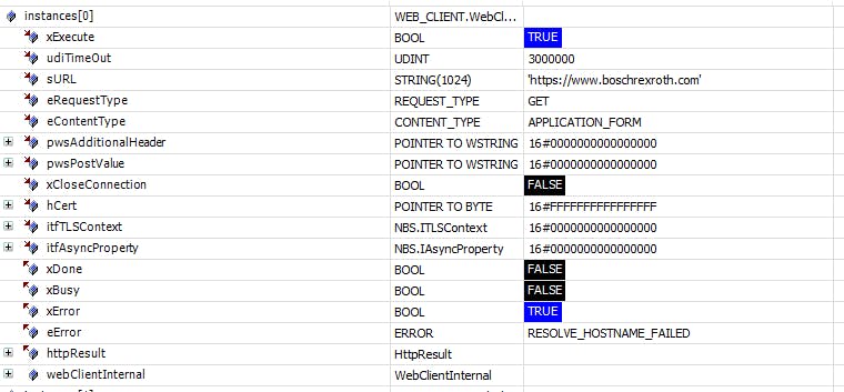

Send out an request through the WebClient function block, e.g. https://www.boschrexroth.com/
The function block gets stuck for 10 and then generates an error and shows RESOLVE_HOSTNAME_FAILED.

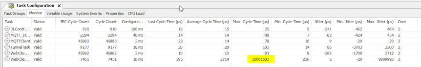

For the exampe below the task shows a max cycle time of 10001583us ~= 10s

The timeout of the request is not determined by the timeout of the functionblock (above the timout is set to 3s, the functionblock was blocked for 10s)
The functionblock stops its task from running, stopping all logic in the task from executing
