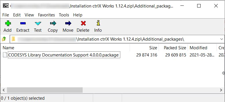

To use it an additional function package called "CODESYS Library Documentation Support 4.0.0.0.package" has to be installed. This is part of the ctrlX WORKS installation package but is not automatically installed:
