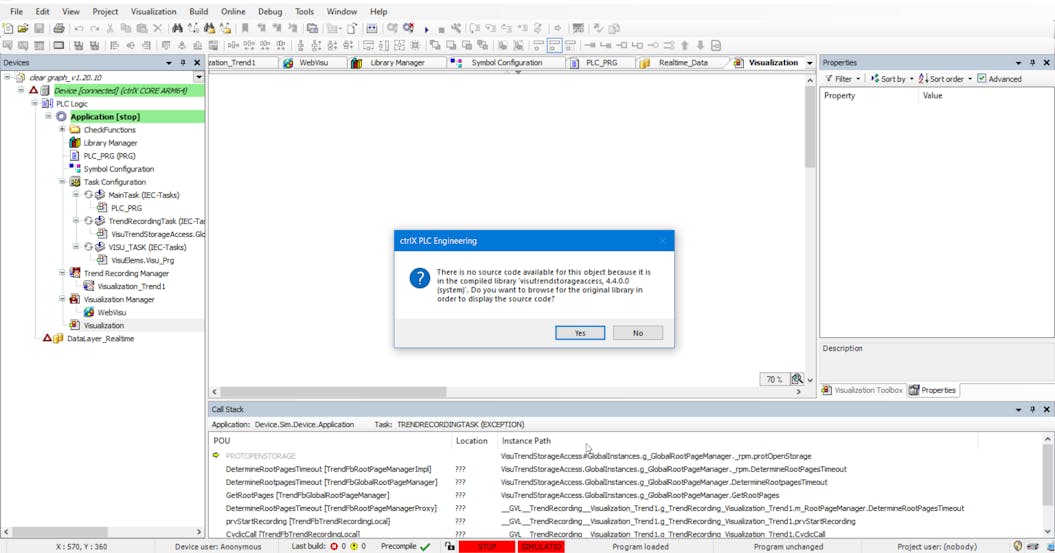

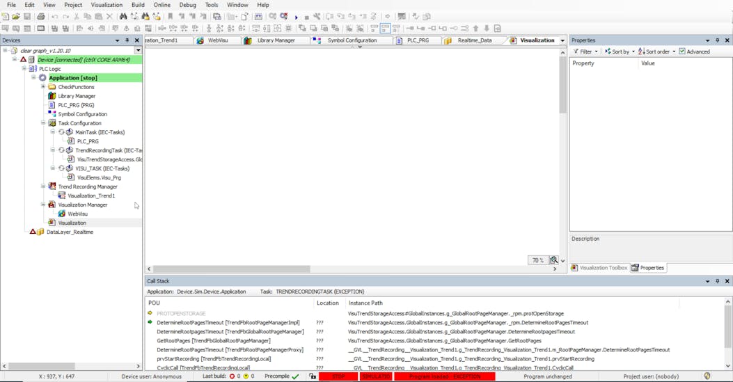

Exception of CODESYS visu after update to 1.20.10
I have updated the ctrlX works from v1.18 to v1.20.10, the library visutrendstorageaccess, 4.4.0.0 is not recognized.

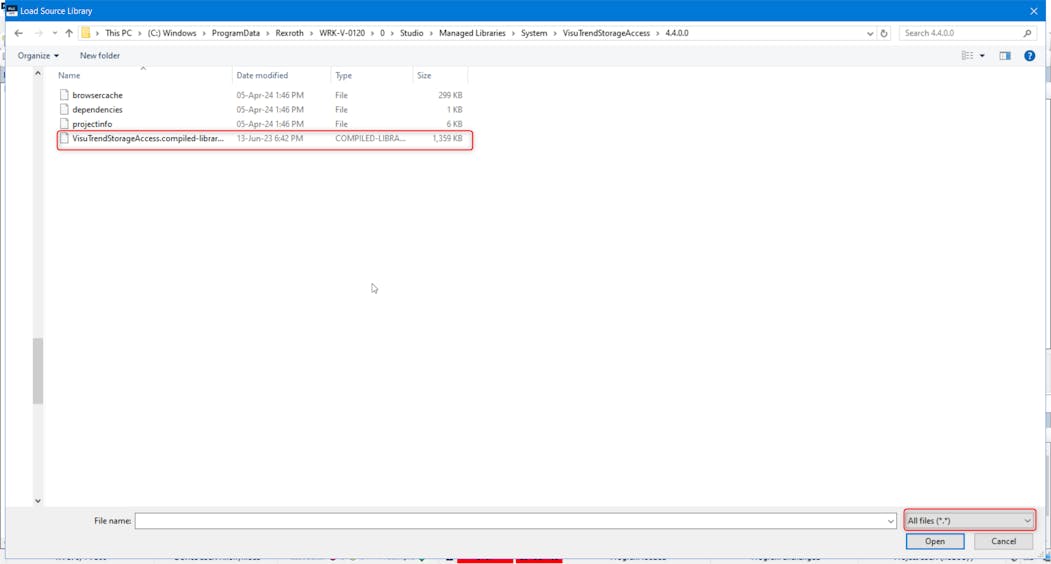

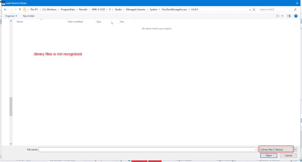

When i search for the library source:
When i when i open the source library file:
When i open the library source file:ย
Anyone had this issue? I have attached my PLC project.
Best reply by Open
Thank you for your tips. The graph object does not work in simulation mode, when logging in to a real ctrlX it worked.
