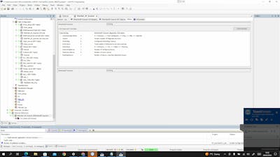

When configured in the project and downloaded, the project run's correctly, however everything the system is power cycled the vision system is no longer running.

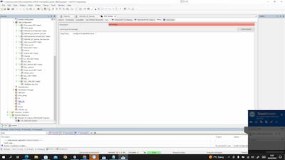

To resolve the issue, the vision system is physically disconnected from the CORE IO and reconnected and after some moments the whole system is healthy again.
Info:
Ethernet-IP-Scanner V 4.2.0.0
image1: shows the vision system not running after power cycle

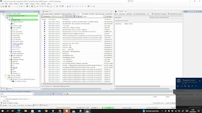

Image2: shows the state of the E/IP Scanner while vision system not running
Image3: the PLC log after vision system disconnected and reconnected pyhsically

Best reply by georkueh
we will provide the current Ethernet IP Add-on 4.4.1.0 the next days. Please check the behavior with this version.
kind regards
