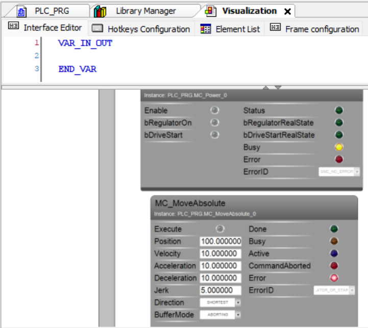

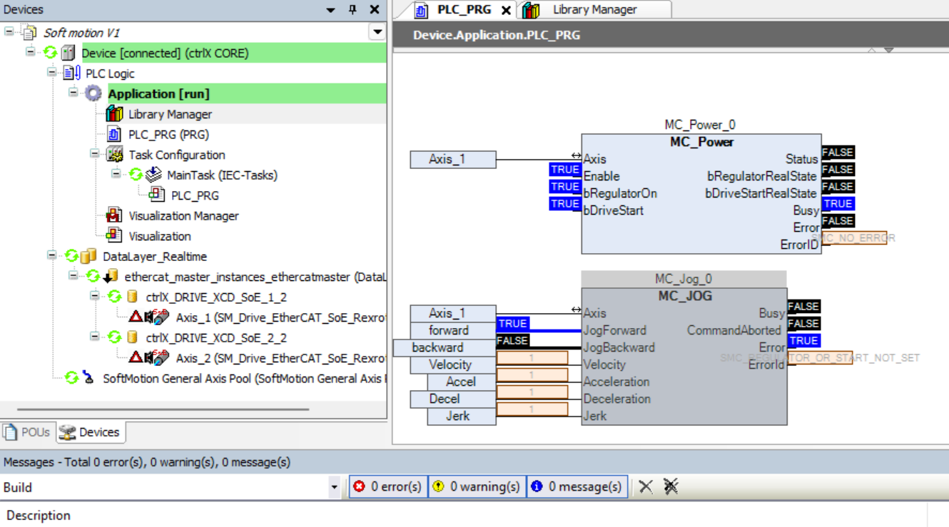

While trying to create a simple program to jog an axis using CODESYS softmotion stumbled acros a error (SMC_ERORR.SMC_REGULATOR_OR_START_NOT_SET; represents raw value 20). According to the internet this means:Â Controller enable not done or brake applied. What can i do to solve this problem? The inverter and the motors work when enabling them by hand using the motion app on the ctrlX CORE.
CtrlX Drive inverter: W2323
Motor: MS2N04
Softmotion version: 4.12
Softmotion adaption version: 1.16
PLC app version: 1.16
