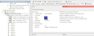

I am working on a function test, which use a X3 through the service channel to change some parameters of Indradrive that the cyclic channel isn’t able to, through the Codesys Profinet for a customer. I used CtrlX work 1.20.11 and Profinet Controller 4.3.1.0 with PLC App 1.20.7. after having the profinet controller added I could scan the bus and found the Indradrive and added into the project. However when login and run an empty project the bus showed red and a message of “Controller’s IP address is already used by another device” showed in the status of the profinet controller. I tried to change the IP address of the drive and it didn’t work. Also changed the version of Codesys Profinet and the version of CtrlX works and apps. I always got the same error message. Cycled the power it still didn’t work. I checked the forum and none had the exact issue. It should be a simple process, but it ended up more complicated. Can someone help me on that?

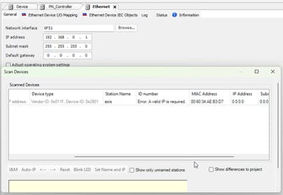

after having the profinet scanned there still showed an error
what need to do is selecting the scanned devide then click on the function button Auto-IP below. then it works. I did click the Auto-IP button without selecting the scanned device or another way around, and that was why I didn't get it work. now I know what steps I did miss. after getting it worked we have another issue.
