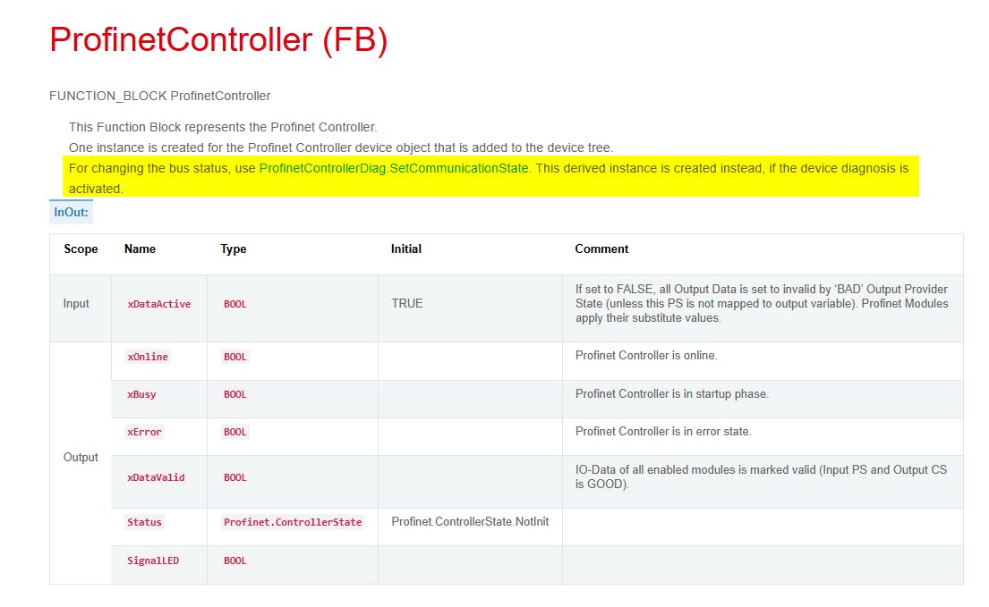

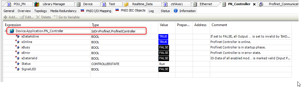

How can be the diagnosis of the Codesys Profinet Controller be activated?
By default, when adding a PN Controller, it is linked to function block ProfinetController, but to change the status I would need the ProfinetControllerDiag:
Thank you,
