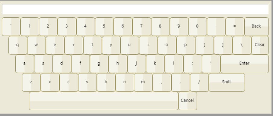

My customer would like to change the size of the WebVisu data entry Keypad. Various codesys forum posts say that this is possible by making a copy of the VisuDialogs.library and making some edits. Is this possible with ctrlX PLC Engineering?
I could find a compiled library at: C:\ProgramData\Rexroth\WRK-V-0120\1\Studio\Managed Libraries\System\VisuDialogs\4.3.0.0\VisuDialogs.compiled-library-v3
However, I can't see how to copy/edit/save this.
Best reply by bostroemc
The source code for VisuDialogs is available from CODESYS here.  I've attached my own modified library, which includes a keyboard more suitable for English (i.e. without  ä, ö, ü, ß, etc.)  This is intended as sample code only.
