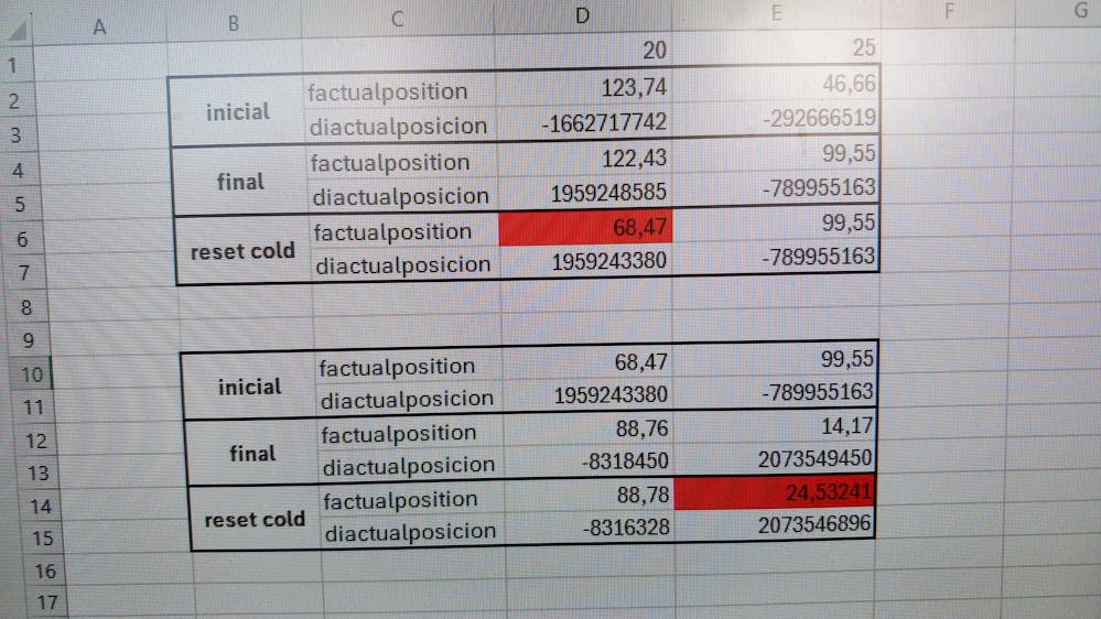

It seems that some axes that are configured as modulo value lose their position, we did some tests and here I attach a table,
It appears that when the actual position of the drive (S-0-0051) is positive then the position of the Softmotion is not the same when we switch off/ switch on
